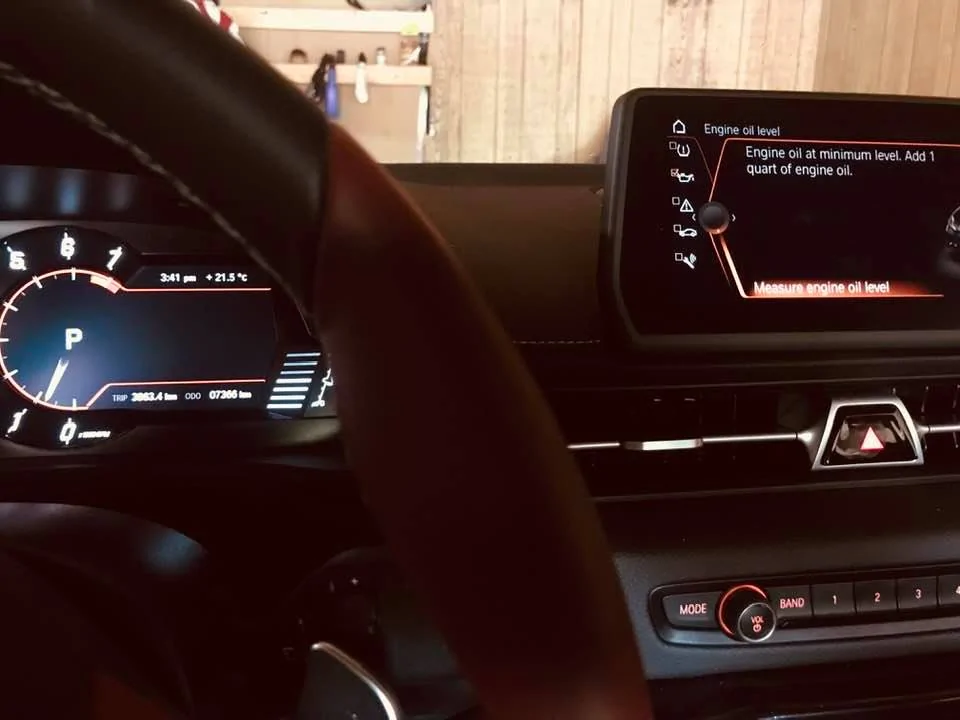

Took my 2021 3.0 in yesterday 05/31/2021 for this issue. My daily car. Did my first oil change at 1,200 miles. Got this "minimal oil level" notification at around 3,550 miles. Car was at the dealership for about 6 hours before I got call from my service advisor telling me that they have to get in contact with Toyota Corporate about them sending out a tech for repair or possible engine replacement.

Well, I thought I was in the clear for the oil warning, but today was the day at 4,580 miles. (7,366kms). I went to the dealer so it could be documented. He only added 3/4 of a quart instead of a full one, and the the oil indicator went to full again. I don't think the dipstick is very accurate. Build date 03/20.

Could this issue be a faulty sensor? Hard to tell without a dipstick if the engine oil is low. Spoke with a former BMW master tech who stated these sensors being faulty is really common.
