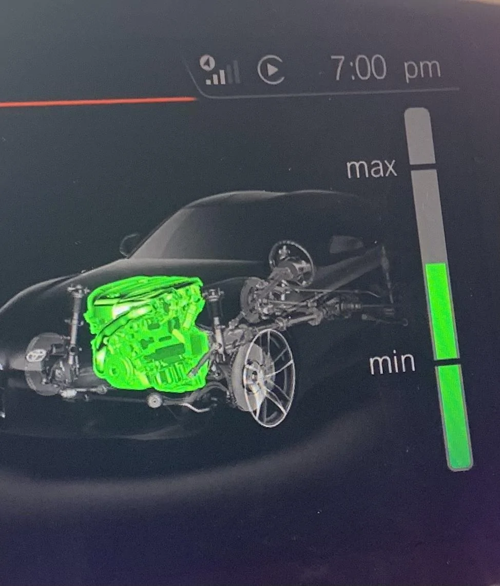

I’m at 2,000 miles. Not sure if this is where I should be or if it’s down a little?
The indicator isn’t always accurate, in the sense that it can fluctuate before hitting the top up warning. Mine showed 1/2, then went back up to 3/4! I’d just monitor and check the oil level again.
Wouldn’t worry too much till you get the low oil warning.

Is your car sitting at a slight incline or decline where it’s parked? BMW’s use a stupidly sensitive oil level sensor that if your car is on the slightest incline/decline it will trigger the light. Get it on a level ground, and test again.
Ground is level...I check the oil in the same place at the foot of my driveway every time...
I do wish it was an incline/decline issue or even a sensor issue...
Just don't think that's gonna be the case..we'll see what Toyota has to say though...

My brothers MKV had the same issue….turned out to be the garage floor was at a slight angle. He also switched to Motul 300V….not sure if that may have helped. No more low oil level indicator.

So if the sensor is misreading and oil is added, isn't to much oil just as bad as low oil?

Correct. Excessive oil fill up is no bueno. I’d bet my dollar your oil isn’t actually low, but more so related to false oil level sensor output.
