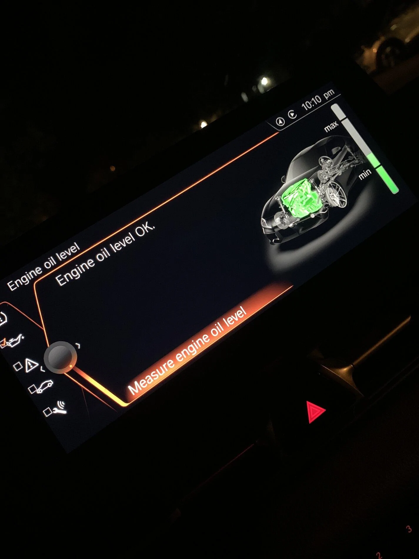

So I added a quart of oil at like 2300 miles, and I'm at almost 3500 now and this is what I have:
So I expect it to have a minimum warning within 200 miles, but I'm not sure if this is within spec or not for them to just say "oh well, you're out of luck."
I'm supposed to take it back to toyota at like 3550 or something though.
