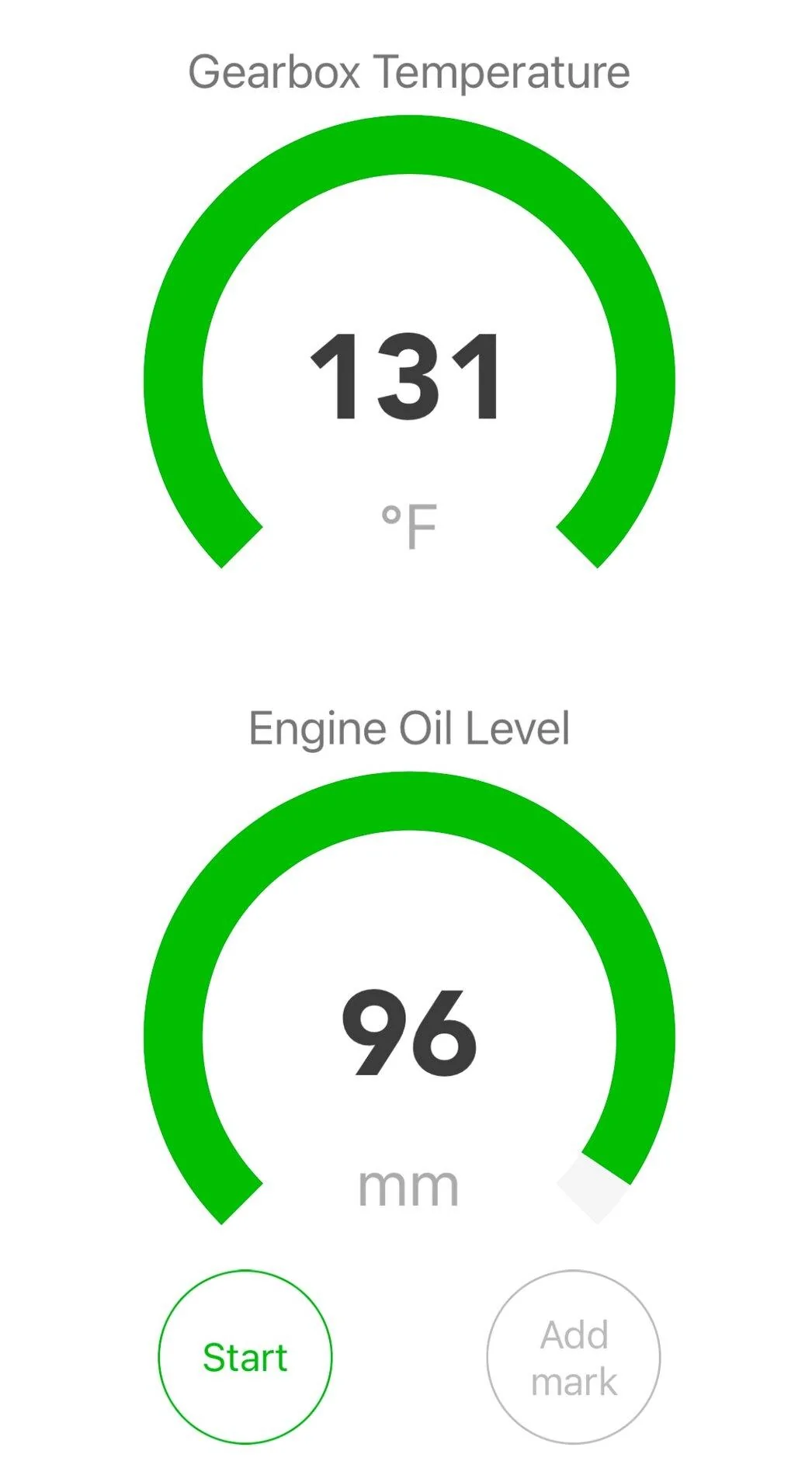

The oil level sensor is definitely sensitive to car being plumb. Another factor is oil temperature. When I check cold its down 10mm.
I just changed the oil and the iDrive system shows at max line. But when I check with my EcuTek app it’s only at 96mm not 100mm.
