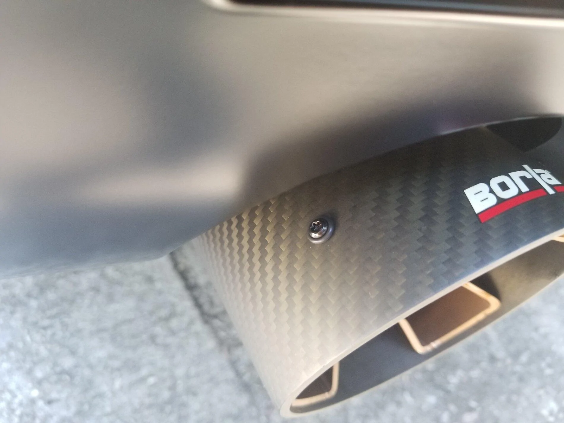

Hopefully Toyota can get it figured out...regardless of the issue...
Steve
Dealer ask that I bring my car back to them today...they are trying to do a oil consumption test...
They taped up the oil cap and the wiring to the ecu...not really sure what this is for but apparently Toyota corp is requiring these steps..
Another thing I have noticed is my exhaust tips are covered in black soot...
To me that's a rich condition?
Not sure if burnt oil would cause this?
Another thing not making sense is I have a borla with carbon tips..the original borla tips turned brown almost burnt looking...borla replaced those under warranty n now the new tips are now exactly the same as the original set...
Could this be caused by burning oil?
No other people I know of with a borla exhaust has had this issue...
They also asked that I don't drive in sport mode and to not wash the exhaust tips..this is for the next 1000-1200 miles...
We'll see
Steve
Yea man that doesn't sound right. I have a bit of exhaust soot on my exhaust tips but I also haven't cleaned them in probably 2000 miles. The soot on my exhaust tips is dry, like dusty, not oily or watery feeling. If your tips are oily or watery and it's bad enough to ruin exhaust tips, somethings wrong!

Yes and no. What he's describing sounds as if it's so bad it's tarnishing his exhaust tips. He's had to replace the actual tips because of it. Usually exhaust deposits can just be cleaned off with some elbow grease or a polisher, but if it's actually etching or tarnishing the tips themselves then that's something else... At least I've never seen this happen.
Not a great pic but you can see how the carbon in the tips have turned brown..also the copper color metal use to be black..
This pic is the original Borla...
The replacement exhaust looks just as bad if not worse ...
Don't see alot of soot because I keep my car pretty clean..
Steve

So this is after cleaning it?! Have you done any Google searches to see if maybe it's just an issue with those tips? Man if it's tarnishing the tips that's bad.

I thought colors of that type on exhaust tips was an indication of fuel additives in the gas.
-RJM
I mean that could be possible. It's just odd that he said the car also has an excessive amount of exhaust soot on the tips all the time.
