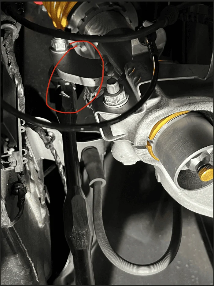

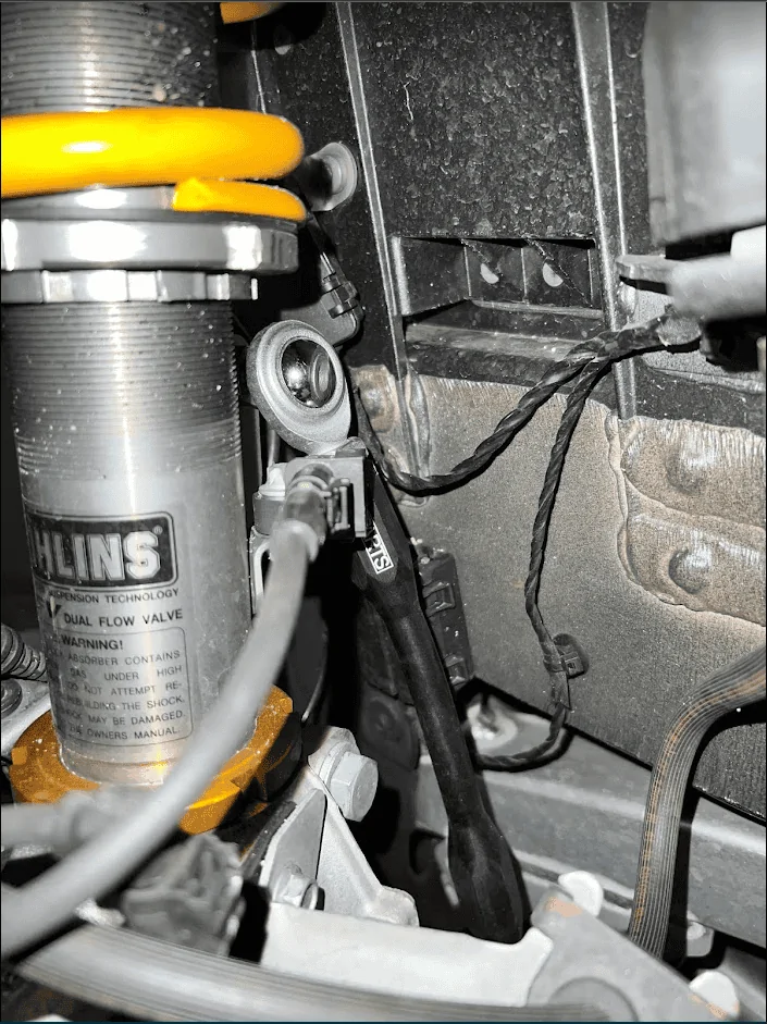

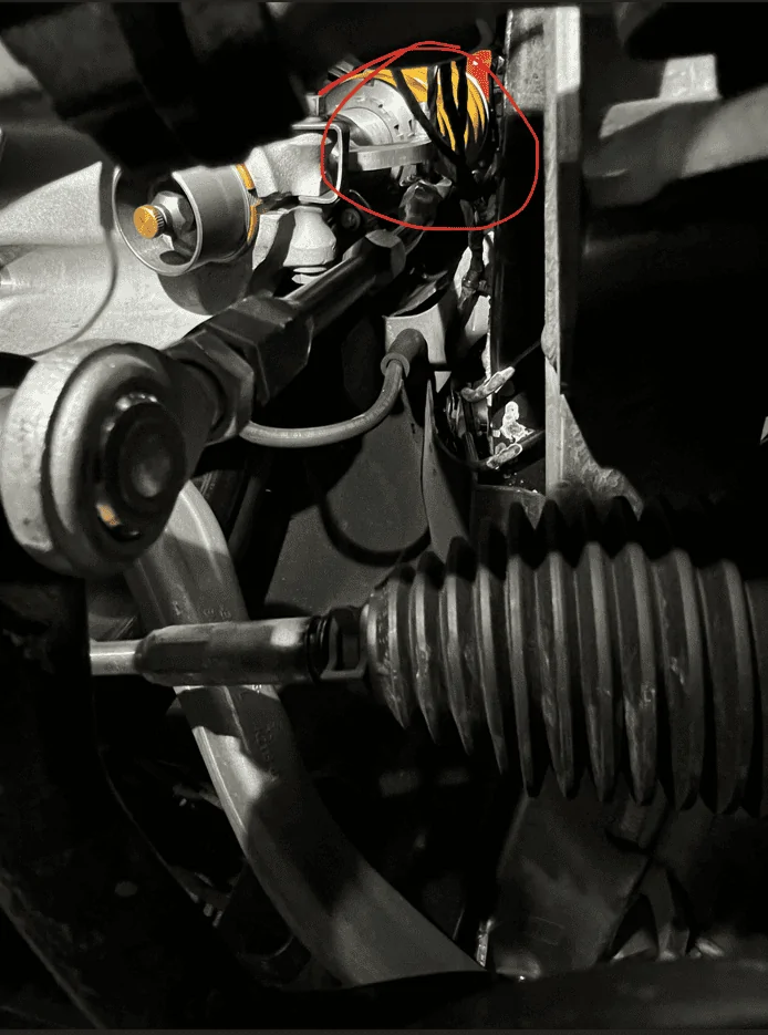

Couple updates since we got the Ohlins installed. The SPL End Links are not compatible with the strut's end link bracket. The bracket is in a "J" shape and is hitting the end link when going full lock. This is also causing the bearing to be out of articulation due to the end link is bent. End links were set to stock length.
We are currently working with SPL to get some custom hardware to clear the bracket.
Right Side:
Left Side:

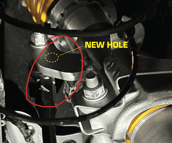

Would you be able to drill a new end link hole about 1-1.25" lower on the Ohlin's tab and use a shorter end link? Just spitballing for a solution. Good luck!

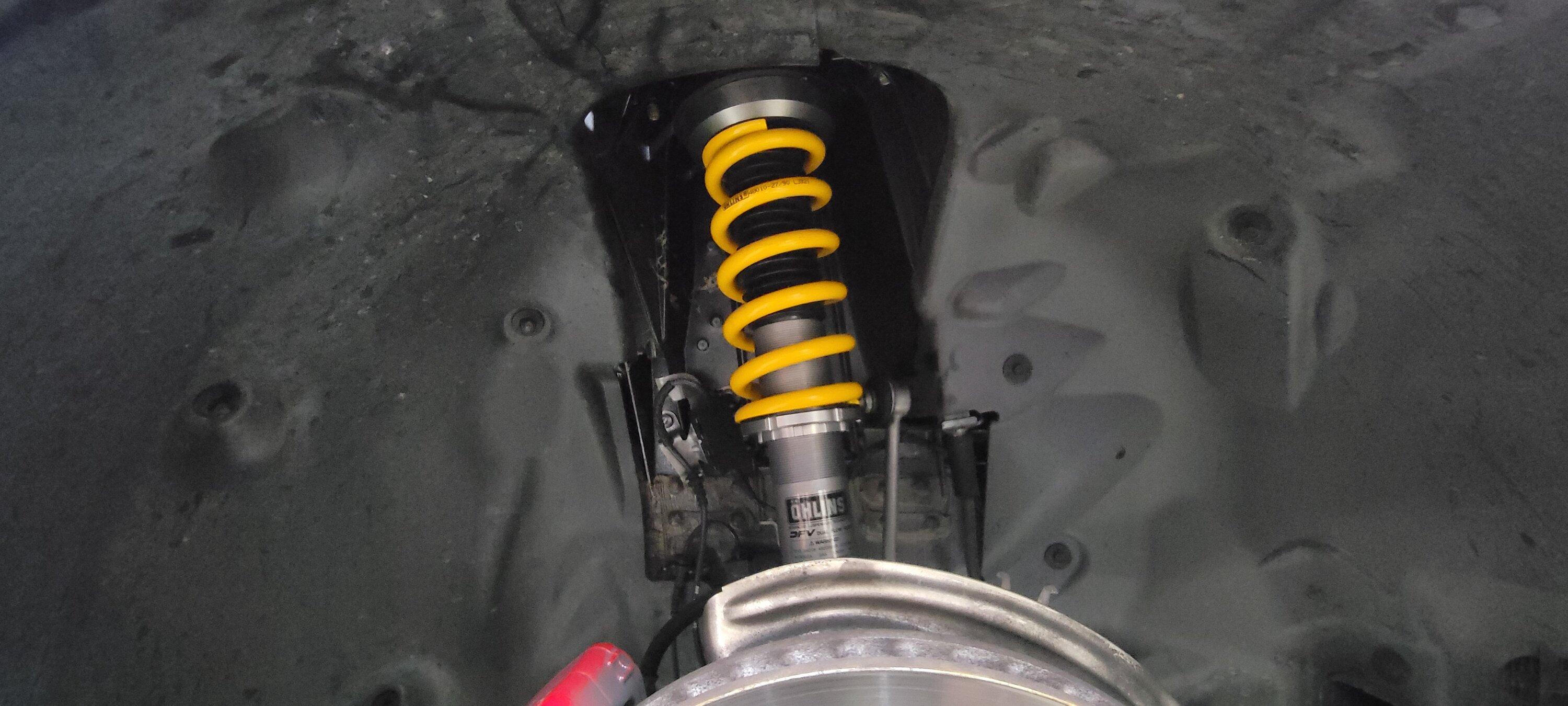

By any chance do you have a picture of the front and rear springs? Trying to determine which one are front and which ones are rear.
Evolution
Sean
Mar 10, 2021
2,250
3,722
21 Supra
Hopefully you can see the part number on the spring.
