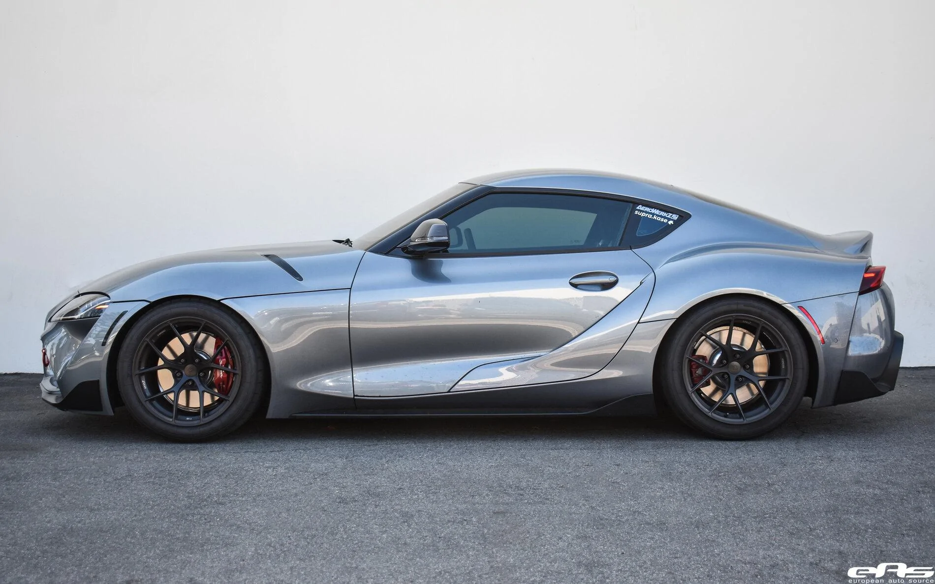

First Impressions:
Car feels great with the Ohlins, really liking how they feel on the street. Can't wait to try these out on the track. They however don't go as low as some of the other other options out there. Mostly designed to stay at near stock ride height if not just a tad lower.
We did run into one issue though where Ohlins supplied the wrong front spring. They gave us a 180mm spring instead of a 200m spring.
Car will be at Supra Sunday in Corona :)

Is this the lowest it will go?
It can go a little lower but it's not recommended. After trying the stock springs we'll upgrade to some swift springs and see how they preform.
