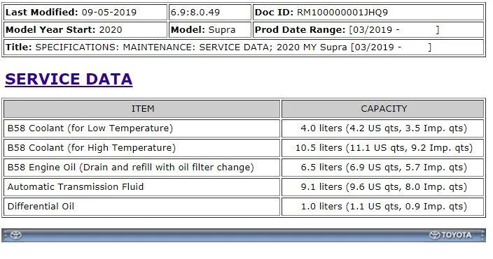

Just going through the workshop manual and although I'm slowly turning it into a nice PDF anyone can download and browse easily, that might take some time. So for now I thought this list of various fluid capacity figures would be a useful thing at have posted here for people to easily find.
TL;DR put 6.5 litres of oil in when you do a change :thumbsup:
