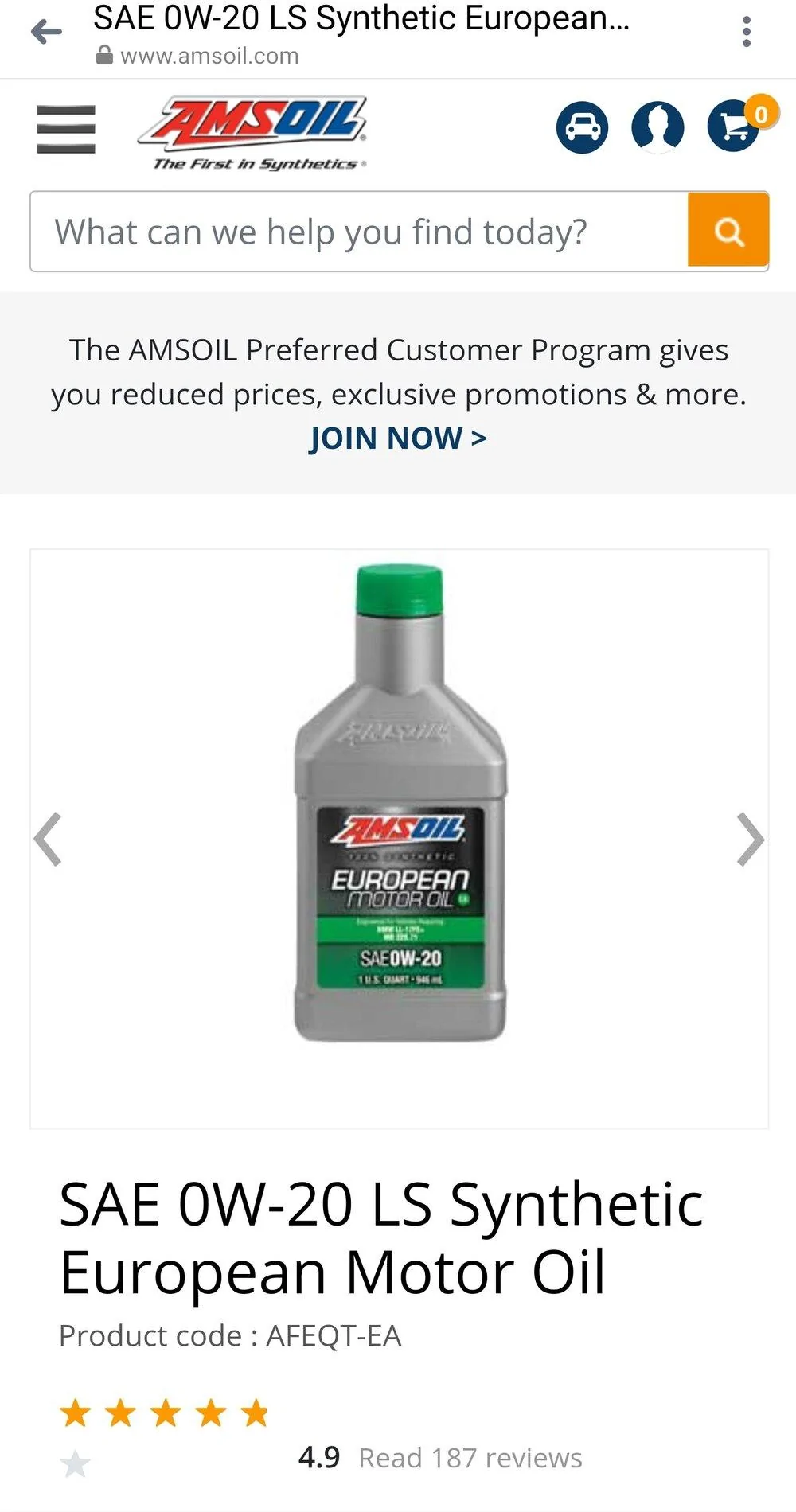

I thought the manual said you could use any of the following blends: 0W20, 5W20, 0W30, 5W30, 0W40, 5W40. I'm currently using Amsoil SAE 5W-30 LS Synthetic European Motor Oil. That has a High-Temperature/High-Shear Viscosity cP value of 3.6, which I believe BMW stated HTHS viscosity to be at least 3.5 cP for the B58. The Amsoil is expensive, but I don't want to skip out on quality when I drive the car reasonably hard from time to time. Running a stage 2 tune, etc.. I'm sure my engine appreciates the extra protection from the additional heat I'm generating. Looks like the oil Amsoil recommends for the Supra is (0W-20 (EZT)) Product code : AFEQT-EA, but I'm concerned the cP is only 2.7, which is targeted more for fuel efficiency than what I would expect to see ran in a high power application.
