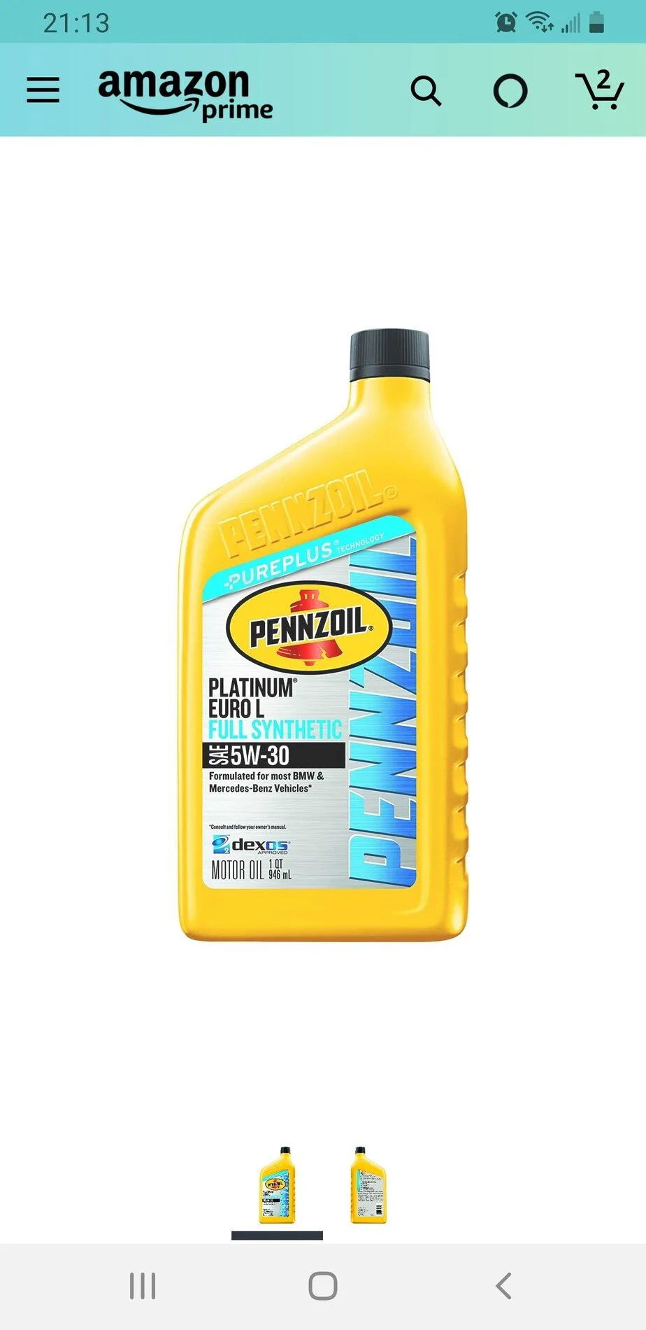

Bought some 5W30 Pennzoil Euro L for my 21 first oil change at 1500 miles. Went to dealer to get the oil changed. Service manager at my dealer is a good friend of mine and told me not to use any other oil than the 0w20 water factory recommended. I was like :crazy:!
He told me that Toyota always asks for engine oil samples when an engine’s blown or malfunctioning. If Toyota (not the dealer) find that you are not using their spec oil you are up to having a hard time getting your warranty applied. I’m in Canada and Owner’s manual specifies that only up to a quarter of any other oil can be use to top off if some is missing...
So I got the oil changed with oem « GR Supra » oil, cause I think I’m better off with an engine under no questions asked warranty with oem oil than having to deal with Toyota Canada if my engine blows up with top of the line « non GR Supra » oil inside...
My friend told me he doesn’t care if I flash the car or put a DP on it, because he has some workarounds for it if somethings happens, but not the case with the oil!
Will put the Pennzoil in my Audi Q5 that’s no longer under warranty then :D
