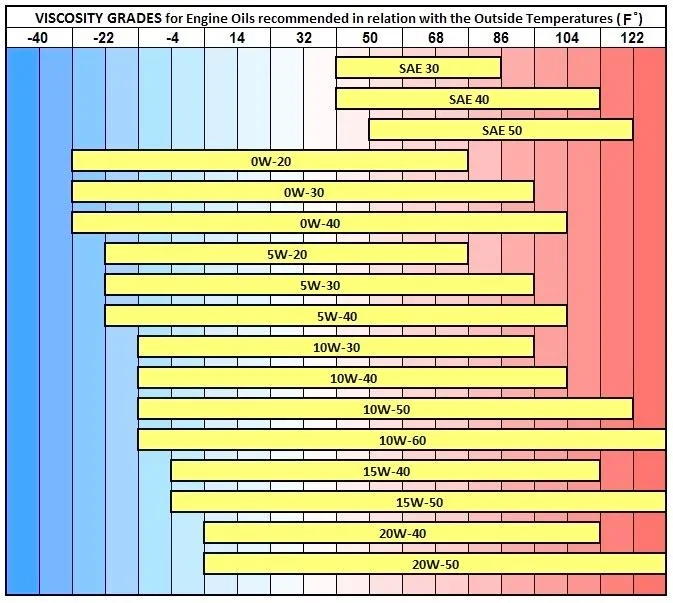

You’re perfectly fine running it. The heavier oil will not damage anything. I would consider an oil weight more aligned to the weather temps in your area.
