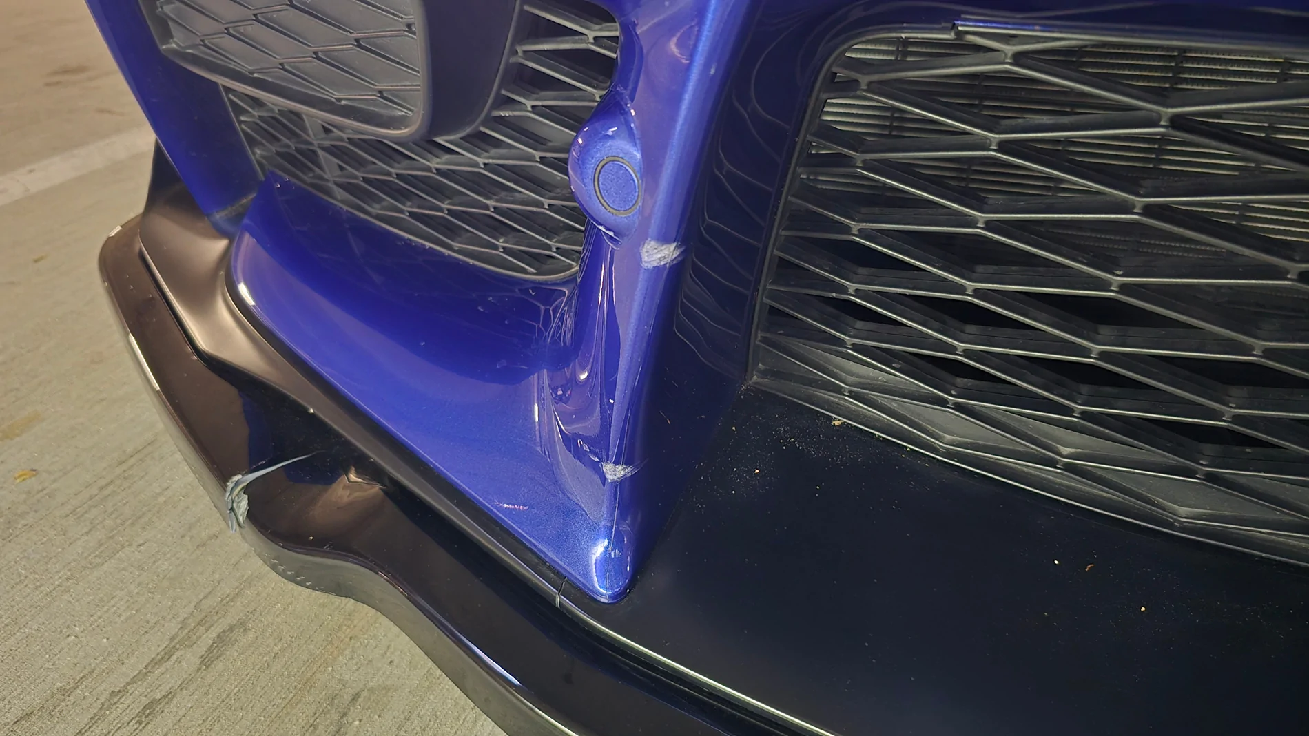

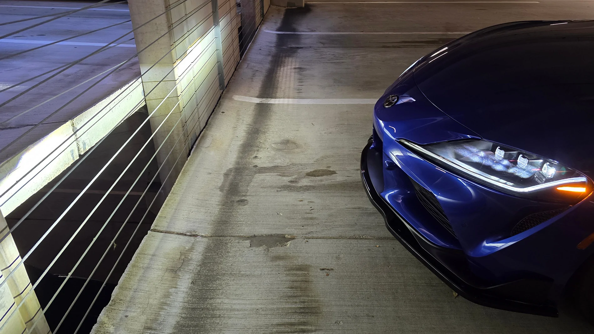

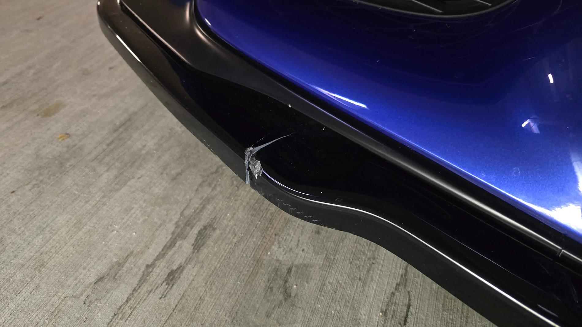

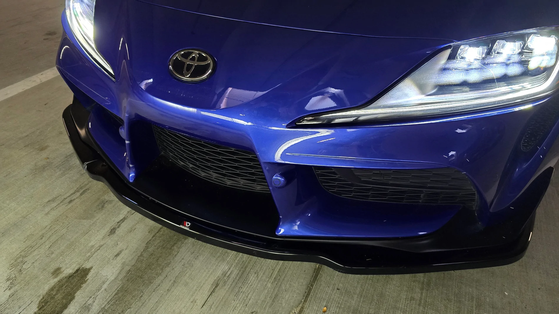

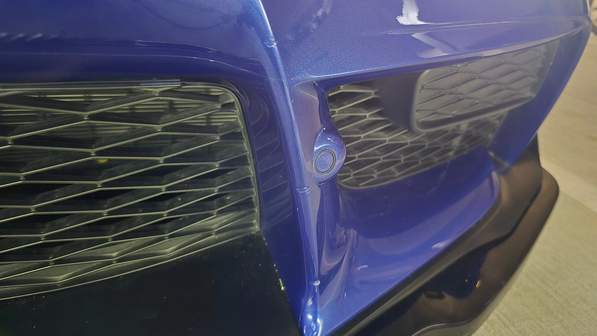

Bumping this thread as this appears to be a issue with my 2025 MT Premium I took delivery of last month. The issue is definitely related to pulling the parking brake with the engine running. Engine off, no issues.
I went ahead and also filed a complain to nhtsa.gov. The first time this happened I applied the brake and stepped out to unload some supplies from the trunk and had to jump back in the vehicle to save it from rolling away.
Now I've watched it disengage probably 25% of the time I park the vehicle.

Happened to me... I feel dumb. I have PPF but not sure how much it protected. Getting a Maxton V1 to replace the lip.
