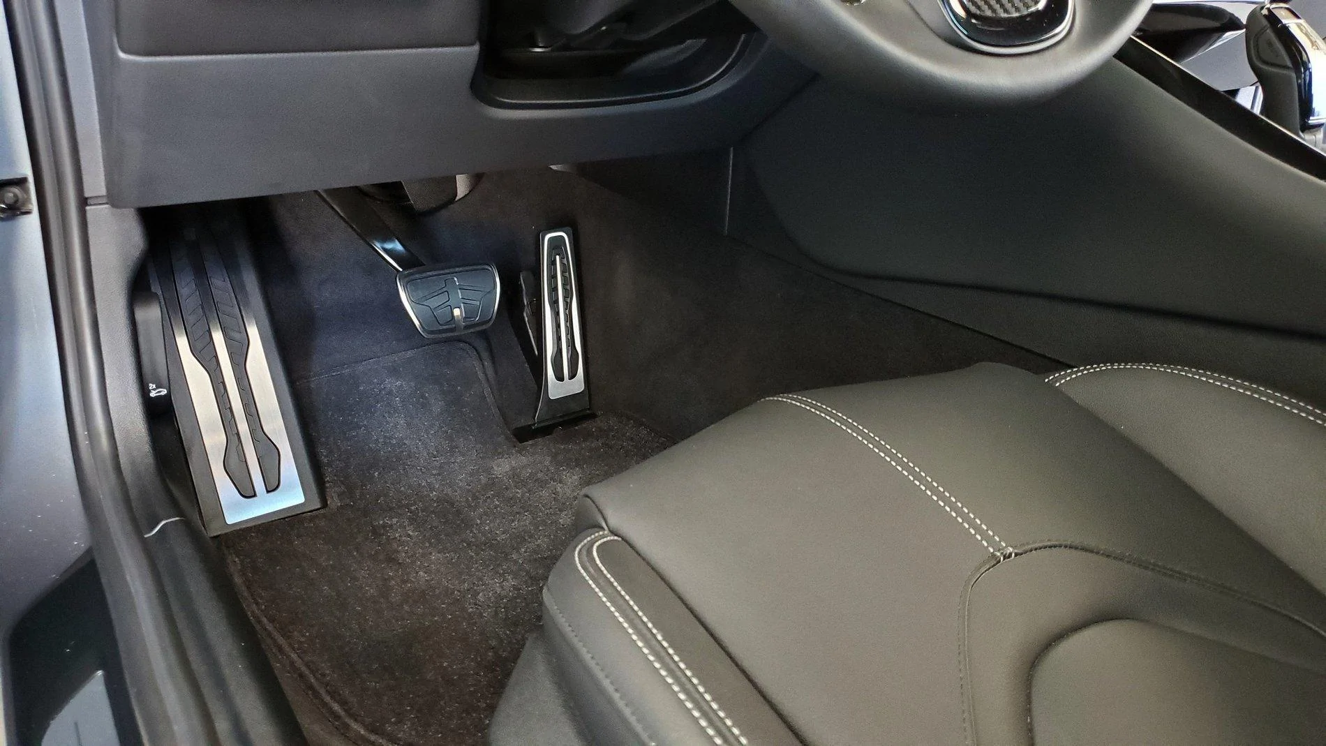

This is my first thread on this beautiful website and I’ve wanted to discuss and ask if anybody have ever faced this problem or even solved this problem
few days ago, I was trying my car out I was about to launch off, my accelerator pedal got stuck, car was acting crazy, I stopped on the right and went under the steering wheel I saw the pedal was stuck deep inside, I have to grab it manually and pull it out to make it into a neutral position
so have anybody faced This problem, nor solvedit?
PS my car is 2020 SupraMk5 with a charge pipe, mid pipe delete, downpipe, and JB4

Are you saying the throttle pedal was stuck all the way down?

This is most commonly not pedal related and issues are from floor mats sliding underneath the actual pedal. Have you ruled out external factors like shoe strings, debris near or under the pedal - floor mat etc?
If you’re a car enthusiast, I’m sure you remember the floor mat law suit involving Toyota years ago. Even the maintenance schedule for the Supra says to inspect the floor mat on every single service interval due to the lawsuit around that very event.

I’ve checked for everything, there’s nothing and problem happened to me twice, not sure what’s the problem

It's impossible to be the floor mat or anything else getting stuck under it, our pedal pivots from the bottom, not the top.

If you’re 100% sure that there’s nothing physically creating it and it’s happened twice already, do not pass go, do not collect $200.
Have the vehicle towed to a reputable shop and have the problem repaired. It’s never worth losing your life over a maintenance repair, and I’d make sure the shop is well aware if they say nothing is wrong and you know there’s nothing wrong then they will be the ones holding all the liability and Toyota will be involved in that as well if something were to happen after repair etc. Please make this a top priority and do not drive the vehicle and risk yourself and others with a definite issue of safety like this.

It's impossible to be the floor mat, our pedal pivots from the bottom, not the top.
Well-yes in basic theory, but a torn or damaged mat or aftermarket mats are all designed differently and I was more pointing out if it was ripped or torn it could be debris from the mat involved. So yes the mat cannot be under the pedal at the bottom but it can be involved in the issue.

How so? The pedal cannot physically get caught on the floor mat unless the floor mat was floating above it on the firewall.

Isn't there a spring behind the pedal. That has to be the culprit.
