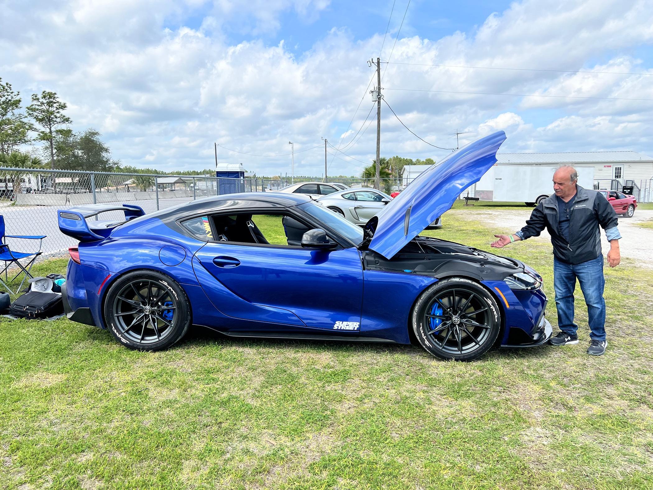

Love the way she sits - Perfect now IMO
Falken RT660 295/35/19 rear and 265/35/19 front
15 mm and 13 mm spacers rear and front, respectively
Eibach Euro (Z4) lowering springs (0.8 inches all around)
No rubbing front or back, great ride, hooks great (big improvement)
Hope this helps others looking for a setup on 2023 OEM wheels
I have plenty more photos if you guys want. Just ask.

How does the car feel after alignment? Have you done any cornering yet?
went to track (autocross) for the first time with this setup yesterday and it felt great. I was worried it might feel unstable with cornering but I was impressed with how well things felt. Honestly think I'll be sticking with these RT660s in the future when I run through this current set

I ran 305/30R19 RT660 on the stock wheels once, and cornering was very unsettled. The worst thing was the little wiggle the rear end did when mashing the throttle on the highway. I wouldn't do it again, nor recommend it.
went to track yesterday with the rt660s 295/35/19 sitting on the rears and it actually felt great. I was worried that the 295s might also feel what you felt with the 305s but I was impressed with how they felt cornering

took my pops to the track yesterday - we had a blast.
For all those wondering how the RT660s felt 295/35/19 rear and 265/35/19 front on stock wheels, I have to say I was surprised with how well they did cornering. With that said and as has been discussed here and elsewhere, ideally these tires would sit on a slightly wider aftermarket wheel but obviously I cannot personally compare as I have not experienced them outside of on these stock wheels.
3rd place in my class (smoked by two guys sharing their Porsche 911 Turbo S) but I was happy!
