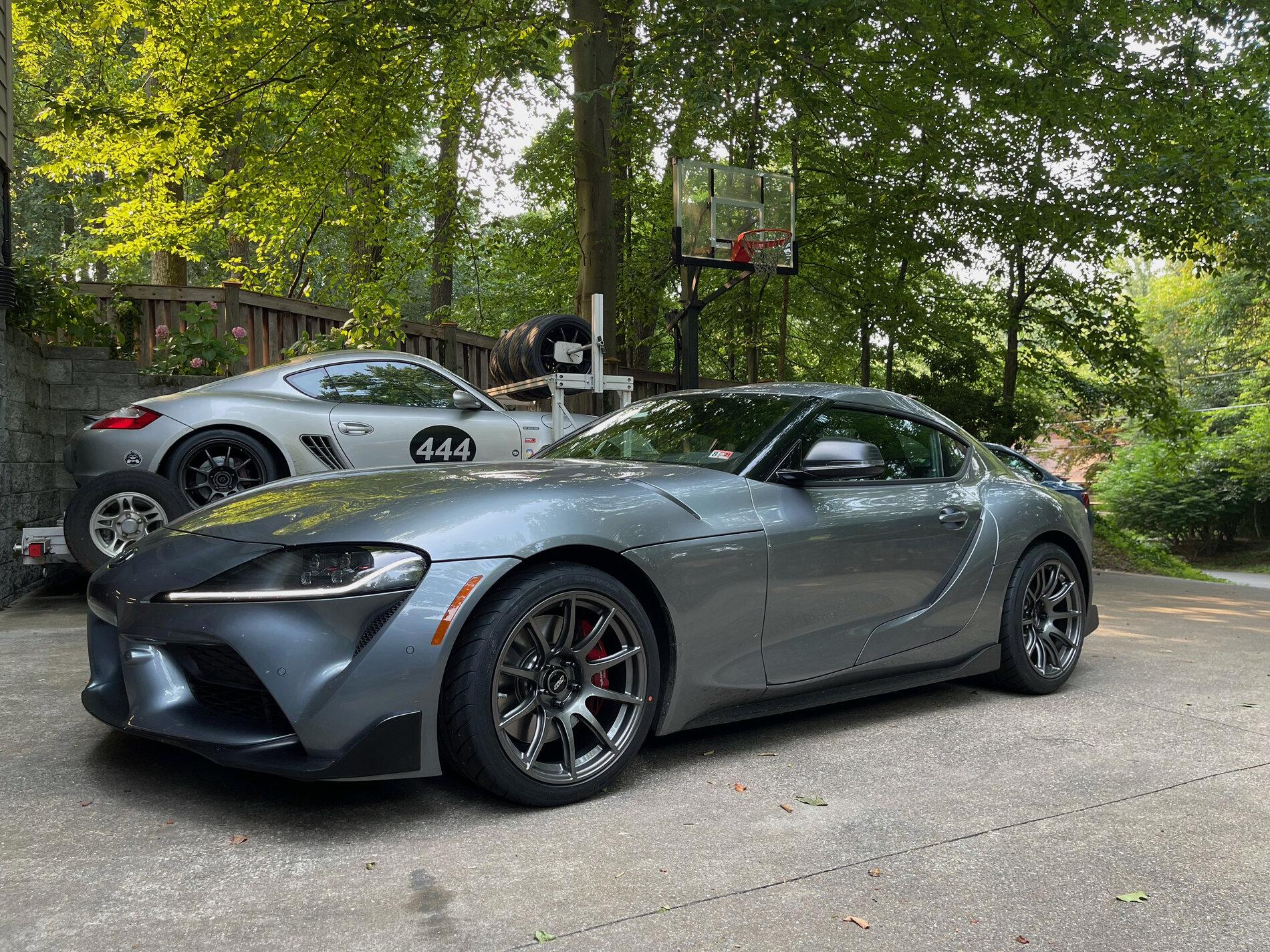

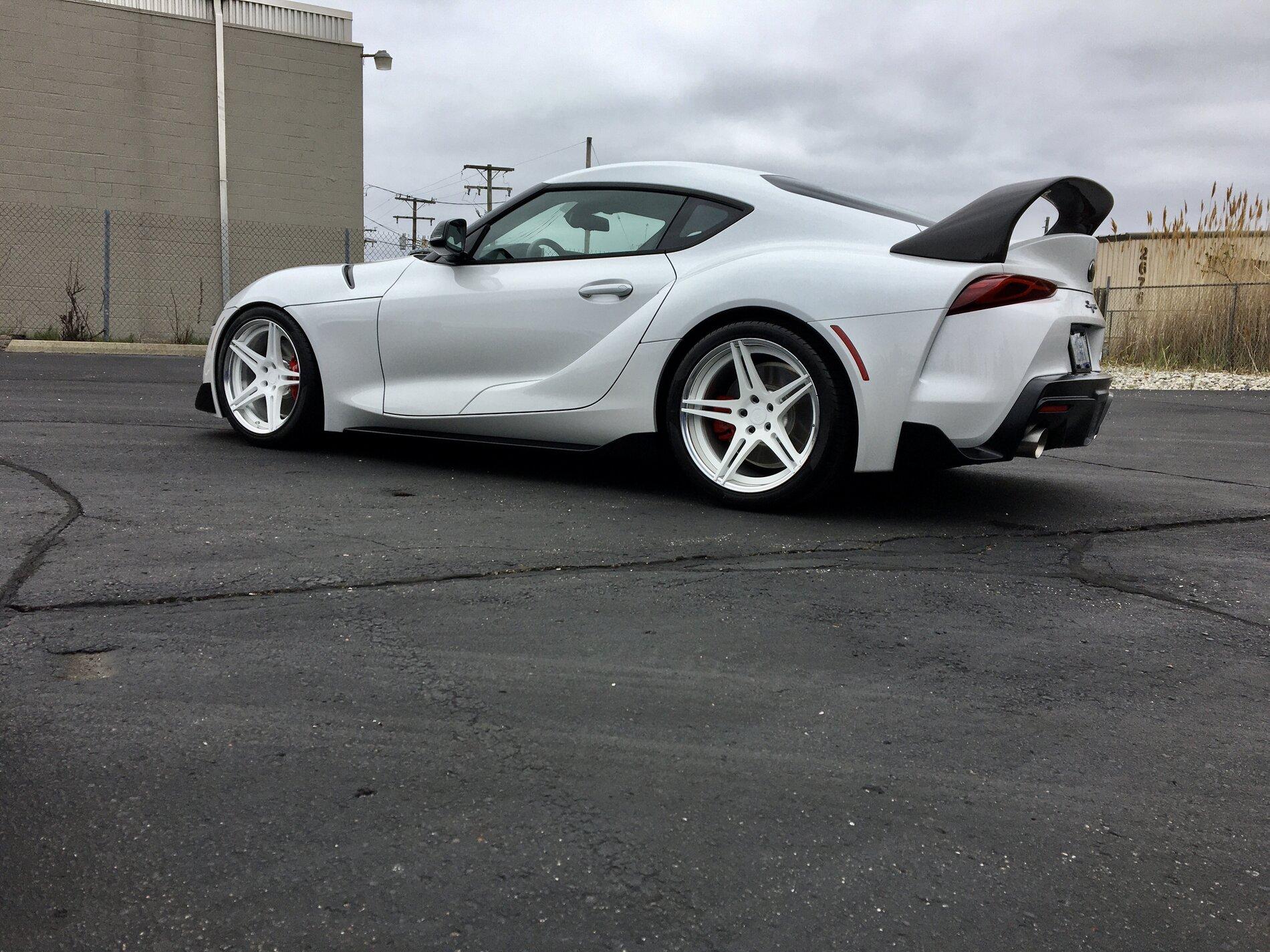

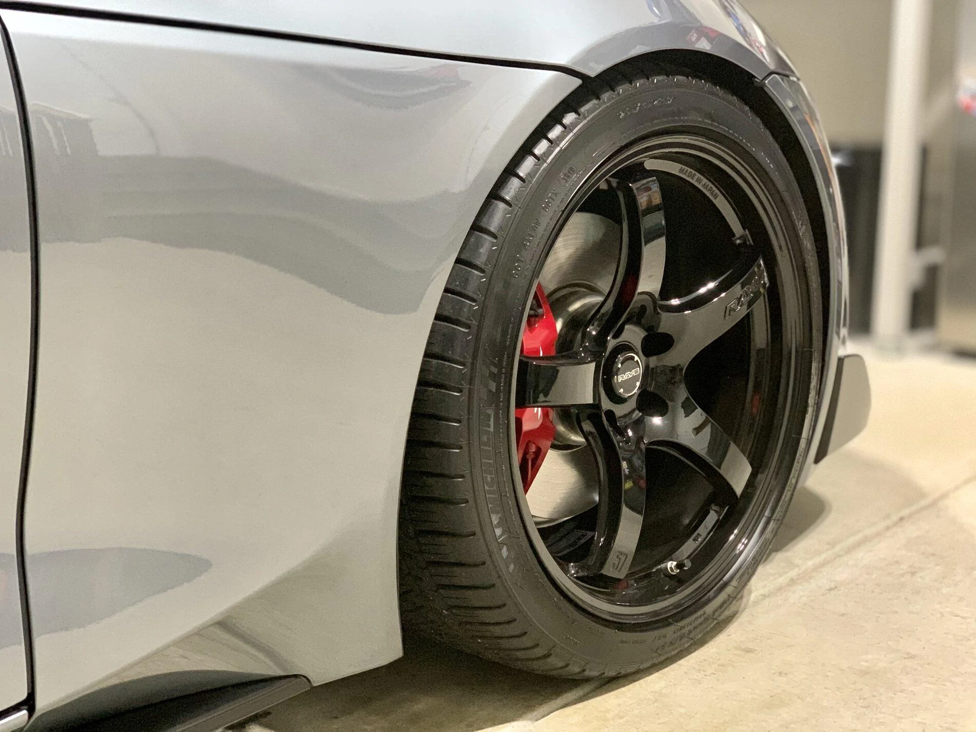

Konig Countergrams. Had to verify with Konig USA that they fit, and they responded that the wheels were made for the Supra.
Correct bore, 66.6mm
Fronts 19x9.5" 30mm offset. Huge brake clearance, could easily fit over any aftermarket BBK.
Rears 19-11" 40mm offset. Pictured with a 5mm spacer, as I had them laying around and wanted even more flush. Fits fine without.
Also come with black center spokes w/machined lip. I was just tired of black. Running stock tires to wear them out, then some 305s are in my future for the back. Didn't weigh them, but they are lighter than stock.
These look awesome!

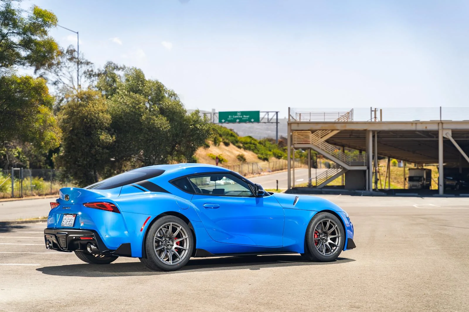

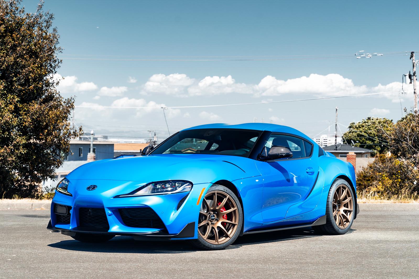

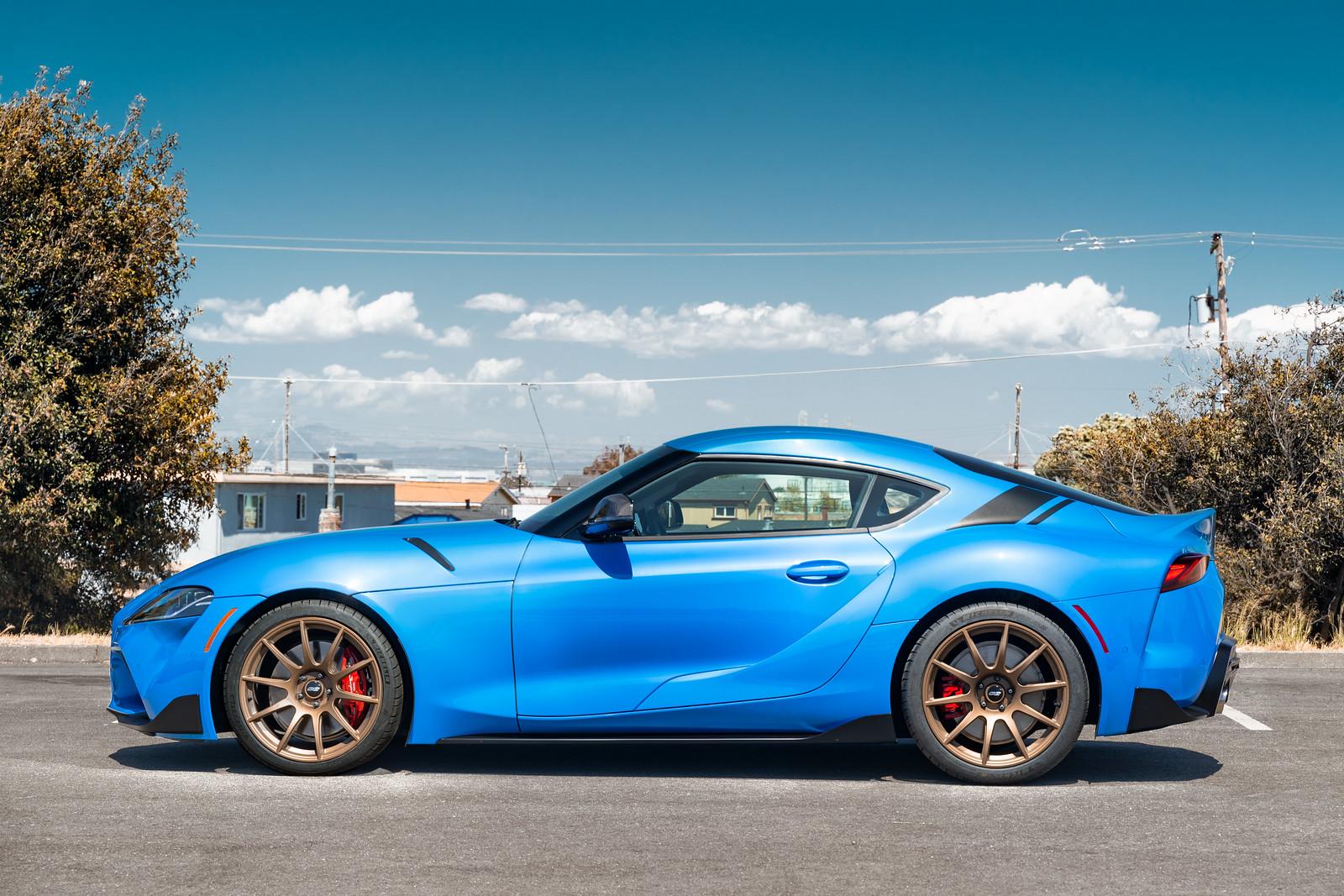

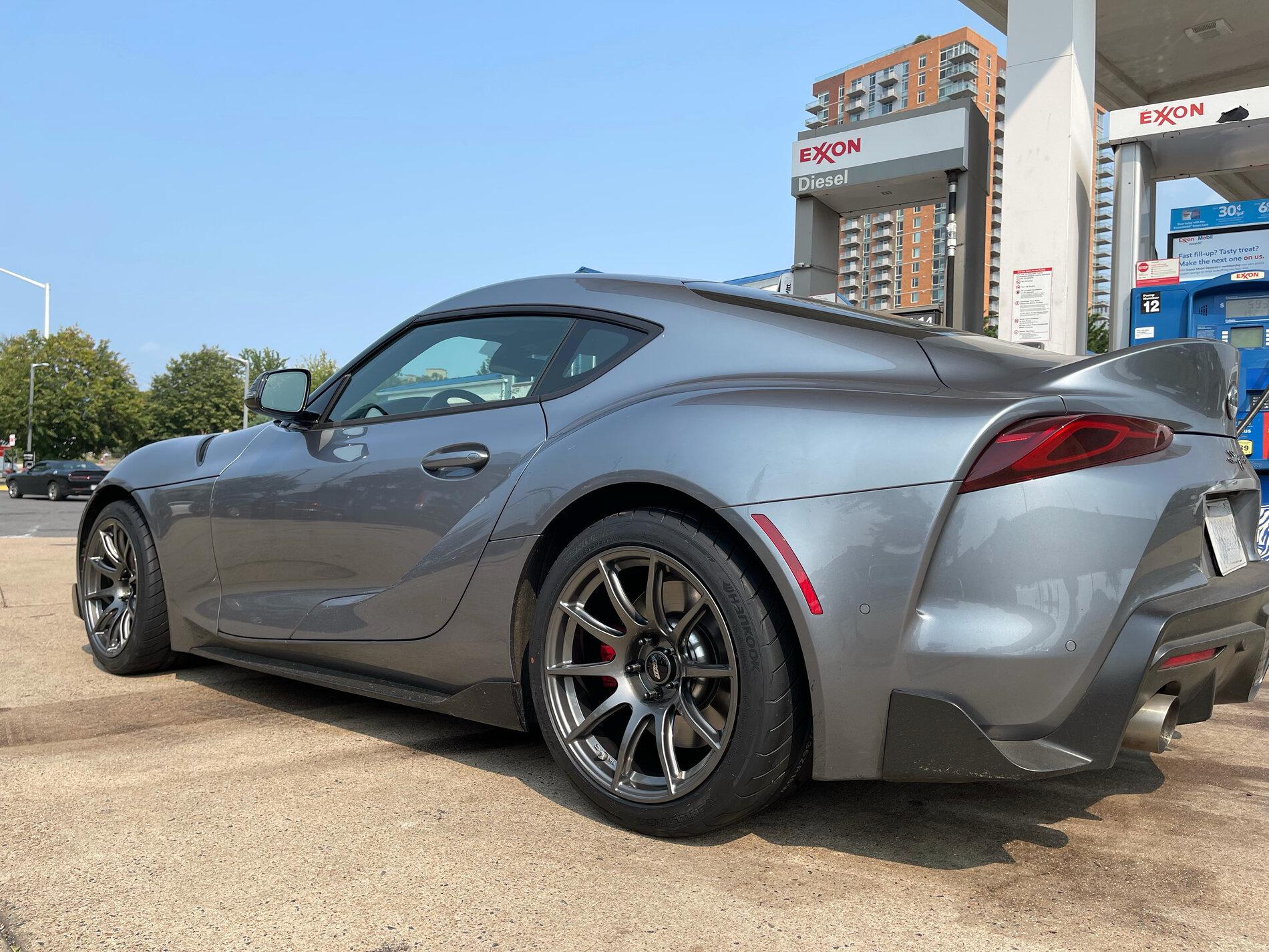

Loving the Apex wheels.
18x10" ET30 APEX SM-10
18x11" ET40 APEX SM-10
265, 285 / 35ZR-18 HANKOOK VENTUS R-S4
Next, sway bars and lowering springs.
This setup looks great! I'm sure it will look even better post-lowering springs. I'm always amazed at how wide the RS-4s run. They look like 295s on the 11s in the rear.
