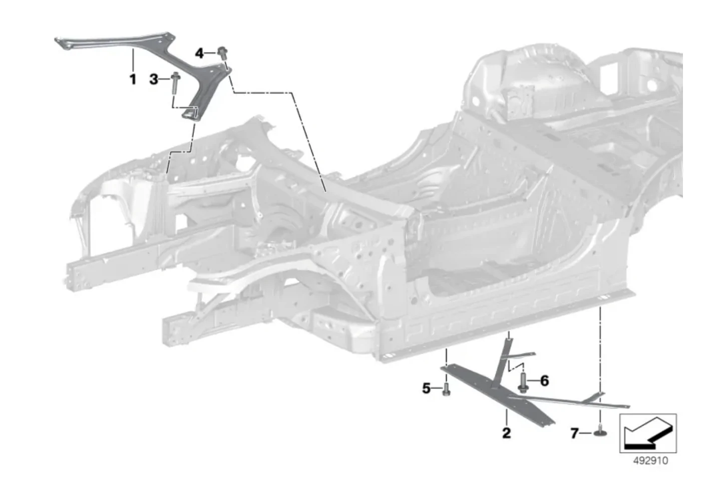

Also, is there an advantage to this platform with adding strut bars, or should I pass for the time being and just swap the sway bars? Been hearing mixed answers and been told to swap just one sway bar to doing nothing or everything.

If your car dosen't have the strut brace, adding it will make a difference.

I just know some guys get the Dinan strut bars or Blitz ones. Wasn’t sure if there is a serious improvement or just looks on the chassis.
There is already a firewall-triangulated strut bar on the car that goes under the wiper cowl and weatherstrip that sadly nobody makes upgrades for. That being said, i do have some dinan bars for sale in the classifieds section.
