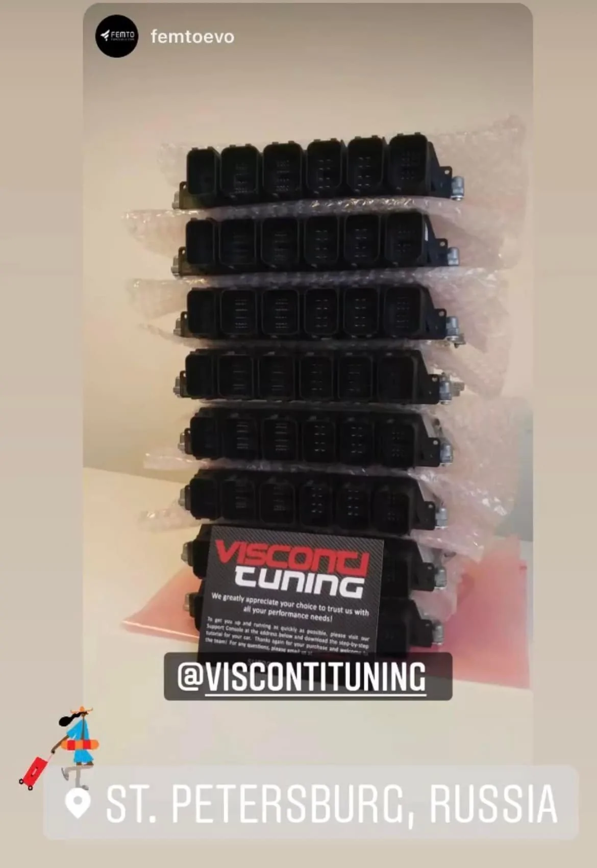

The service that was offered originally, where you send the ECU + Your Flash&Go Tune file to Russia was less than ideal.
We can OBD Program the 06.2020+ ECUs after they been sent to Russia.
We have end users kits...

yea, OBD flash without the clone is the new thing now. BM3 and MHD can as well once unlocked in russia.

Ok. I guess Ill ask the dumb question. Are there any current methods that you can tune a Post 6/20 DME without sending the original ECU to Russia?
Is there any method that is in the works that could possibly allow this, IF it doesn't already exist?

No..not right now. Has to be sent to Russia for the unlock at a minimum.
