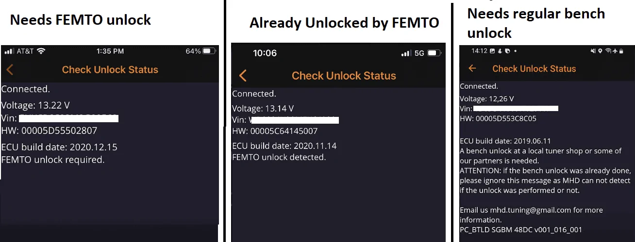

I have unlocked late 06.2020 DMEs, there is no single cutoff date,
easiest way is to check it with MHD app, "Unlock Check" button,
it checks what kind of lock DME has, whether it needs FEMTO or regular bench unlock, it does not check by build date, but by let's say lock mechanism

there was no one single cutoff date, I unlocked late 06.2020 DMEs, and had early 06.2020 that already had a new lock system
Here, you can see three possible results of the MHD "Unlock Check", fourth is "no unlock needed", for old cars
