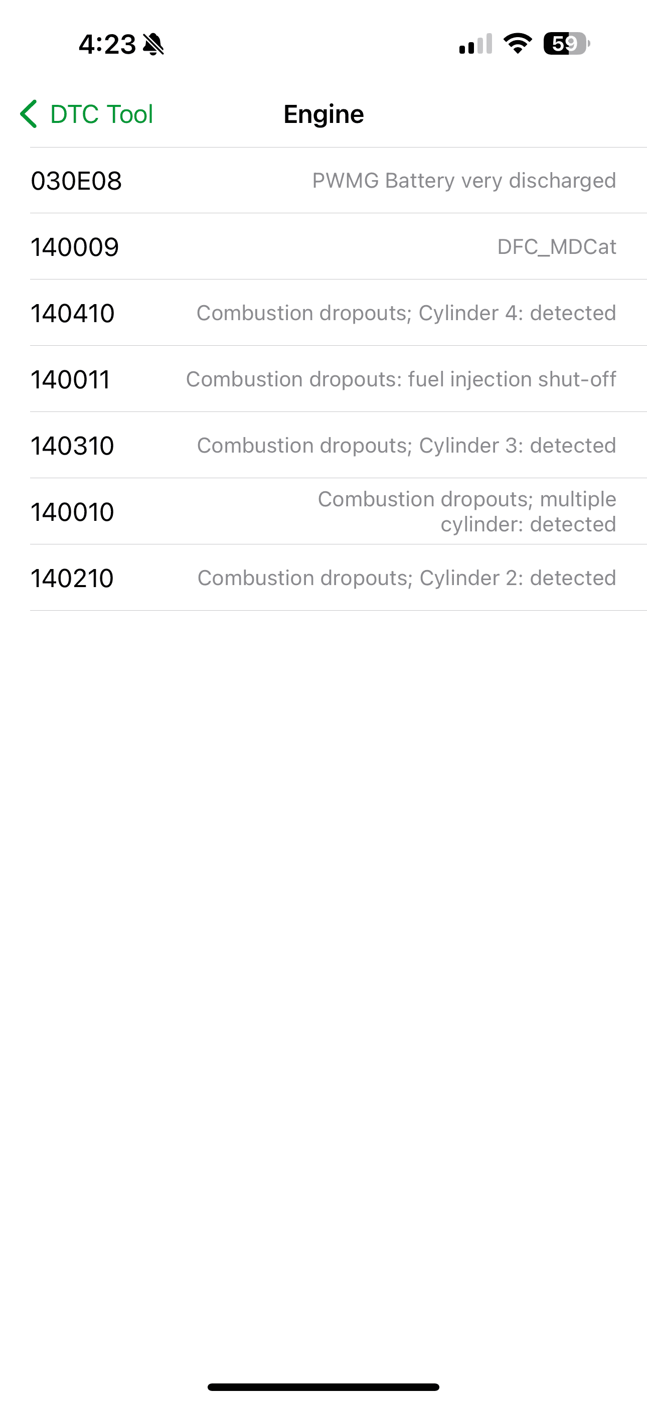

It does kind of make sense, just odd that you don’t hear of it happening to people more often because there’s tons of people on flex fuel that I’ve never heard of having issues like this. Also, are you getting a code for your battery being very discharged (code 030E08)?
I’ve had that code pop up for a while and decided to address it to see if it could have anything to do with my problems. Took the car for a drive today after charging the battery and so far I haven’t had the issue happen again. Not 100% sure it’s solved, but a weak battery in a BMW does make sense it would cause such issues.

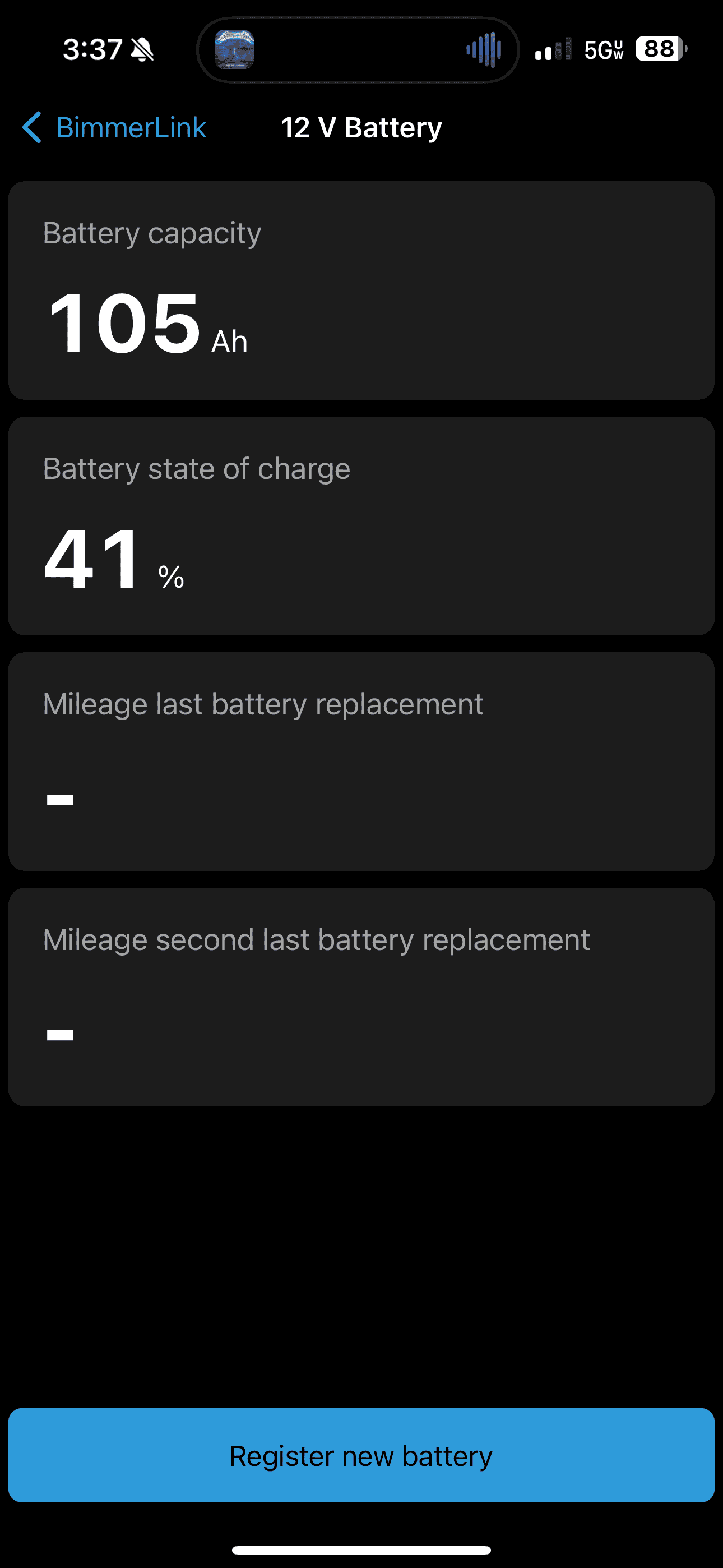

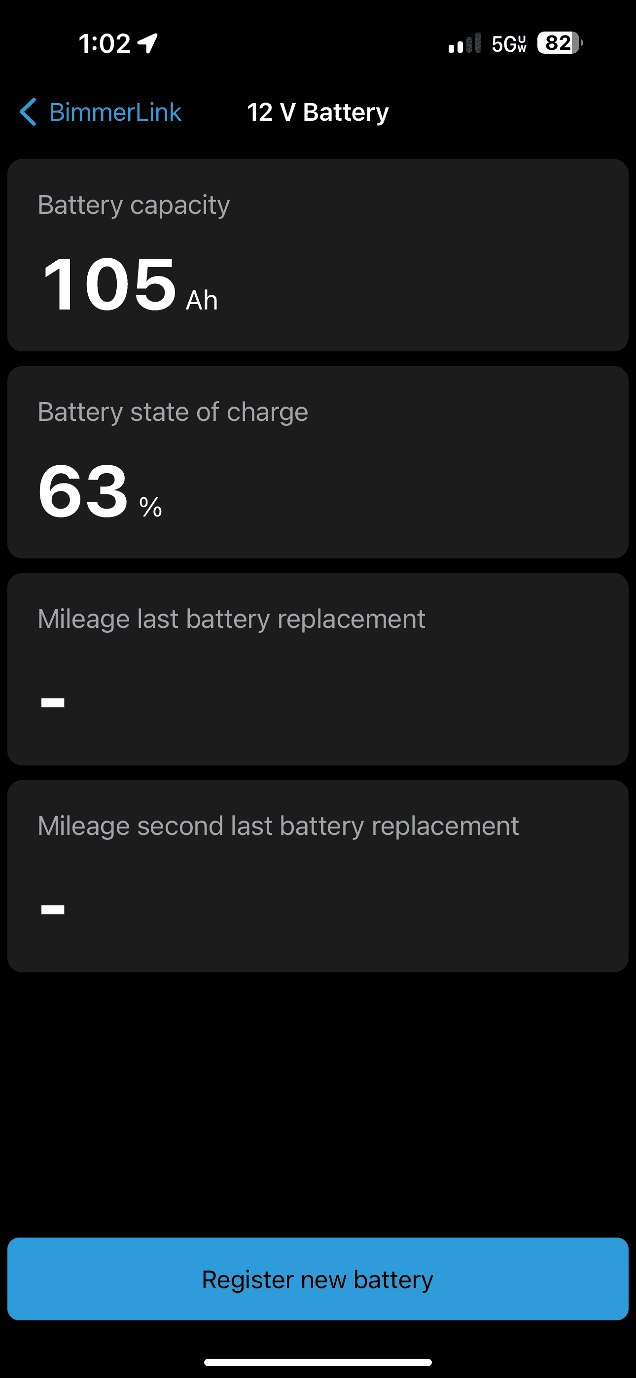

Just to add some more info, I used an OBDLink MX+ adapter along with the BimmerLink app to see “Battery current state of charge” which was 41% prior to hooking a CTEK battery charger up for 24+ hours. Afterwards, it is showing 63%. After doing this and clearing all of the codes I had, I have not had the issue again so far.
