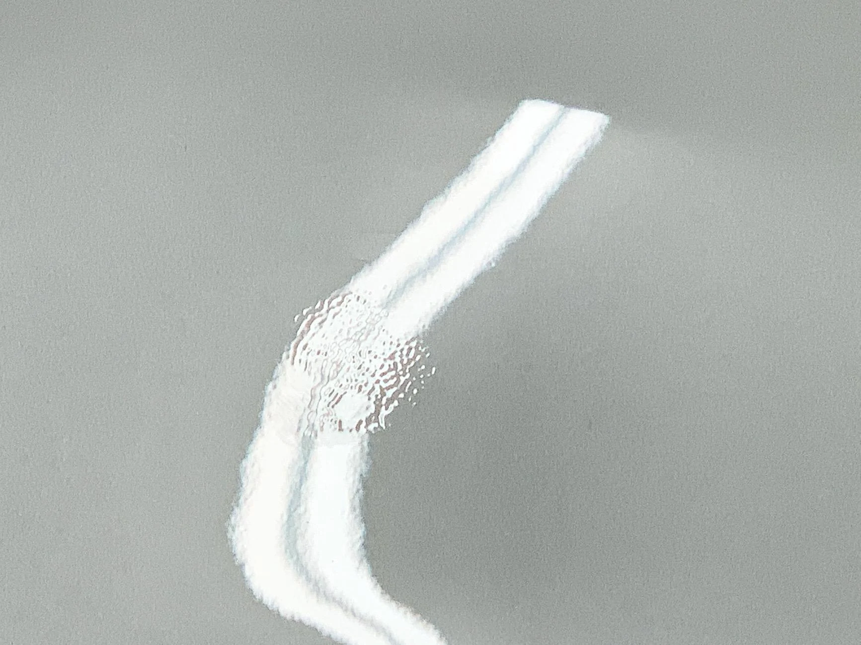

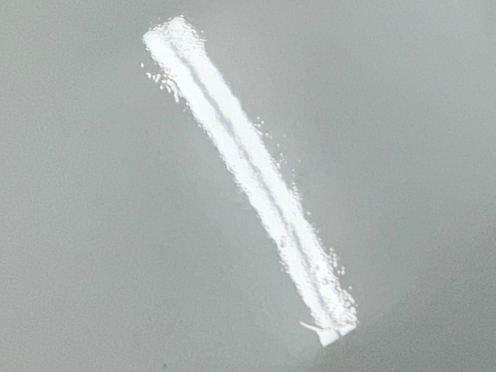

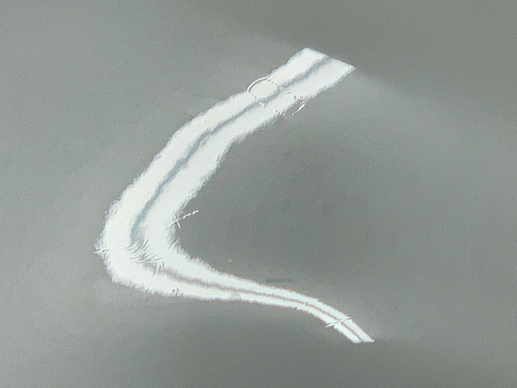

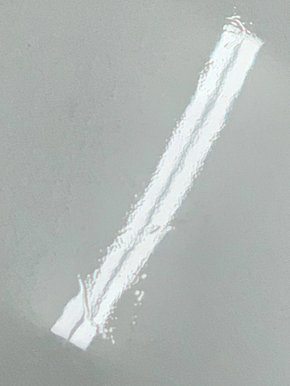

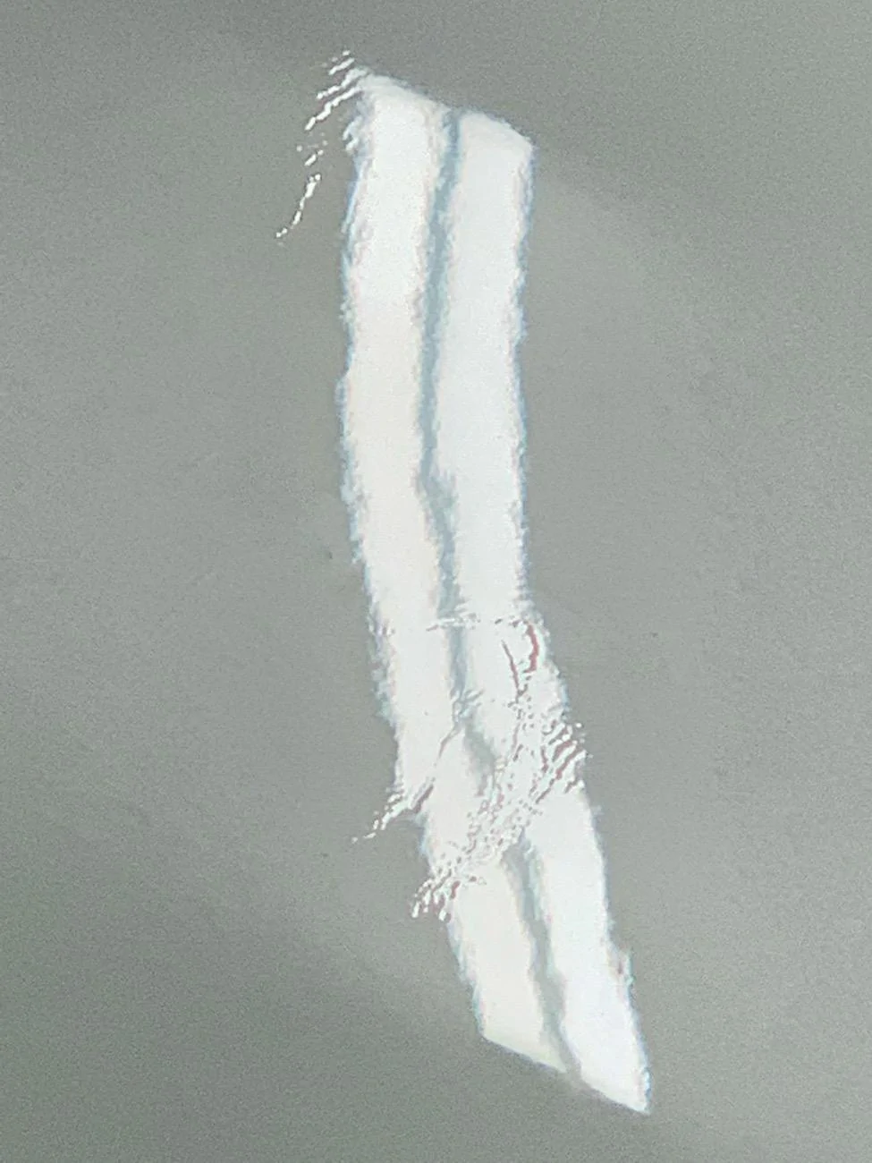

This was my first experience getting PPF. I bought my Supra new back in August of 2020 when most shops hadn't had much experience with its dramatic curves yet.
It came with the OEM PPF which was awful, but at least it was SOME protection while I waited a week for my PPF appointment.
I deiced to get the full front bumper, headlights, A-pillars and full hood (since I don't like the partial hood wrap look with the crease in the middle) - all for $2100 installed.
I chose a shop that was very well-rated and recommended STEK PPF installer.
The bumper, headlights and A-pillars came out great! However, the hood had some areas of distortion - I've attached the photos which I took just after getting home from the install below to show the shop's owner.
After taking the car back, the owner told me that the Supra's large and curved hood is difficult and a challenge to wrap, hence the areas of distortion, which comes from slightly stretching the film to contour the curves.
I have to say that after four years, it's all held up very well. However, I may go another route when the time comes, either PPF or installer.
Has anyone else have this experience?

~ My personal car has none of these noted stretch marks or heat gun scared areas. This is unfortunately due to poor installation and / or lack of experience with ppf. You shouldn't have any marks in the film period.
As for the guy who's watched hours of ppf videos... you might as well throw your money in the toilet if you're going to attempt an install with zero experience. I've personally installed over 300 kits since 1989 and it's a learned and perfected skill set. The Supra is a very difficult application (and no diy).

Live and learn, I guess. Not many shops in the Dallas area were familiar with doing PPF on Supras back in mid 2020 though.
At least it's only noticeable by me and you'd have to really look for it in the right light. On the bright side, it's kept everything protected since day one.

From my understanding it is actually one of the hardest vehicles to do out there right now with the front bumper being the hardest part of the whole thing
