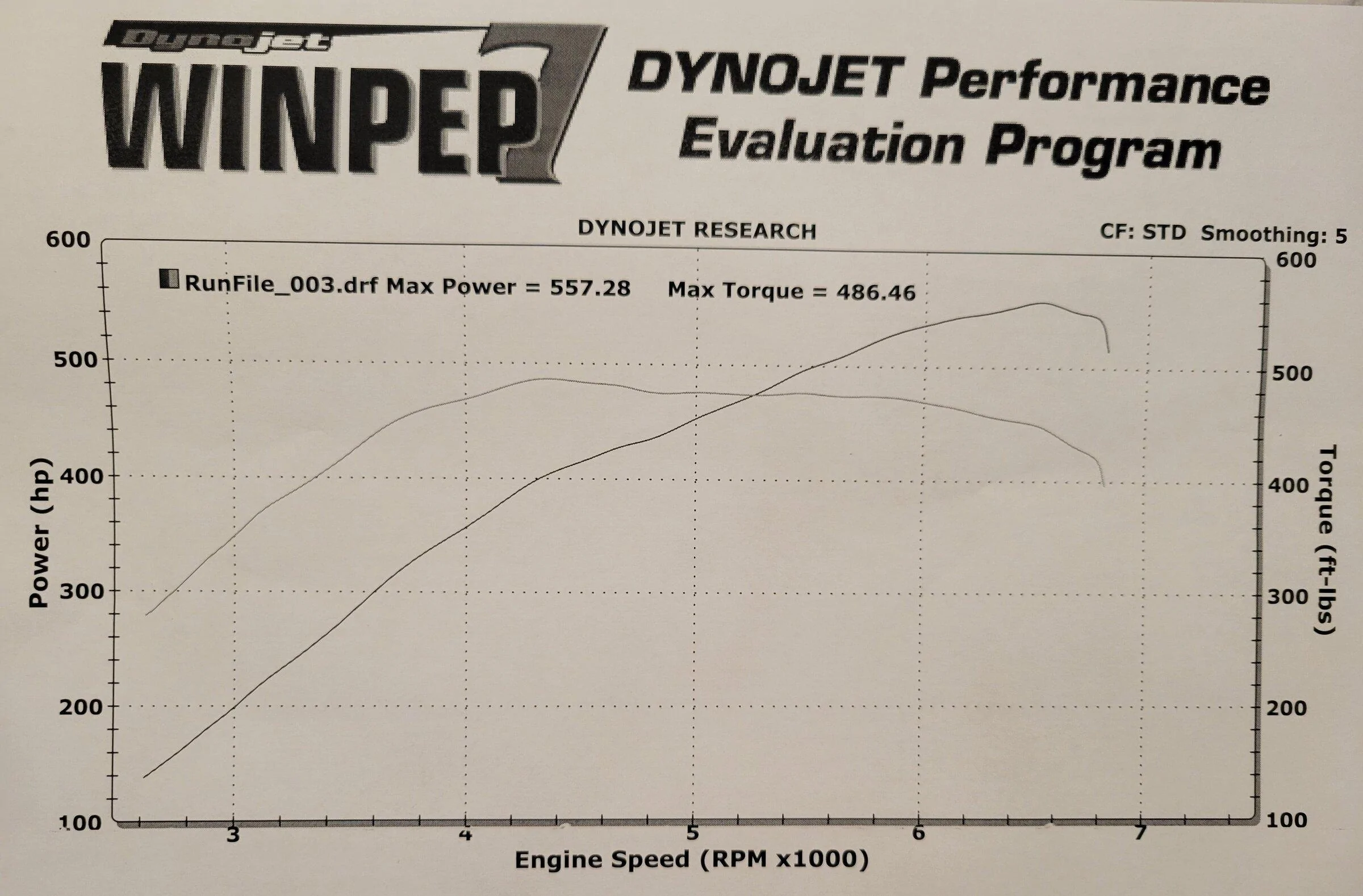

Since I’m catted I can expect a little less power..
steve
My Pure800 setup with a catless DP and ECUTEK 93oct tune is at 557rwhp.
What’s with the TQ? Less then me on 93… e50 stock turbo cars are making 600 wheel, that’s about the max I’d put through the stock trans but 480 seems very low. I’d want to be around 550 wheel and 600 wheel torque if I did a pure on 93

It's really hard to save. It's possibly dialed down to save the trans- but we can discuss that in a different thread? ;)
