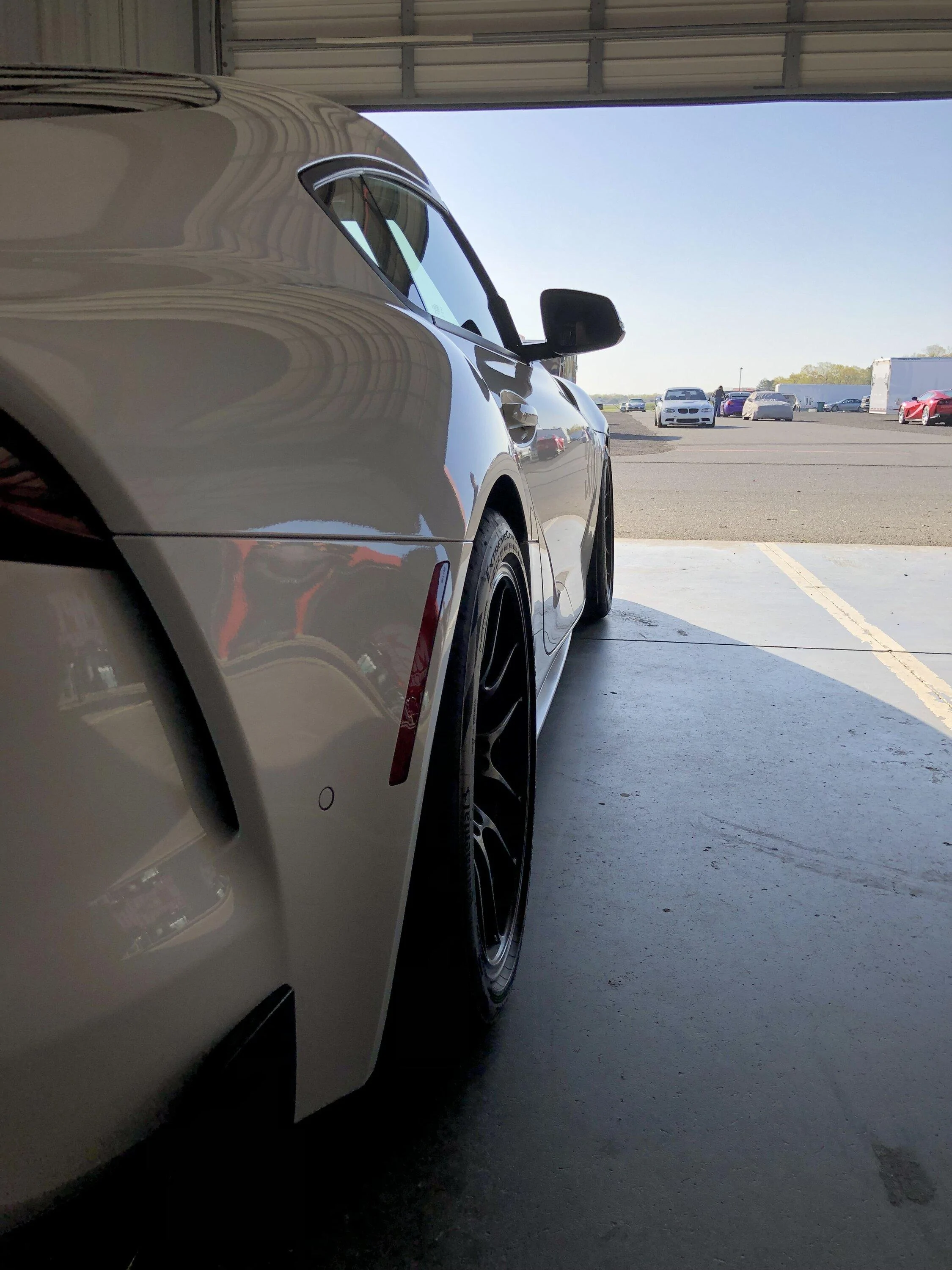

The 295/30/18 isn't a hard tire to fit honestly. Here is a 295/30/18 Conti ECF on 18x10.5 +35:
