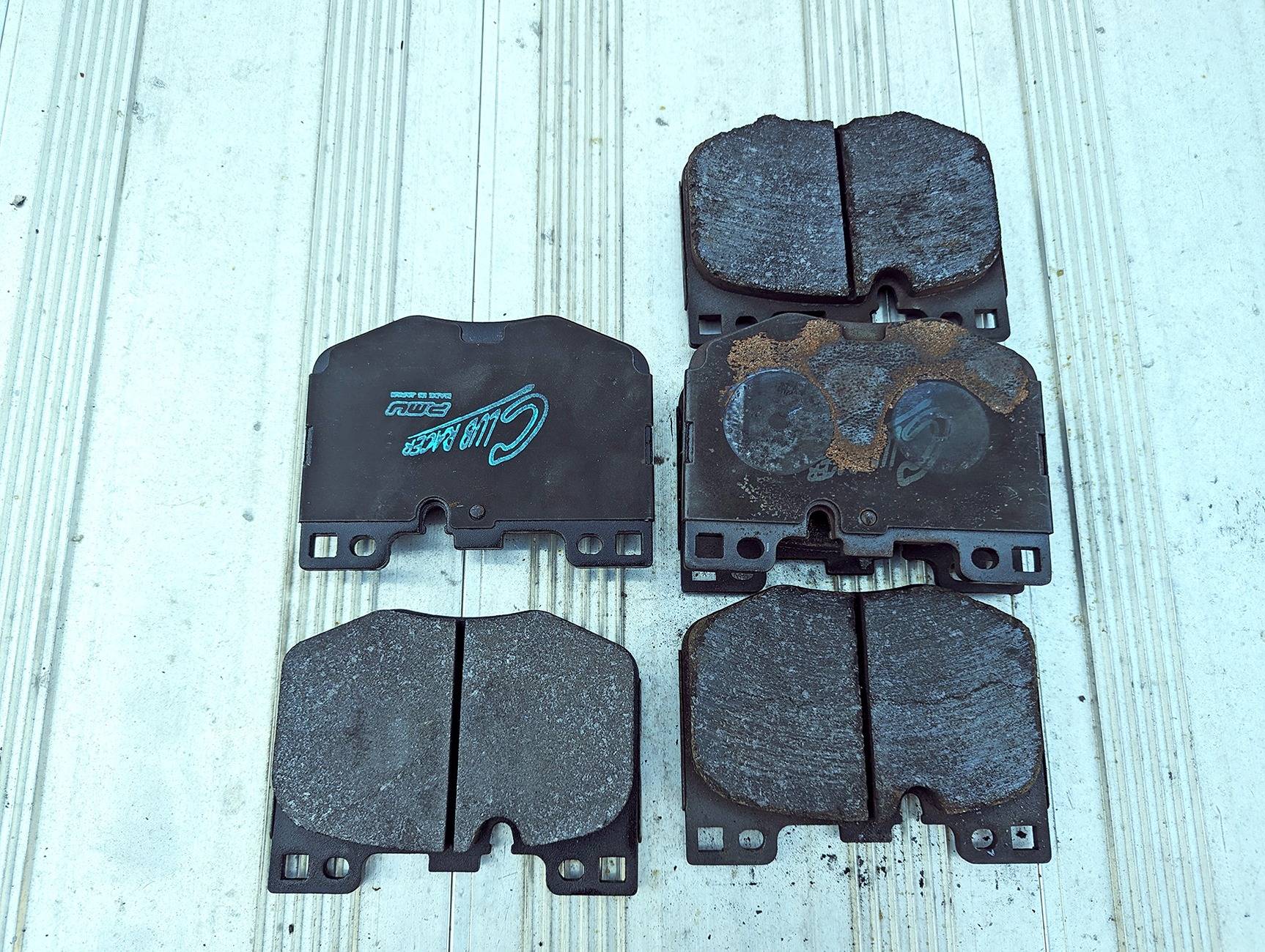

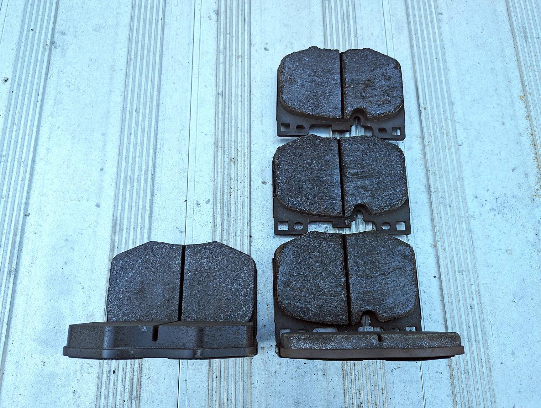

PMU Club Racer front pad wear after 2.5 days at VIR and 2 days at CMP. They looked practically new after VIR, but 2 hard days at CMP cooked them pretty good. The shims were cooked, crusty and warped and separated from the backing plate. They wore about 5mm so ~50%. I went ahead and threw on a fresh set along with a matching set for the rears since I was running OEM before. The rotors still look really nice.
With a stickier tire they're not going to live long at CMP, so after this new set I'll probably step it up.
8,683
17,023
You still have a ton of life left on those.
