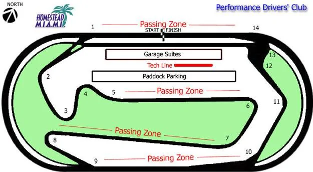

But I see his line as being fairly off (then again I'm a perfectionist). Not using the pavement change for his line is the biggest part. Remember concrete provides higher of levels of grip in the dry vs asphalt, so use it to load up the outsude tires for more grip at Homestead.

Need things like turning in earlier for T3 and staying tight, turning in earlier and tighter for T8, turning in later for T10, not going so deep in T11 and just getting the final grouping of turns smoother.

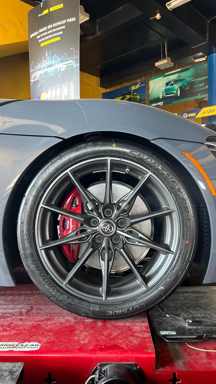

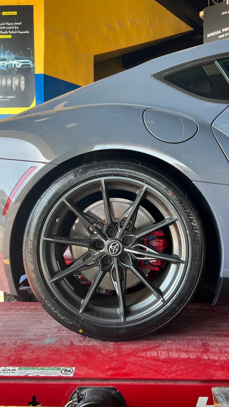

The AR1's run narrow so you should be good. For some reference, here are 275/35/19 AR1's on 19x10 square. You can see they should be fine on a 19x9 in the front (although not optimal), they are a pretty stiff tire
You’re right, AR-1 is narrow.
Front is 275/35/19 with 9 inches OEM wheels
Rear is 275/35/19 with 10 inches OEM wheels.
going to test the car today in the track and give a feedback
thanks again

Need things like turning in earlier for T3 and staying tight, turning in earlier and tighter for T8, turning in later for T10, not going so deep in T11 and just getting the final grouping of turns smoother. Then again I don't know the skill level of the video poster so I dont want to hammer down too hard. Just here to help!
This mindset then leads to trail braking to carry that speed to the apex with the grip at the front. Very helpful at several turns at Homestead.

Edit: some of the older maps call it turn 14 instead of 15. So 14-1 or 14-2 full throttle, then threshold brake - otherwise those passing zones = perfect threshold braking spots.

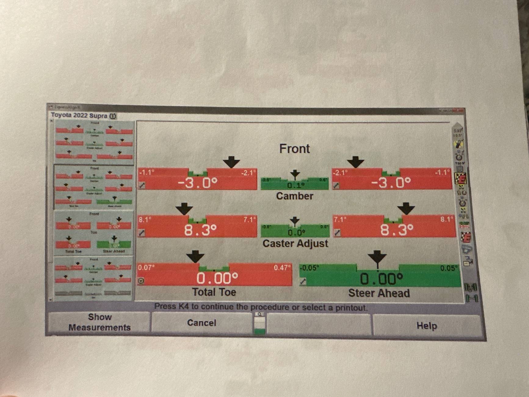

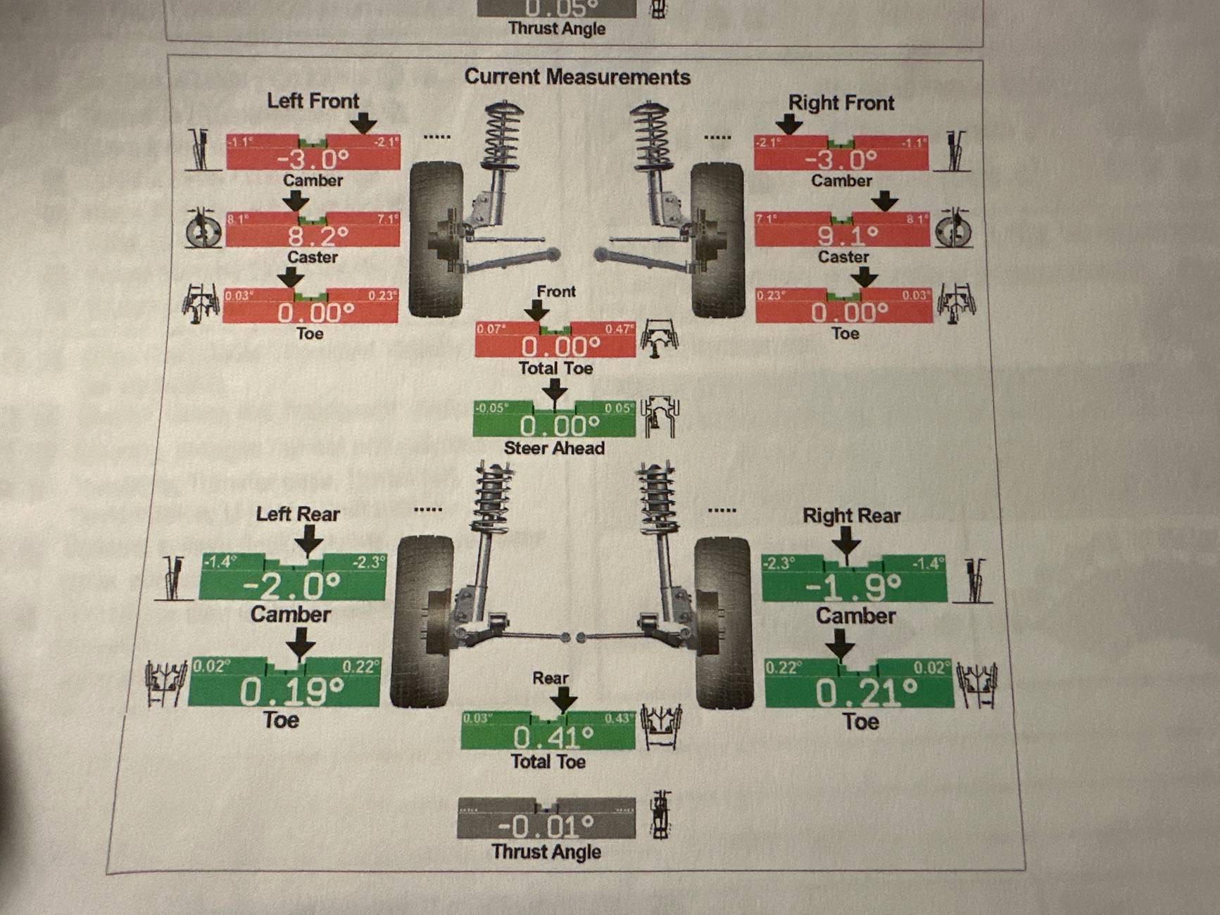

Alignment question. I HPDE with my Supra in either intermediate or advanced groups. Use Hankook RS4 tires 275 front 305 rear setup, SPL front lower control arms, sway bar end links, and caster bushings, Cusco sway bar front and rear. Saw a post once that says this is the ideal alignment (pic 1), and my last alignment is pic 2. What do you all recommend? Any thoughts on the “recommended” alignment spec? Thanks!
Hmm, with your caster bushings you should be able to even out the 1 degree difference. The spec otherwise looks good other than getting more rear camber (around -2.5 degrees rear with -3 front which is doable with stock arms). Rear toe is a bit aggressive (but in spec for a track setup) and will be very predictable on corner exit. Rear tires are going to wear a bit faster.

That’s some wide rear tires. I can only speak for a square setup on mine. More neg camber the better of course if you can get by w/out rubbing. If you prefer a quicker turn in, you can add some toe out up front. I did on mine and love it ? And for more stability under hard high speed braking, toe in on the rear is preferred on our cars.
Great! Thank you! I appreciate both you and FLTrackDays commenting and for your wisdom. Would you have recommended specs I could send my alignment shop? They are working on it tomorrow.
Thx man. Not much wisdom here. Just a lot of learning from my stupidity ?
Unfortunately my specs would differ from yours. It’s going to depend on your tire size, ride height, spacers, etc. Since I’m on a square 18 setup, my car is inherently lower than OEM and had to be adjusted. It took a bit to get her dialed in, so to speak. But no alignment machine spec sheet. The guy that does mine uses a string setup and pen and paper. I’ve asked before and quickly forget because we change it so much.
I do know we’ve got as much front neg camber as she’ll take. It’s around -3.5 to -3.7, the rear is -2’ish and a small amount of toe out up front and toe in -in the rear. Somewhere else I posted my toe. I‘m not one for list & let the experts do it. Sorry broham. But it doesn’t take much toe, front and rear. But that’s the general idea. Pinch out up front and pinch in on the back will help a lot. The person that is doing yours should know to give enough room to avoid rub on high speed compression & tuck under the fenders. Avoiding rubbing there as well.
Start with small amounts with everything and increase as you get more outside tire wear. If you can’t get the car to rotate or have a hard time turning in, that’s where you’ll benefit from the small amount of toe out up front. Most peeps on here keep the front toe at zero. So make sure you’re comfortable with her turning in faster and the back end coming around quicker as well. You’re still going to want toe in on the rear for stability. Enjoy amigo!

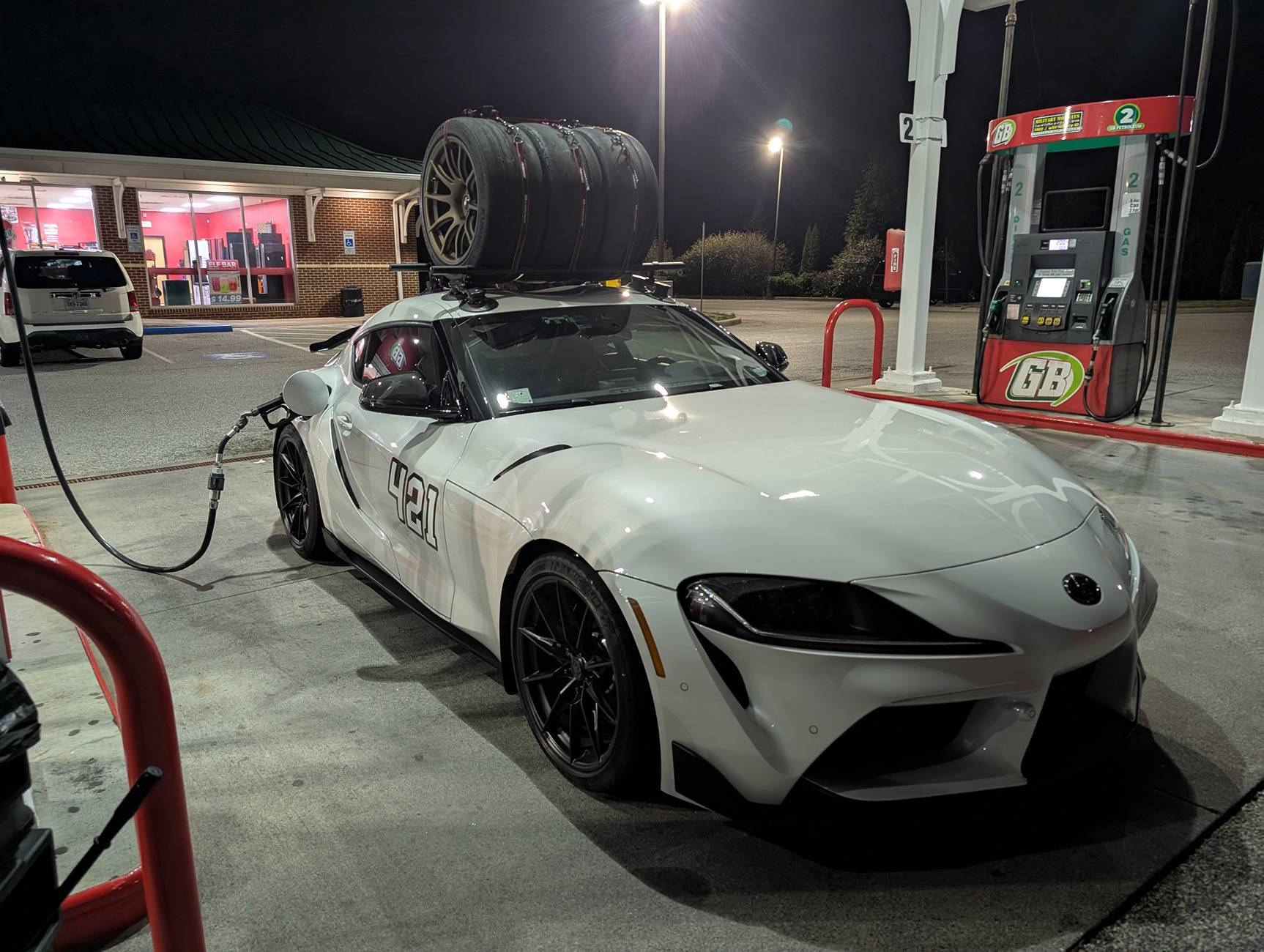

Another successful roof rack excursion. I got to find out what happens when you crest a hill and come across an escaped horse and have to brake hard with the tires on the roof. Nothing, nothing happened, solid as a rock :)

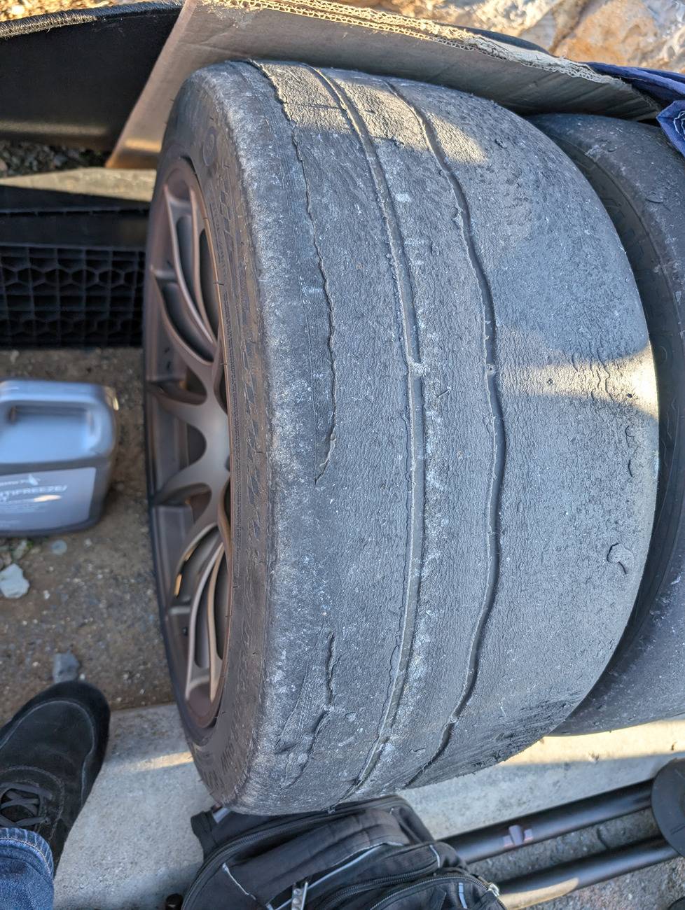

Glad i brought the rack, as I had to switch wheels between days. I got 10 days of 5-6 full sessions out of the tires, I think I'm happy with that. (v730).

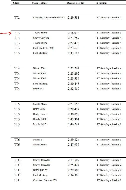

Gapping corvettes you say? It's even better when it's at a track designed for them, NCM Motorsports Park. The TTU Corvette was an interior stripped c8. Hot lap video to come later. I'll have to see if any of my practice session videos from Friday have me bullying any Corvettes from behind.
