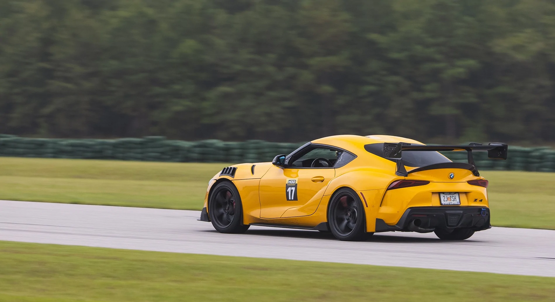

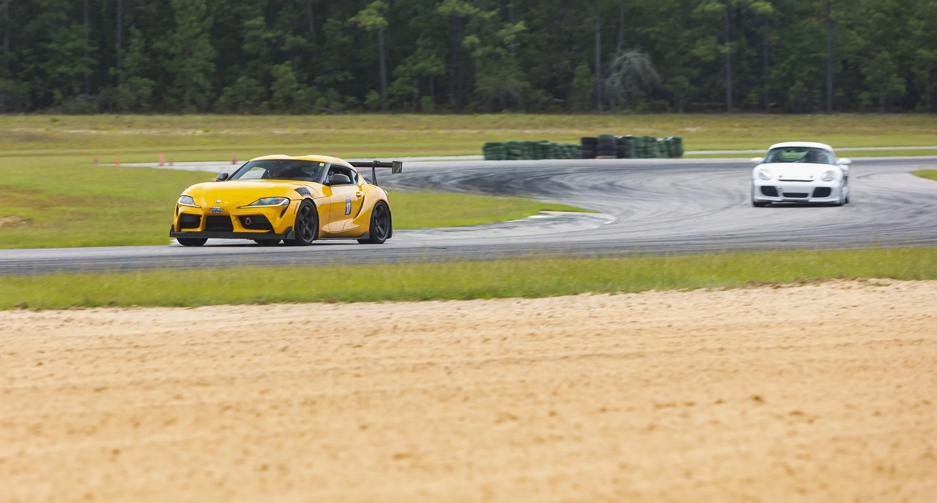

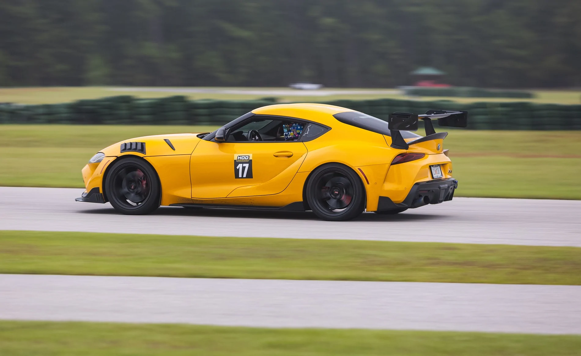

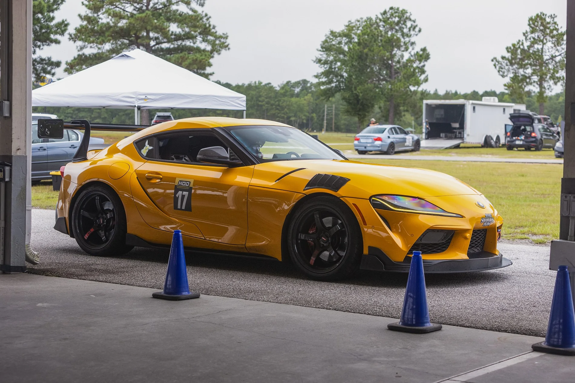

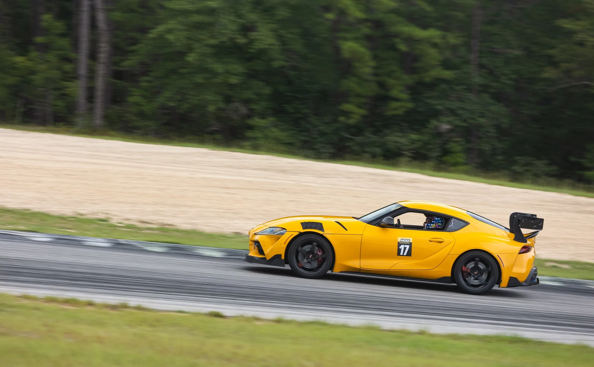

More CMP photos from a new friend, someone @DC5UPRA supra brought along.
ALso, this track COOKED my PMU CR fronts. They crumbled when I removed them.
Car looks good.
CMP is very tough on brakes. I have been running CSG C21/C11s and they had no issues, I've run CMP twice this year. FWIW.
