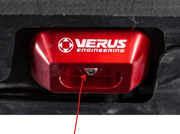

I like the Verus optoin because its one less thing for me to mess with while using quickjacks. Just toss the quickjacks under to the right points and lift, no more messing with lining these up.

With the verus jack points, i wont have to bother. Just slide the quickjacks under to the roughly accurate area and lift.

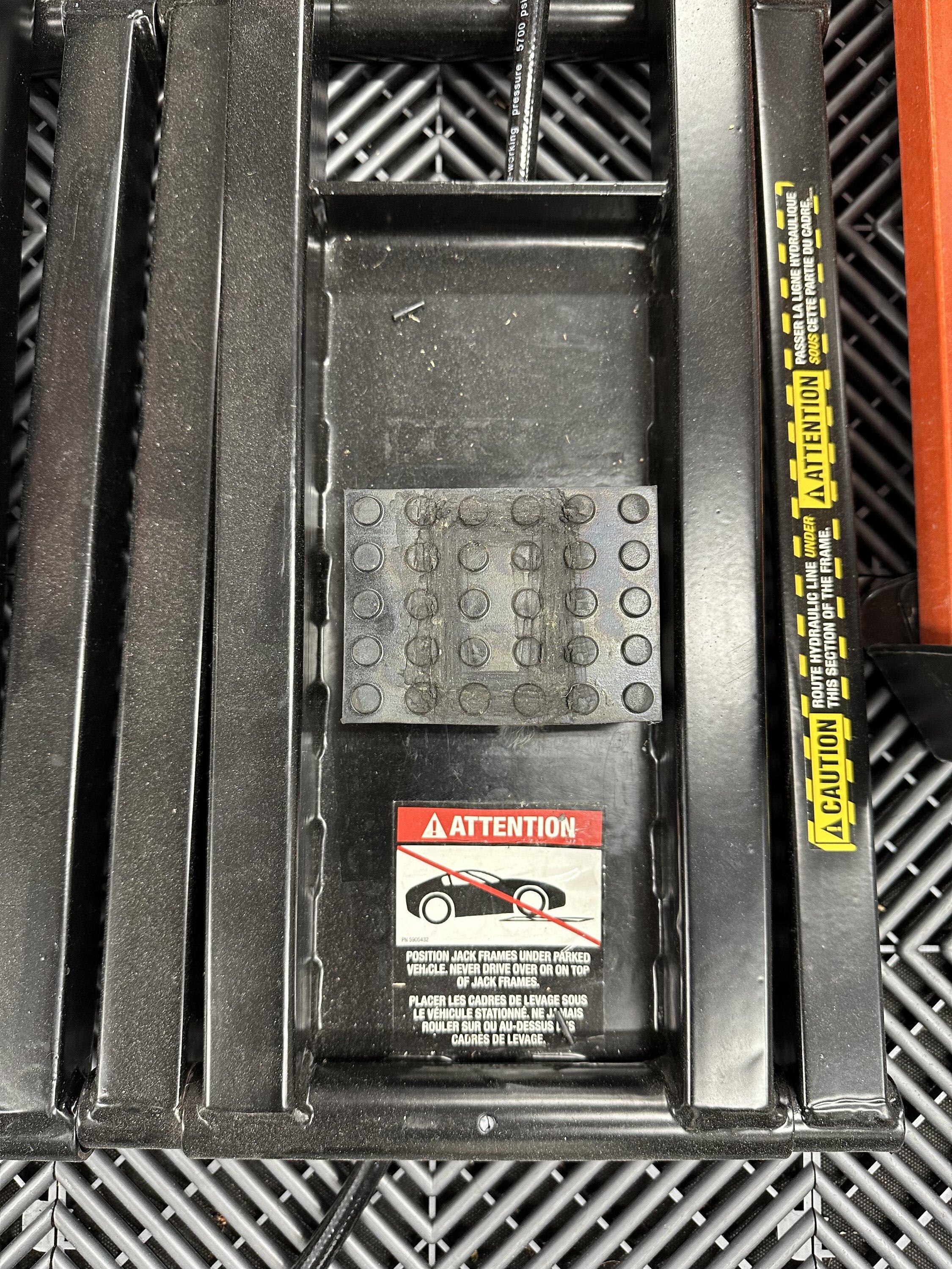

There's no need for those pucks with the stock jack points, you can just slide the quickjacks under the jack points and lift. I've done it at least 30+ times now on my car and the stock jack points still look like new.

Zero need for those pucks with the quickjacks. I don't use them and my jack points still look brand new.
I just slide the quickjacks under and lift like you stated. The quickjacks come with those big dense rubber rectangles.

how would that happen? It would be the same with or without the pucks. You are positioning the big rubber rectangle squares that come with the quickjack sideways right? If you are using them inline with the quickjacks, then I could see that being a little iffy.
I use them like this, you can even see the OEM jack point indention. This is exactly how you are stating you would use quickjacks with the Verus jack points.

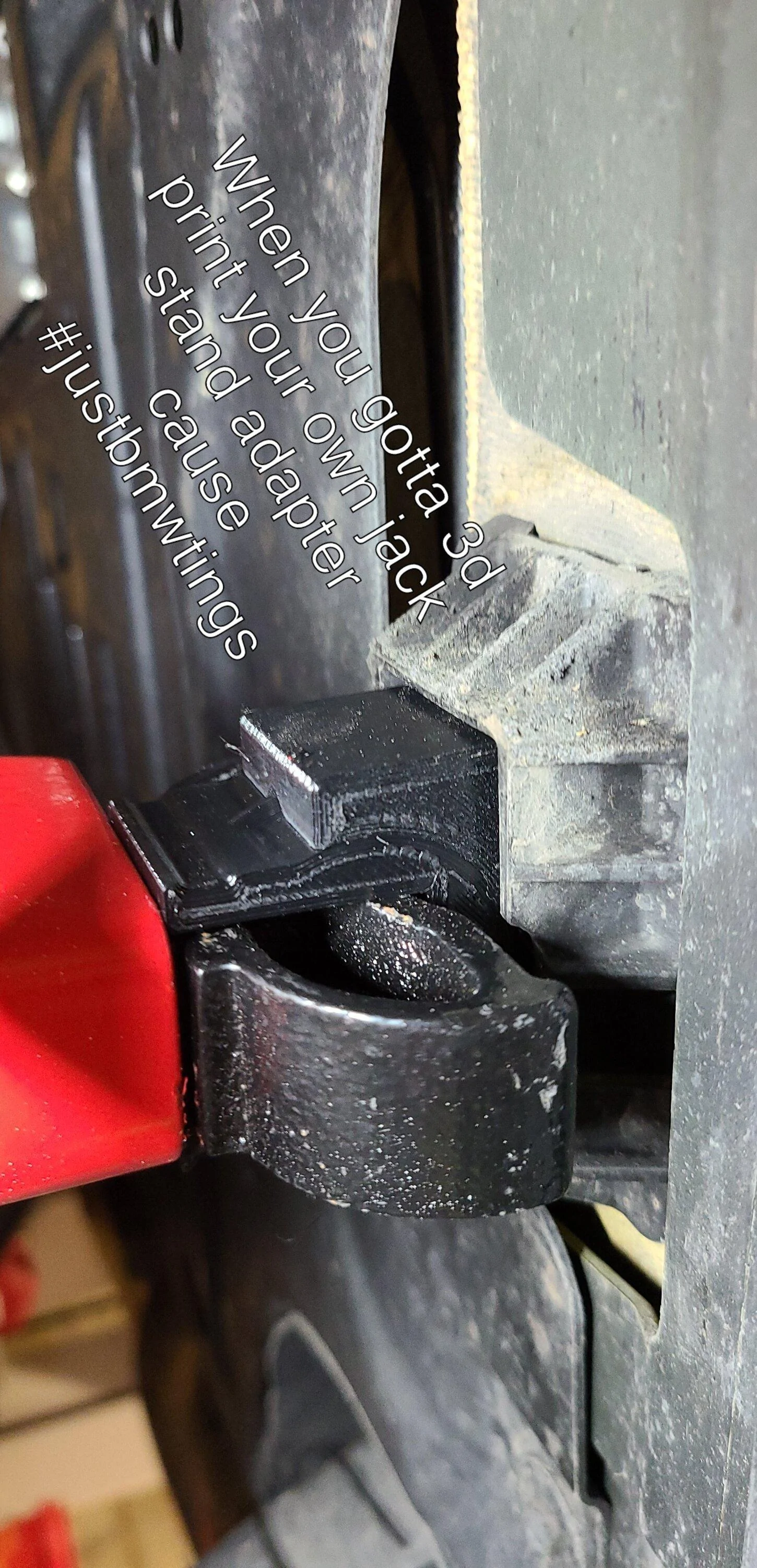

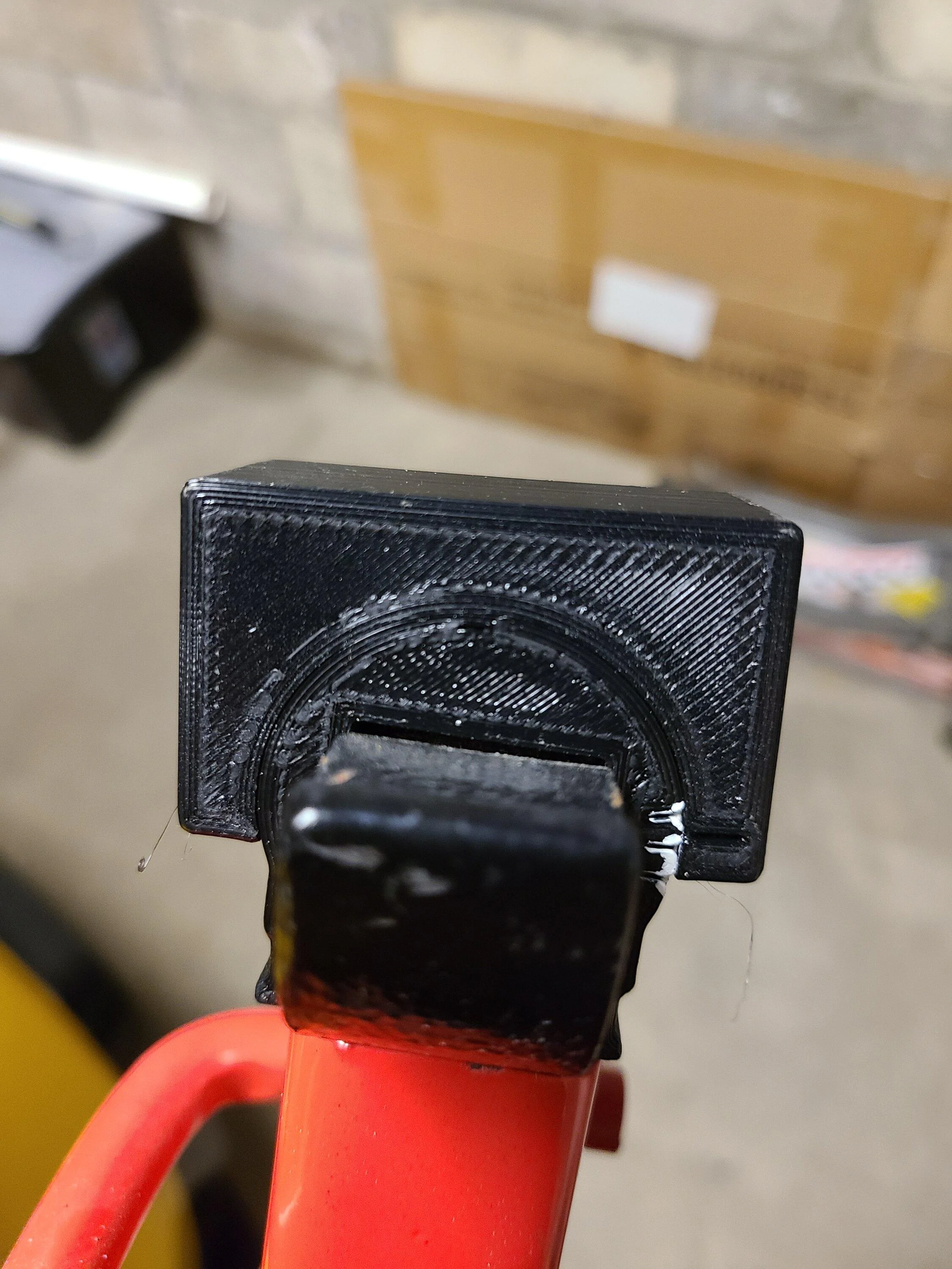

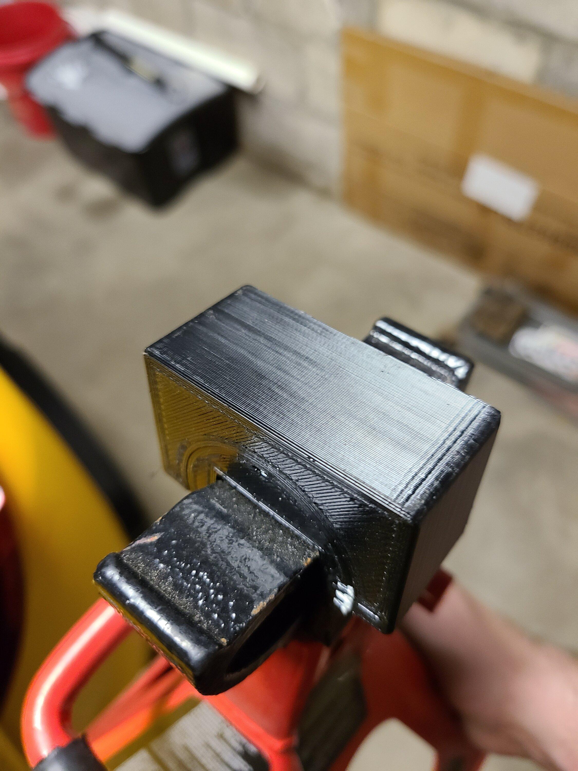

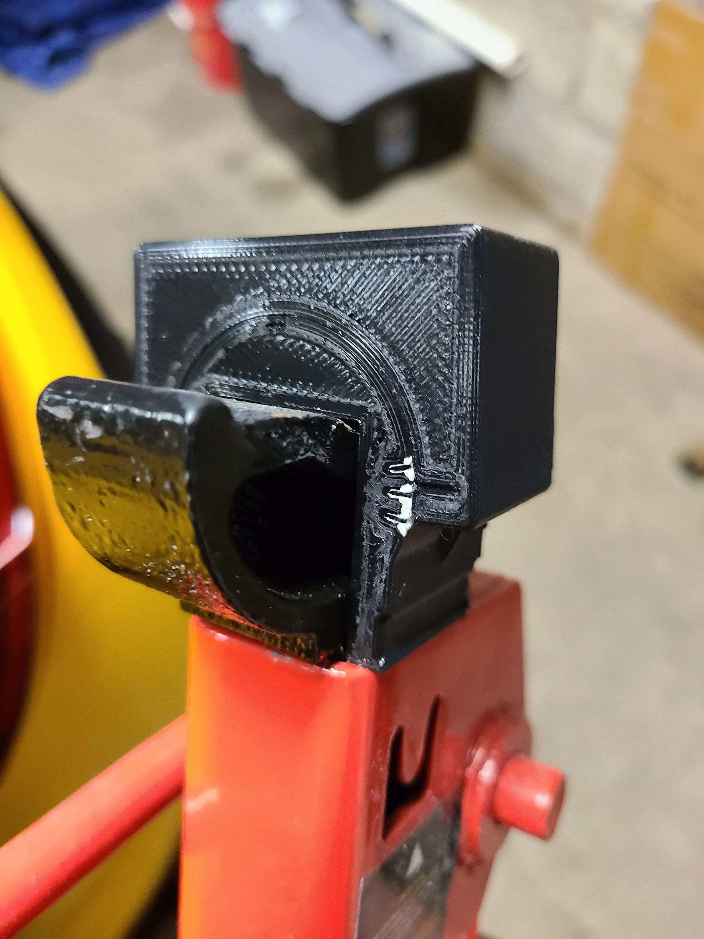

I've been using a 3d printed jack stand adapter for my supra for over a year so far. Slots into the U-shaped stands and adapts to a block. 100% solid printed in PETG and it even pivots. Maybe $5 in material and they've worked great. Had my car sitting on them over winter too

I use these with my floor jack, and yes, lining them up properly is an exercise in contortion and patience...and that's at stock ride height. I can't imagine the fun I'm fixing to have when the car is almost an inch lower, and I might have to buy an even lower-profile jack on top of it all.
The Verus pads are very appealing for this reason.
