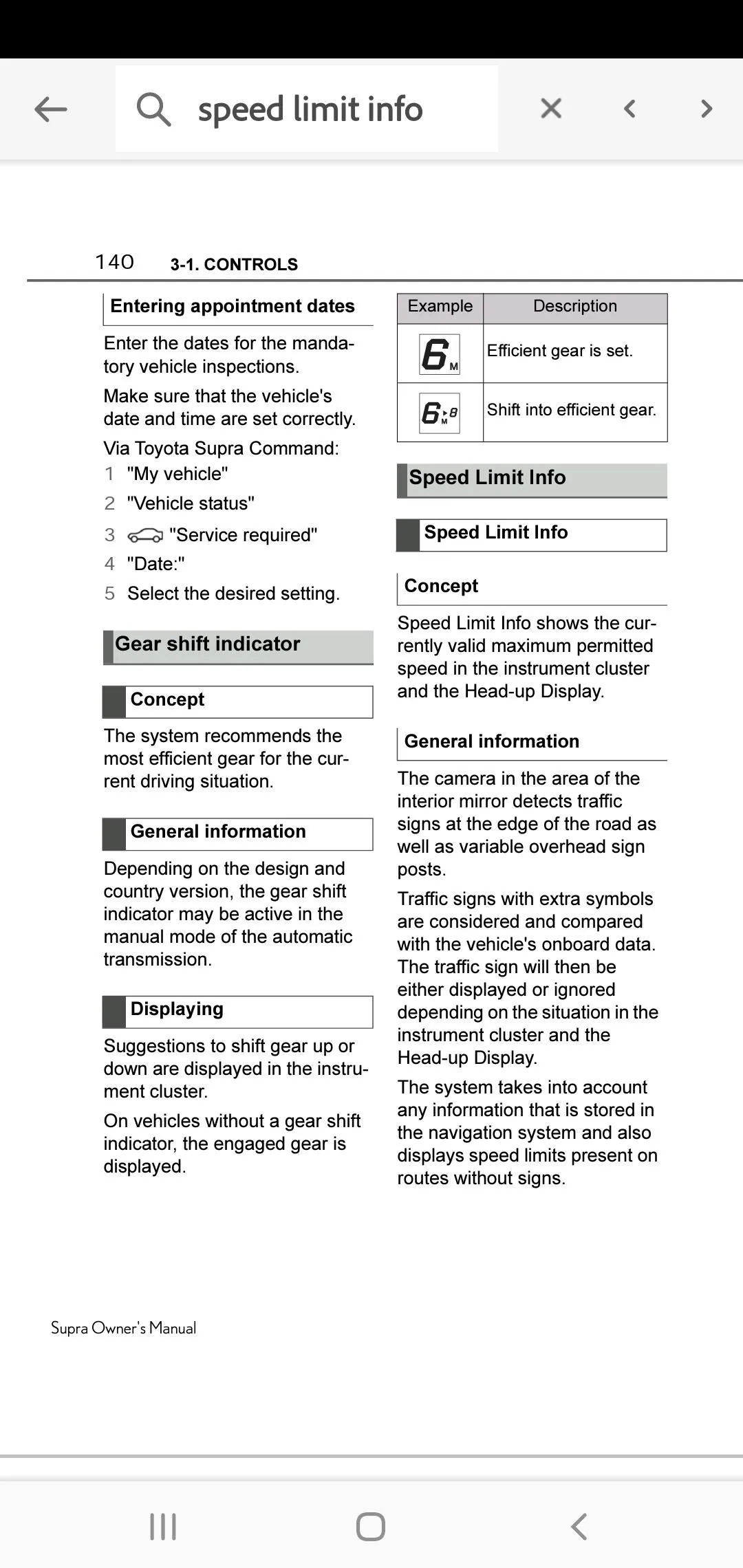

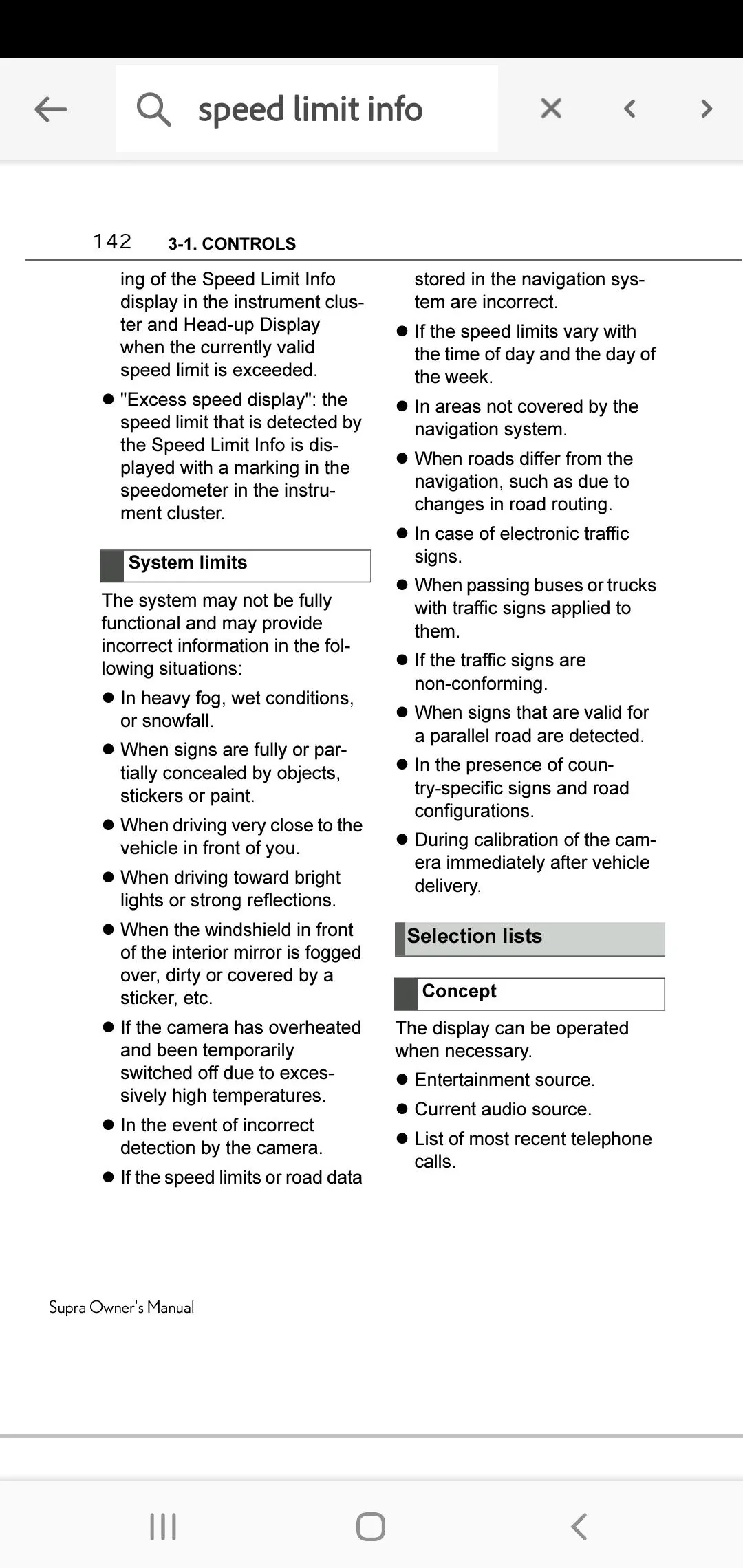

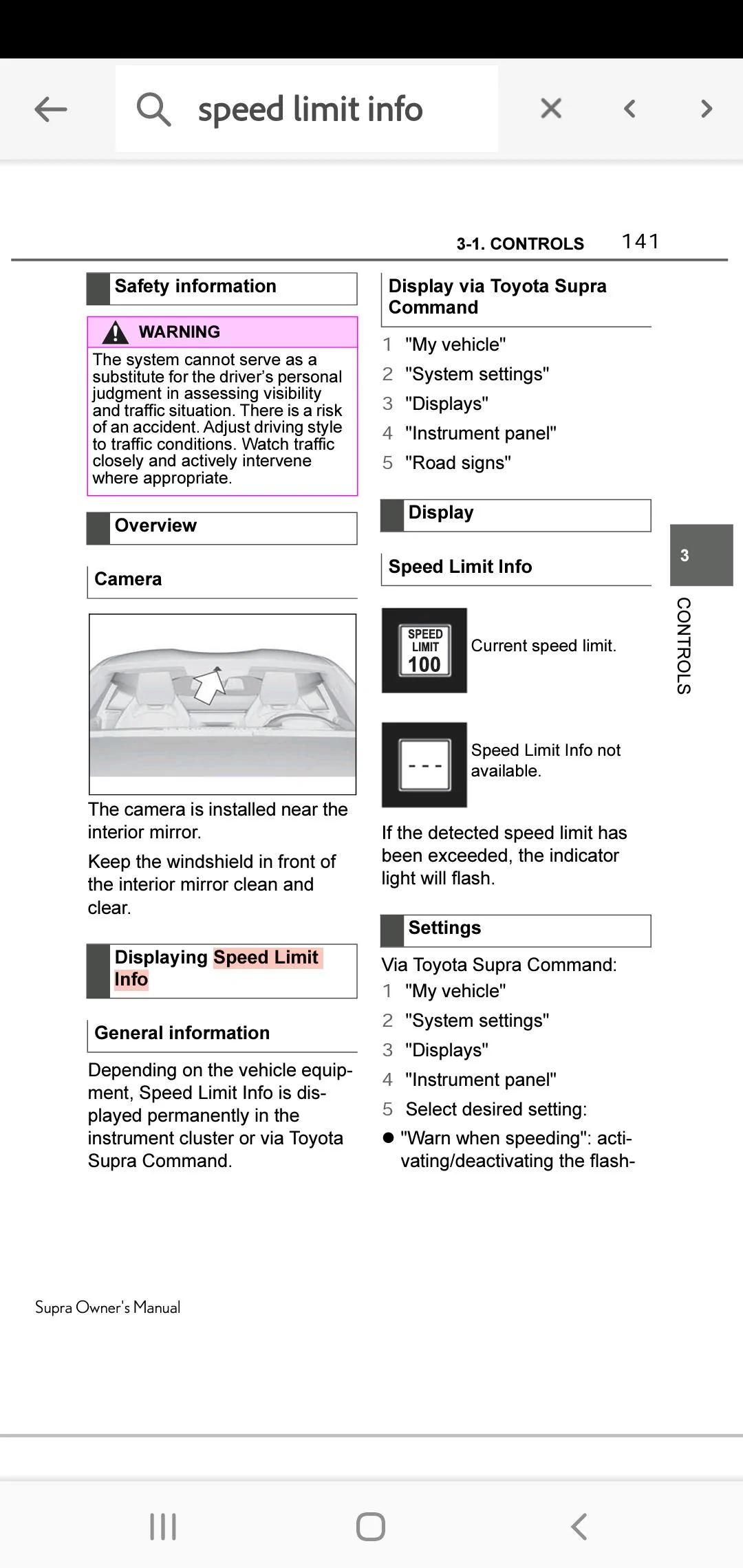

Doesn't look like it use GPS. Mainly camera and info already loaded on the nav.
Yeah my Toyota nav is turned on. Which is updated via GPS? I obviously don’t have a clue but that‘s how I thought the nav worked. I do have to switch to my Apple Carplay map every time. It’s not set by default. Appreciate the info! If anyone can figure it out @razorlab can ?
