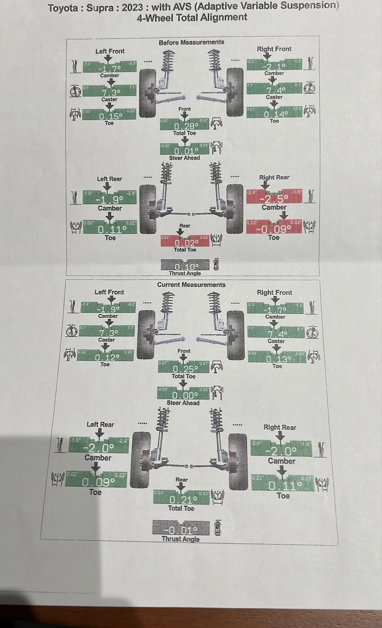

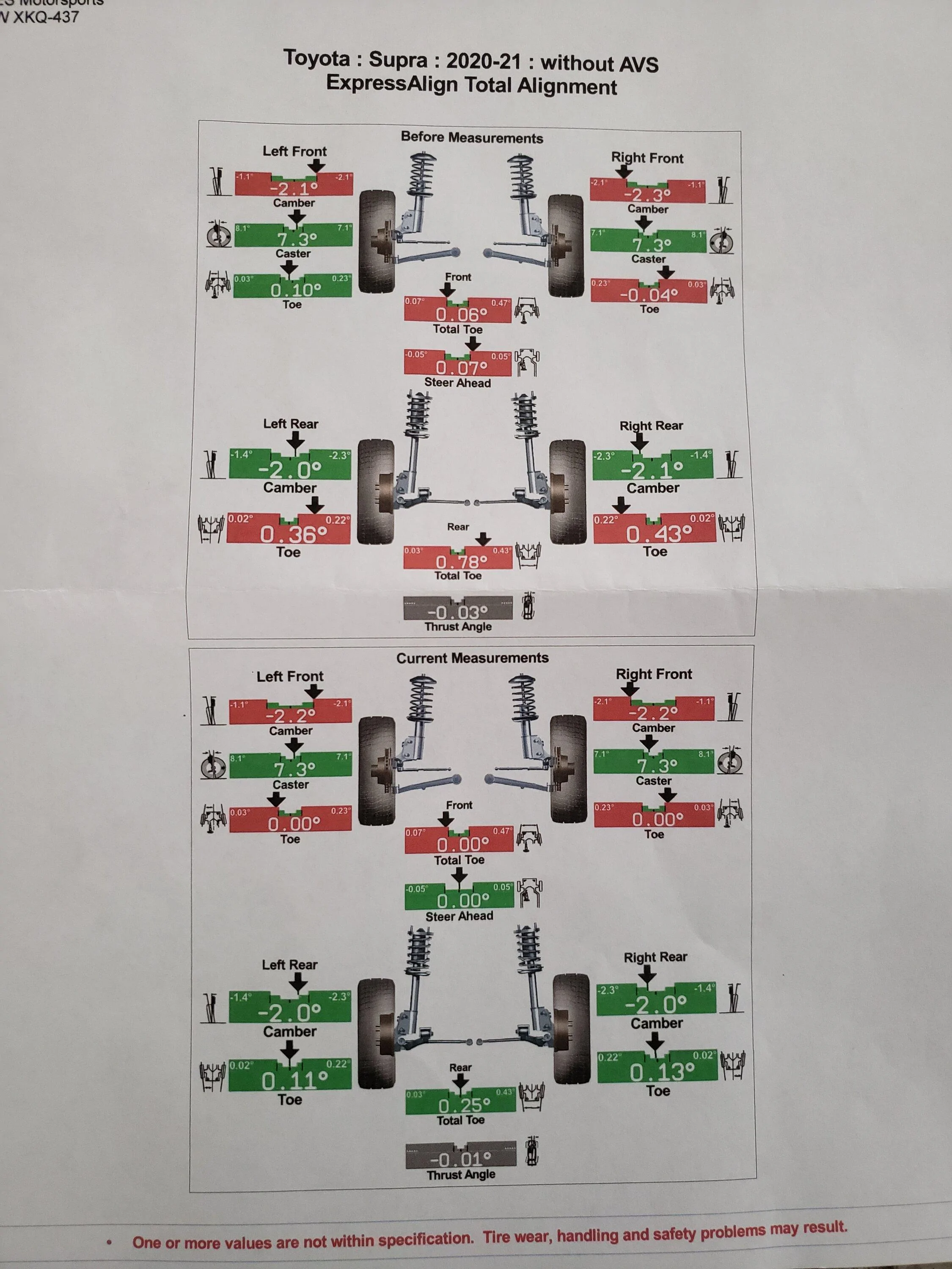

Update: Rear bump steer fully disappeared after 1 change...
So as you know from earlier, I got it aligned properly and it has improved the rear bump steer situation over mid sized potholes, more effect was in equalizing the behaviour between left and right side. But still some bump steer none the less.
I got camber plates installed a few weeks ago and realigned again a few weeks ago same 0.17/18ish deg per side in the rear, similar bump behaviour as before, maybe a little worse since I increased rear camber from -2 to -2.3 at the same time.
ANDDDD THENNNN.. I switched to winter tires, 19x9.5 square on 245/40R19 and the bump steer just disappeared completely, such a big change the wife noticed.
The winter setup is a little lighter than stock (Super speed RF05RR) and ET10, flush to fenders with the current camber settings.
Despite taking my best efforts to ensure the alignment was done correctly and maintained well in the past 13k km, the was significant inner edge wear (indicatie of toe out), but as confirmed by two different shops, before and after alignment was both toe-in in the rear. Only the first 500km when i bought the car, it was found there was very slight total toe out. I feel like perhaps there is some tire defect or PSS's tire properties just dont do well in the back of this car..
