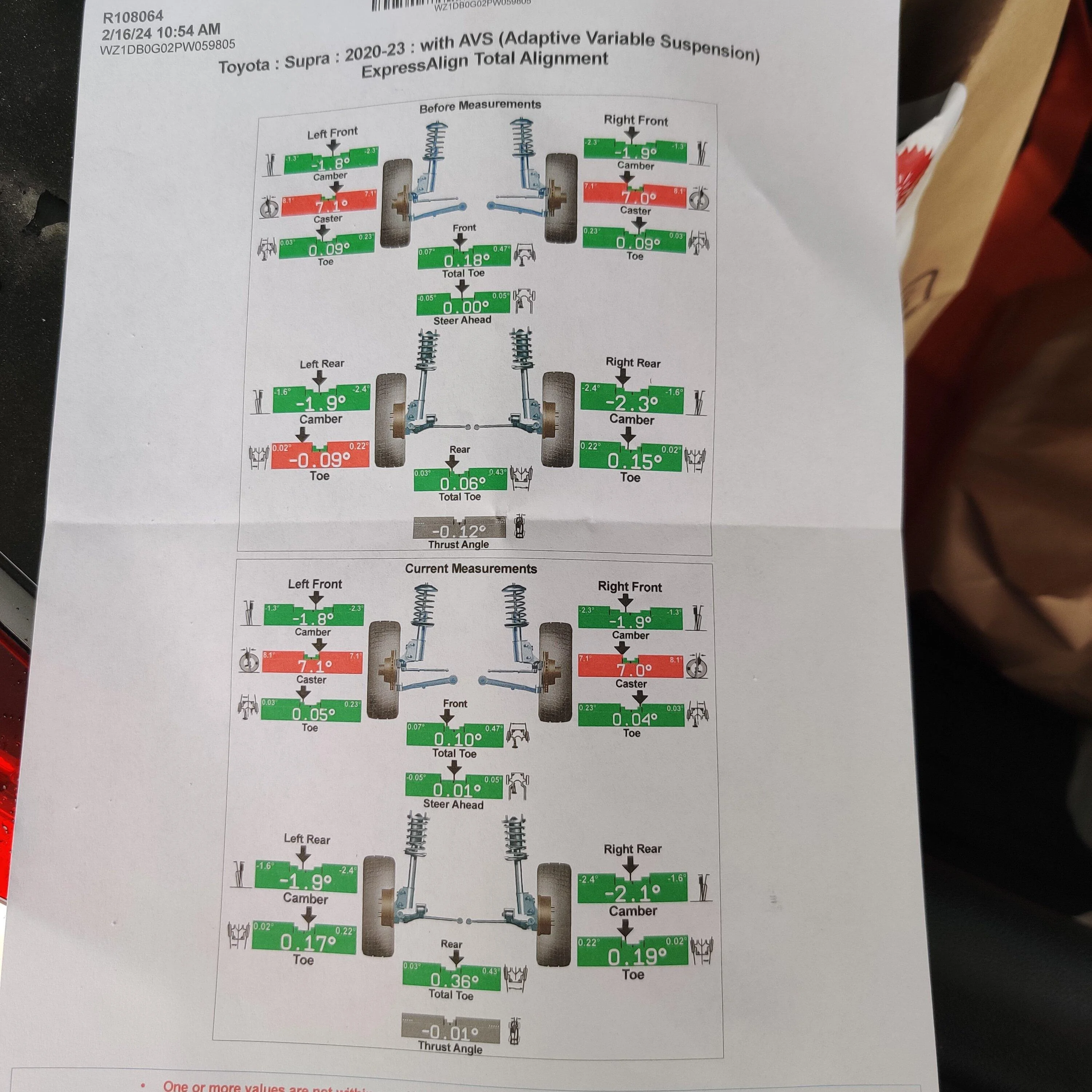

I didn't read the entire thread, but looking at your AFTER alignment and still experiencing rear wobble/wiggly over one sided bumps, chances are your rear dampers are shot.. or bushing defective.

So short conclusion is: I'm not used to rear wheels right behind my butt, or should I say soft BMW rear subframe bushings right behind my butt, and too focused on driving a new car over potholes. Maybe add in I'm too pick or sensitive:oops:
The other Supra and Z4 I drove was about the same, Z4 was a little better maybe due to extra weight. Lowered tire pressure to 32psi all around, and found it just a little better, best way to describe is the range of small bumps that will trigger it is narrower with 32psi, same conclusion from my friend who drove it for 2 hours the day before. No shipping spacers but was still good advice to check because one dust boot wasnt fully sealed with the white plastic boot retainer
Ended up having the AMOD guy and another Autox guy(who told me to buy a Supra in the first place ? ) who tracks M2C drive it around the city. They both daily small BMWs for a long time too. Immediately they were like "yeahhhhhh that's a bmw thing, soft rear subframe bushings" basically they got used to it but still notice it, told me I just need to get used to it. And it is due to where I'm sitting I feel the right rear more, when I sat as passenger the right rear felt less wobbly but left side was more, wide track, short wheelbase, and lever arm is longer when I sit on the opposite from the side that hits the pothole.
They also noted that 0.1 deg toe in the rear (coincidentally 2020 max factory limit) is not much, typically aim for 1/16" (~0.25 deg) toe in for more stability, which is near the factory limit for 2023, so I will have a performance shop align it when I'm out of break-in. On closer look it's weird how the dealer can adjust the right front camber on the supra pretty much without touching anything else on the front end, I didn't think camber was adjustable, so maybe the technican bumped the wheel pods on the alignment machine:rolleyes:
I think eventually I would do solid subframe bushings and should help alleviate the issue, but perhaps it really won't be much of an issue when I get used to it, because most of the time on the street it's fine, and when driven hard with more load on the subframe it is stable.
Thanks everyone for the quick suggestions, all helped with peace of mind! Will make an intro post today!

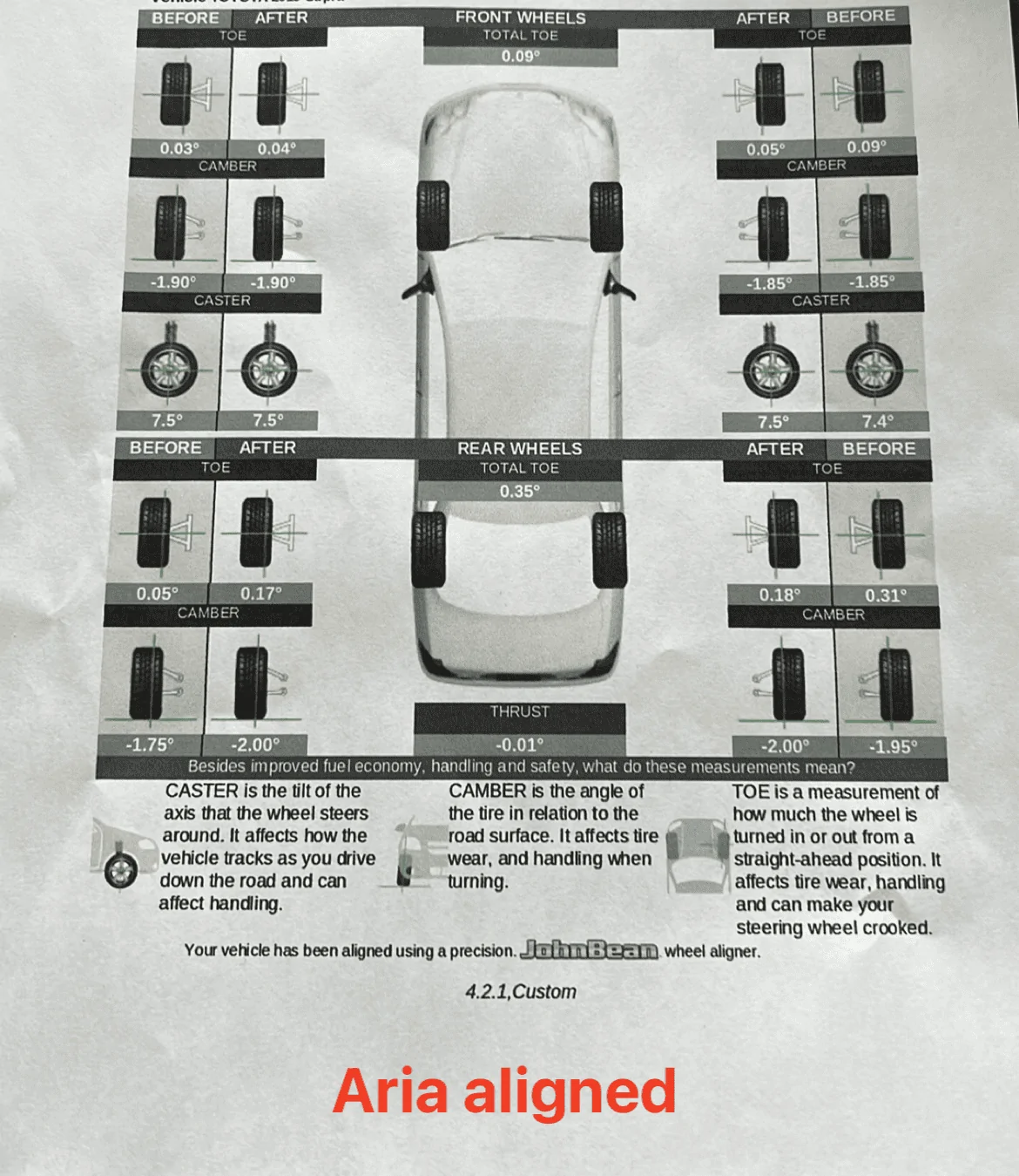

Dude I know exactly what you mean. Even on my 2023... Feels like the rear dances a little bit when it shouldn't, and at tame speeds. Had an alignment done by a Supra GT4 race team to factory specs and didn't make a difference.
I think you're right that the subframe bushings are just soft, combined with the seating position in relation to the rear axle.
I'll definitely try more toe in rear during next alignment.

I got the car rerealigned yesterday by a performance shop, one of those that ask what specs you want when you drop the car off. Because I felt the front camber was fishy since it isnt adjustable the, and somehow the dealer was able to change it so much, basically the dealer alignment was not accurate. Based on razorlab's suggestion, some research about what partial street and track guys go for on this forum. I gave the specs below:
Front toe: 0.05 deg in per side
Rear camber -2.0 deg
Rear toe: 0.18 deg in per side
The car drives fairly different, more stable rear end on the highway, a little more turn-in in the twisties, less wobbly on the right side since it was so out of spec, left sways a little more actually but much more acceptable to what i think it's normal. But main thing is left and right is a lot more consistent, right side a tiny more just cuz of where I'm sitting. Happy camper with this problem now. But a new one came up, wife's close friend's big dog jumped on my quarter panel and scratched up the clear coat after it's freshly ceramic coated....
New specs, great starting point for new supra owners:
See how out of wack Before is on this post compared to After on the 1st post, dealer machine was pretty wack.
i3igpete
May 16, 2022
45
1,279
1,543
Chicago
2023 3.0L 8AT
the single toe out in the rear was definitely no bueno, and as tail happy as this car is, I don't want to play with zero or toe-out either until I get more seat time on track.
front toe, monkey see monkey do. will re-evaluate after a few days this year. i trust @razorlab's and Jackie's judgement
edit: links to a few other threads with similar suggestions i was reading earlier this week
https://www.supramkv.com/threads/track-alignment.2951/
https://www.supramkv.com/threads/supra-bump-steer-fix.6816/post-103265
https://www.supramkv.com/threads/recommended-alignment-specs.17003/post-263630
