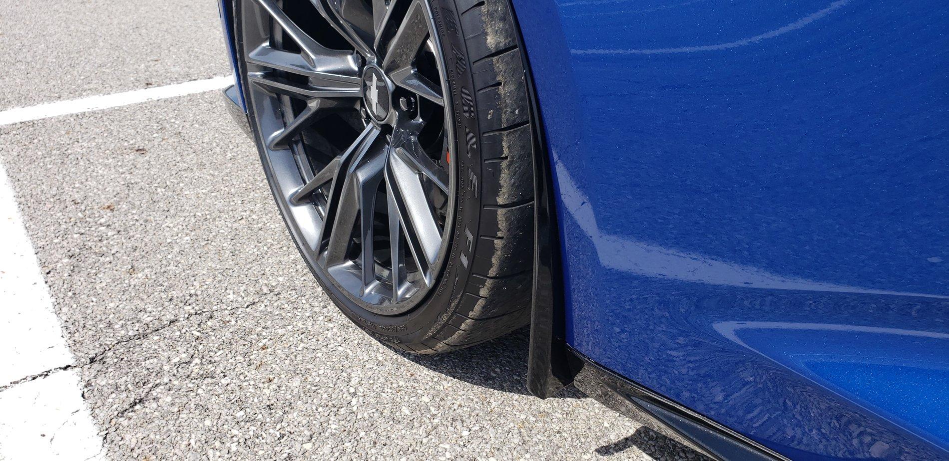

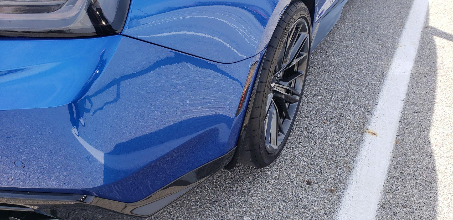

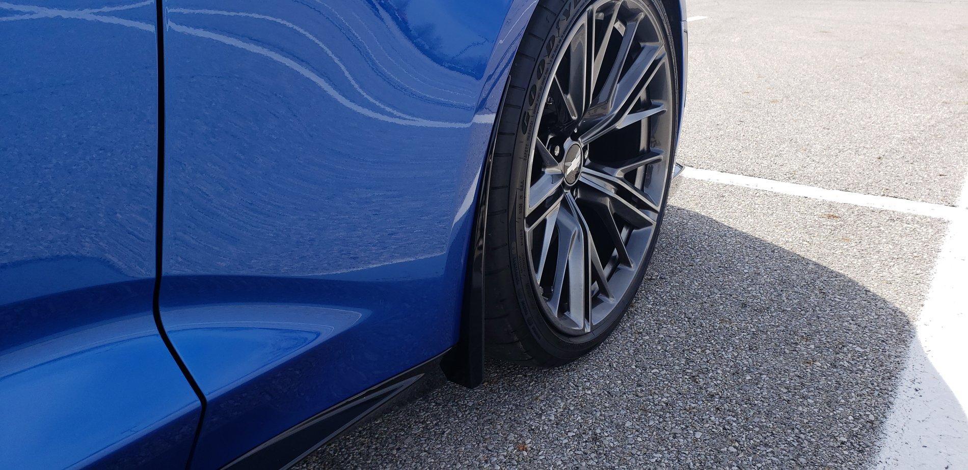

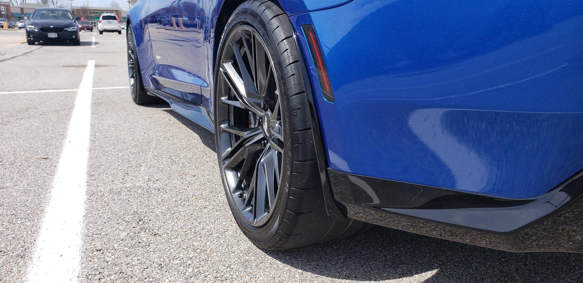

The guards look good installed....Are those 13mm spacers the ones came with kit for the rear?
13 mm spacers is for the wheels. i have my wheels with spacers on.
for the rear splash guard you will use the provided white spacers they give you on the package.

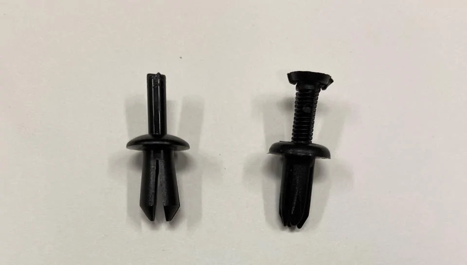

The difference is the range the push rivet can clamp -- the BMW rivets can only handle the thickness of the fender metal and plastic wheel well liner, and if you try to add a mud flap it won't work -- the rivet becomes too hard to push and you risk cracking the paint on the hole in the fender. The Toyota part # I listed is meant to clamp together a thicker range of materials and is just about perfect for adding a mud flap into the mix.
I have a bunch of these rivets and can take a picture if it helps.

OK, here is the BMW rivet shown on the left and Toyota 90467-05090-B1 on the right. The BMW rivet starts flaring out as soon as you push the pin in a bit, and really only can grip a couple mm of materials before the flare. The Toyota rivet flares out only after the pin is pushed all the way in and can clamp much thicker materials together.

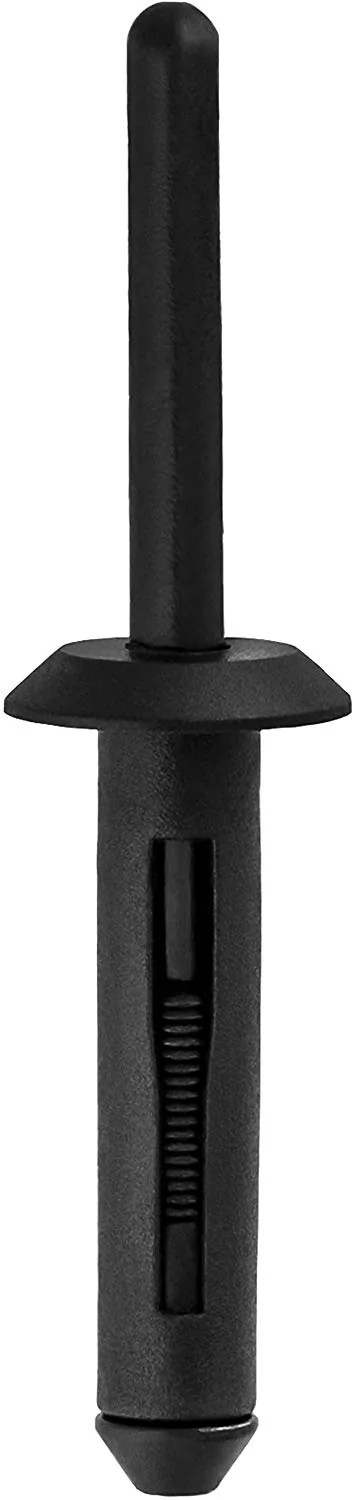

What about using this type of plastic pop rivet instead?
I don't think those are easy to "reverse" so I might be wary of using that type. I'd want to make sure I could easily remove the rivets and mud flaps if desired.
They are actually quite easy to remove...you just have to replace them with a new plastic pop rivet which are fairly inexpensive...

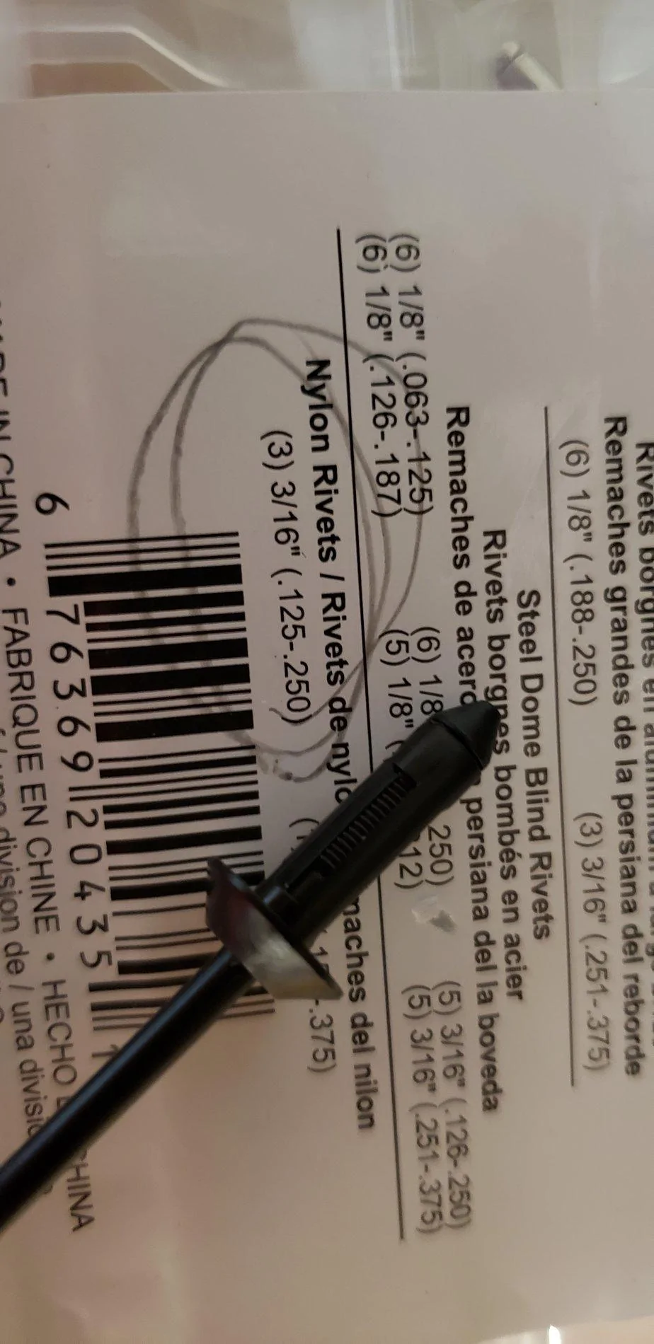

Okay everyone to create less confusion..here is the right size of rivets if you want to use the ones from autozones..
I put them on the car. Perfect fit
thx for posting..glad to hear they worked!
