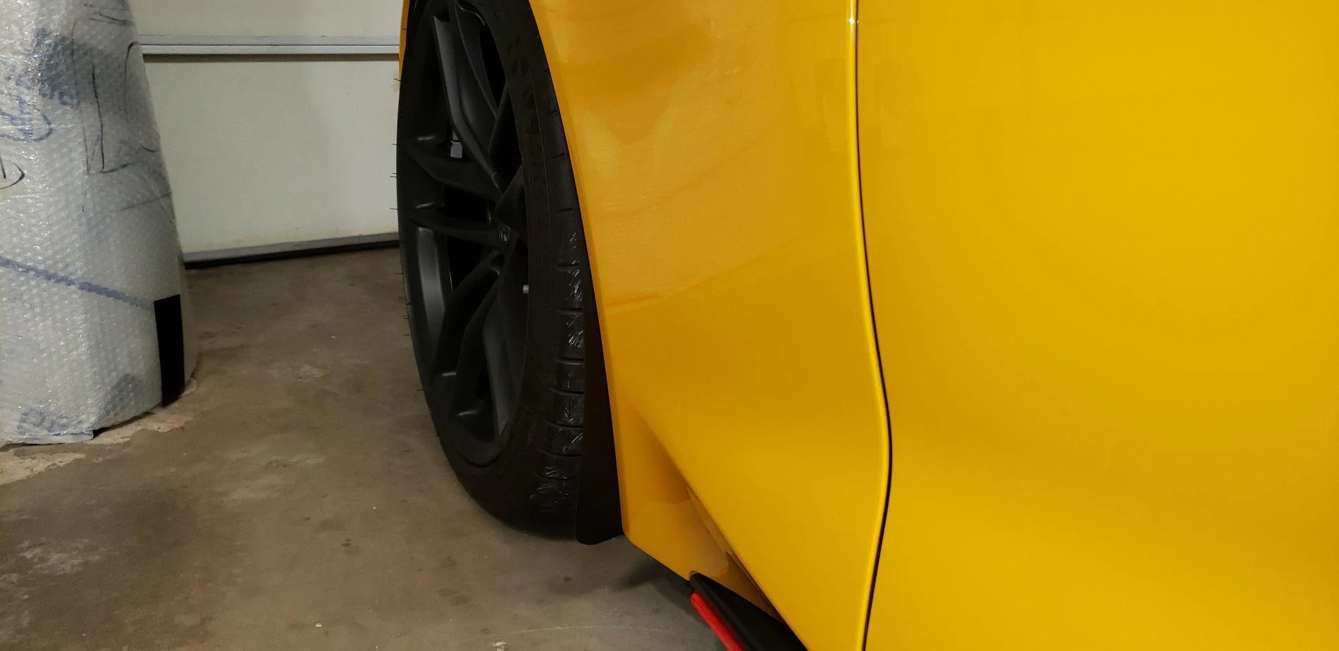

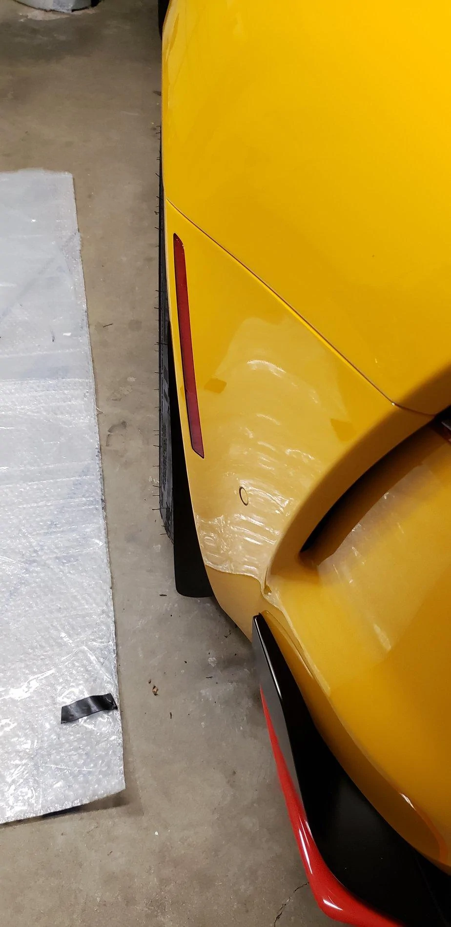

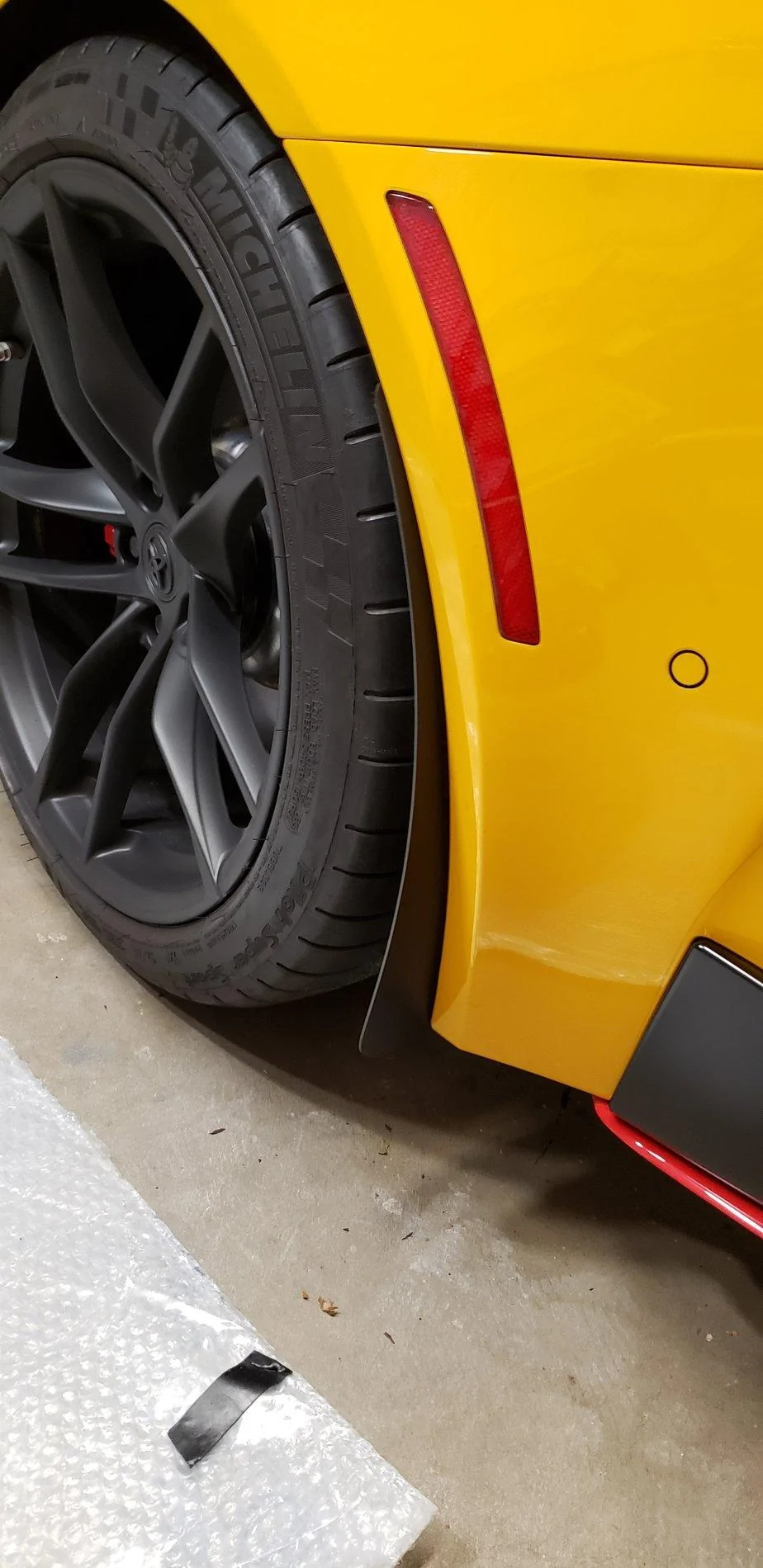

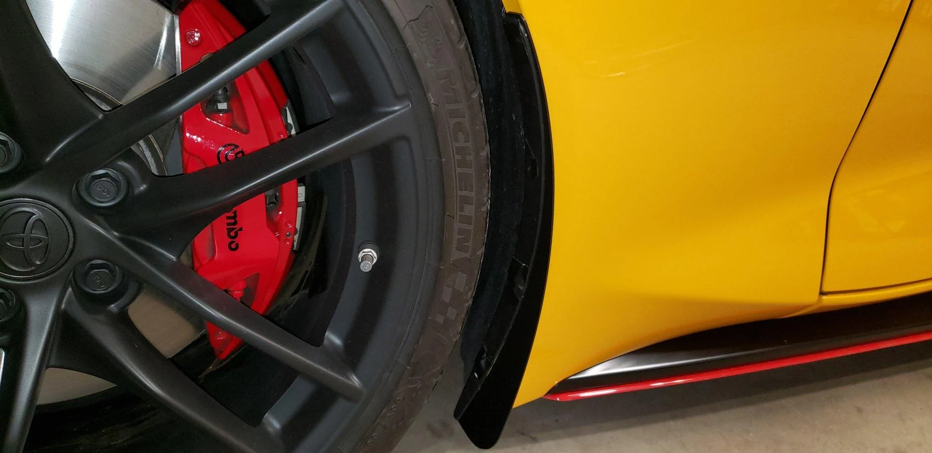

Heres mine installed from zl1addon splash guard..
As mentioned previously, the front splash guard hardware is not strong enough to bite on the rivet house.
Its recommnded to buy new rivets with longer tail so it will reach down to the fender.

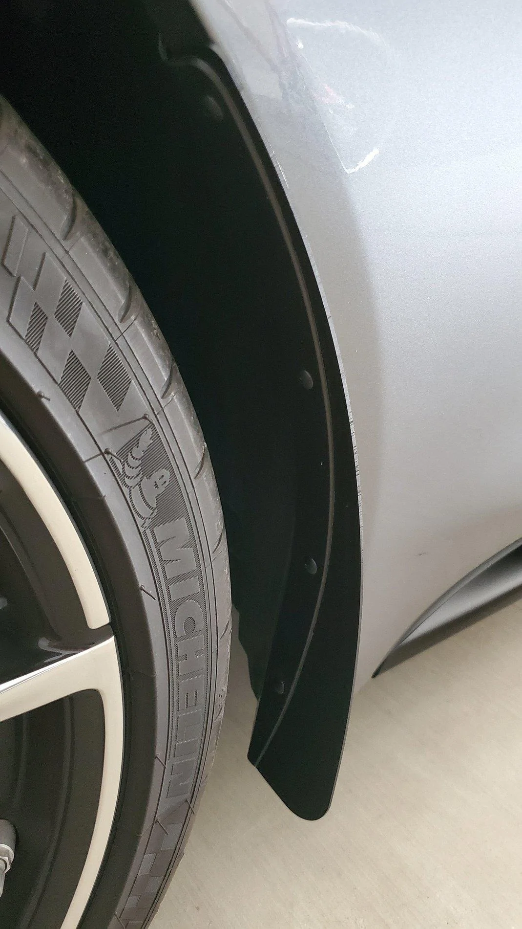

Installed ZL1 Splash Guards today...I actually purchased new bmw plastic push rivets for front guards and they worked very well and are extremely secure ...I would recommend using new push rivets than using the provided screws that reuse old OE rivet bases...

The problem with those rivets is that they can crack the paint around the fender holes when you add another layer of thickness (splash guards) to be clamped down, since they flare out aggressively. These are meant for a very specific thickness range (stock setup) and for the normal range, the pins are easy to push in. Once the materials are too thick they take a lot more effort and that is what can enlarge the holes and crack the paint.
I posted some Toyota rivets above that have the same diameter, but flare out over a wider range of thicknesses, and the pins push in with low effort (you can do it with your thumb). These would be a lot safer to use.

I disagree....The flaps are quite thin and personally I don't see an issue...they weren't that difficult to push in and they worked quite well.. but thanks for all your input! :thumbsup:

I have seen it happen on BMWs when people reuse the stock rivets for flaps and body kits. These flaps may be thin enough but beware if using flaps thicker than ~ 2mm. You'll know it's a problem if you can't easily push the pins in.

Flaps are ~1.5mm thick...
I was more concerned with ZL1's instructions that called for re-using the old push rivet bases and then securing them with screws they provided...
I think perhaps the best option would be to use the 5mm plastic pop rivets that tedan628 used...that said, I'm comfortable with using new OE push rivets...
