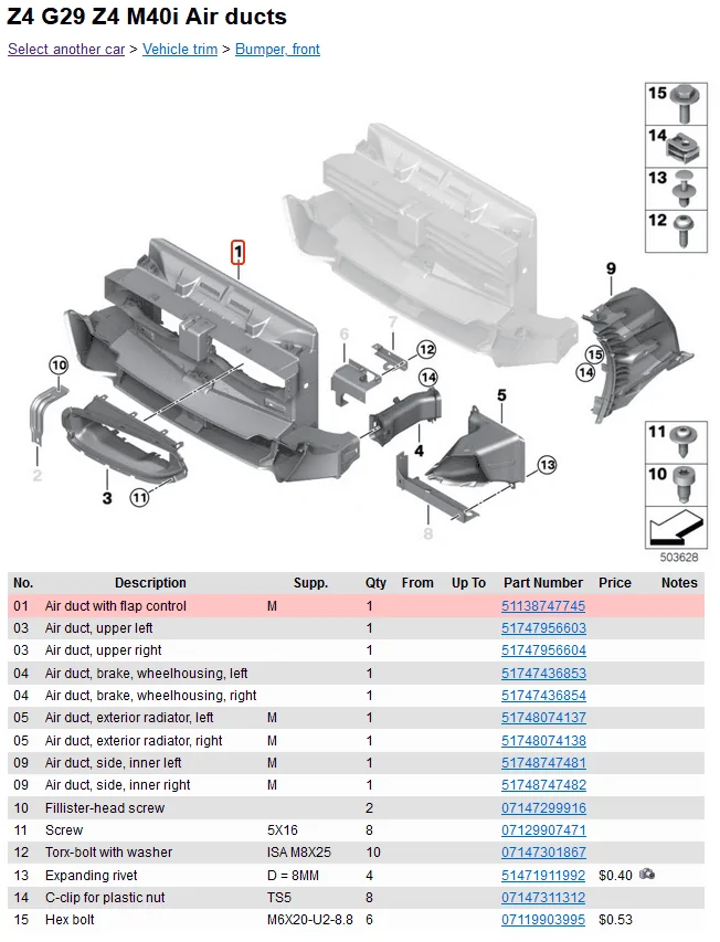

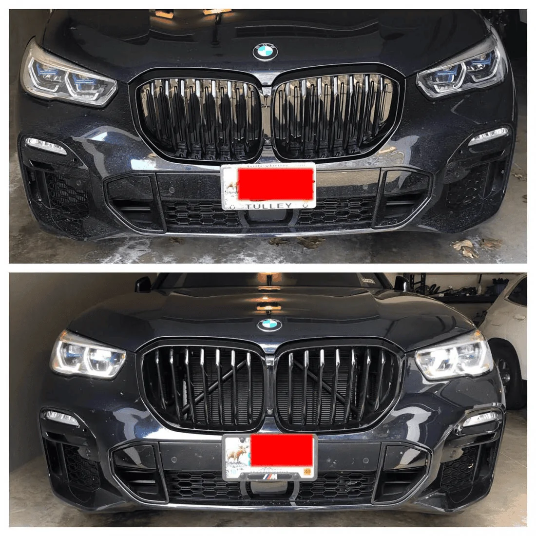

Yeah I noticed. Any idea what radiator flap means? Asked a bunch of dudes no one really knew. it says OPEN and the other option is ORIGINAL/OEM.
Its for the active grill shutters found on newer BMWs.
The Z4 has them.
The Supra doesn't have them at all.
Might get 2 DTCs CD9203(left)/CD9204(right) if you use the option.
