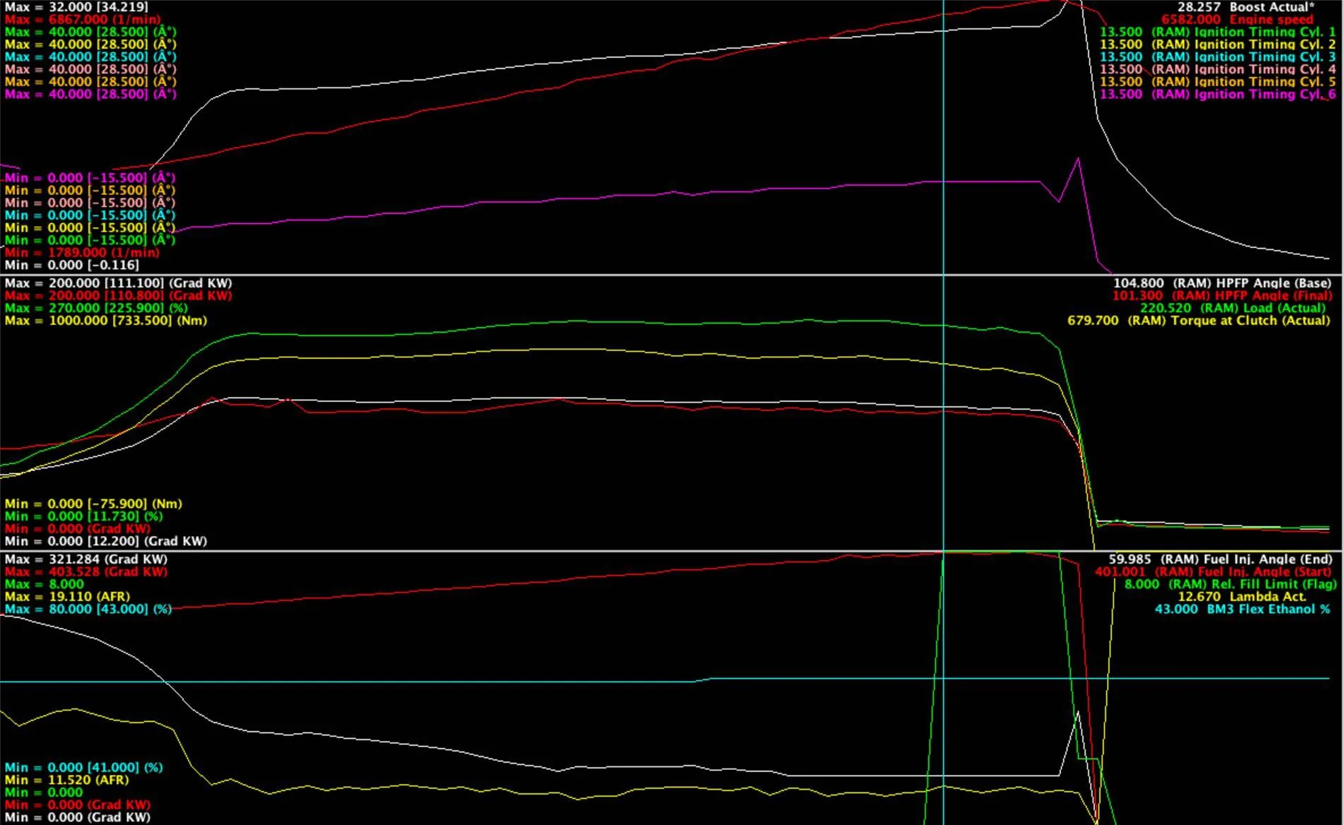

im curious to see how it goes. If it can make 600-700 whp with just the HPFP and turbo, seems like a reasonable alternative. Looks like there's some dyno tesing coming out... Time will tell I guess.
Shoup tuned this HPFP only car to 650 whp
But on Shoup’s live stream he said multiple times that the absolute limit of the stock injectors is 600 whp alone and you won’t cross that line with just an HPFP and a turbo upgrade on E30/50 etc..
so… ?
