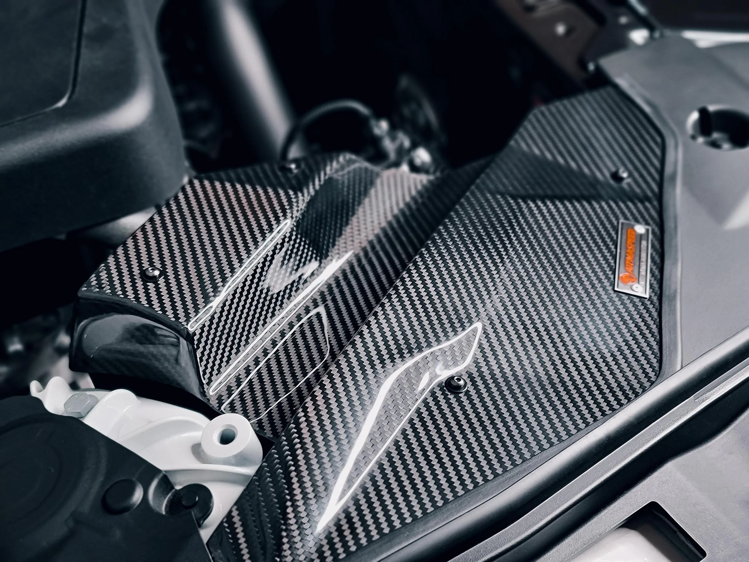

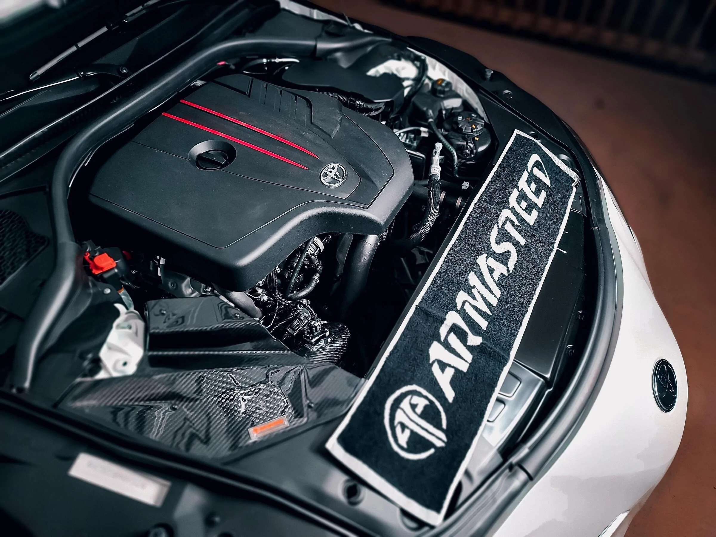

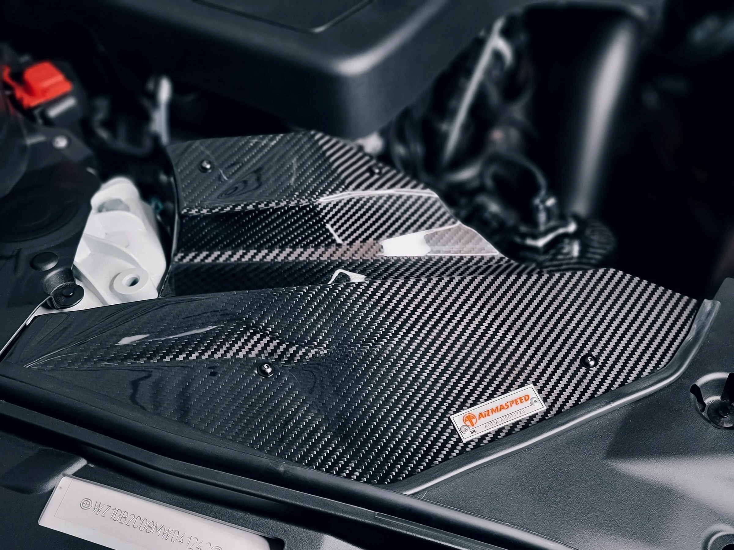

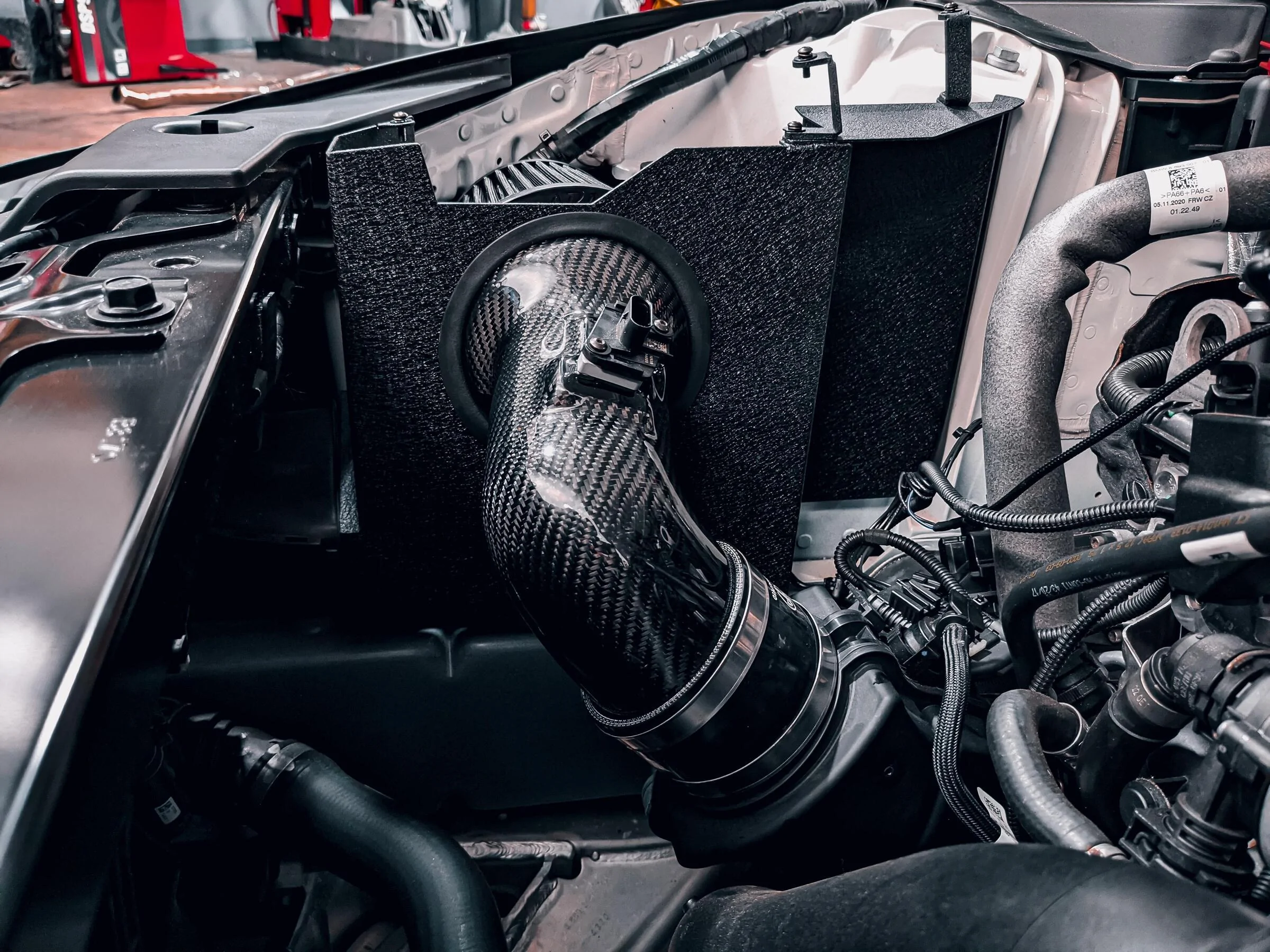

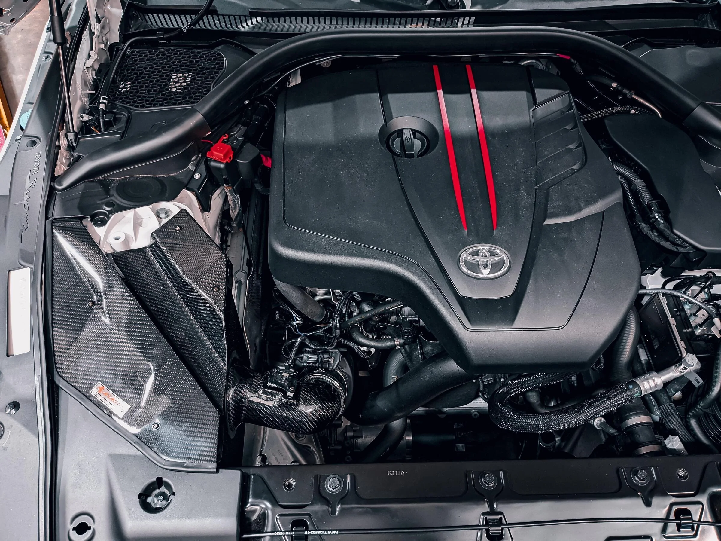

Armaspeed Carbon Fiber CAI: @ARMASPEED

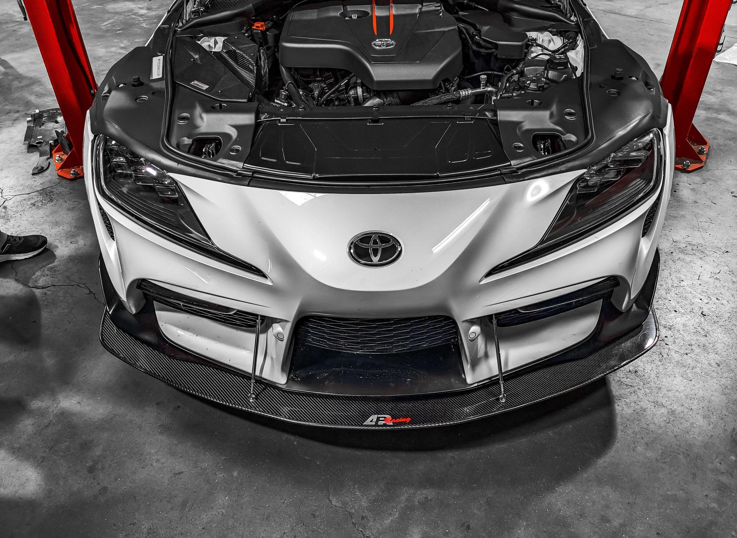

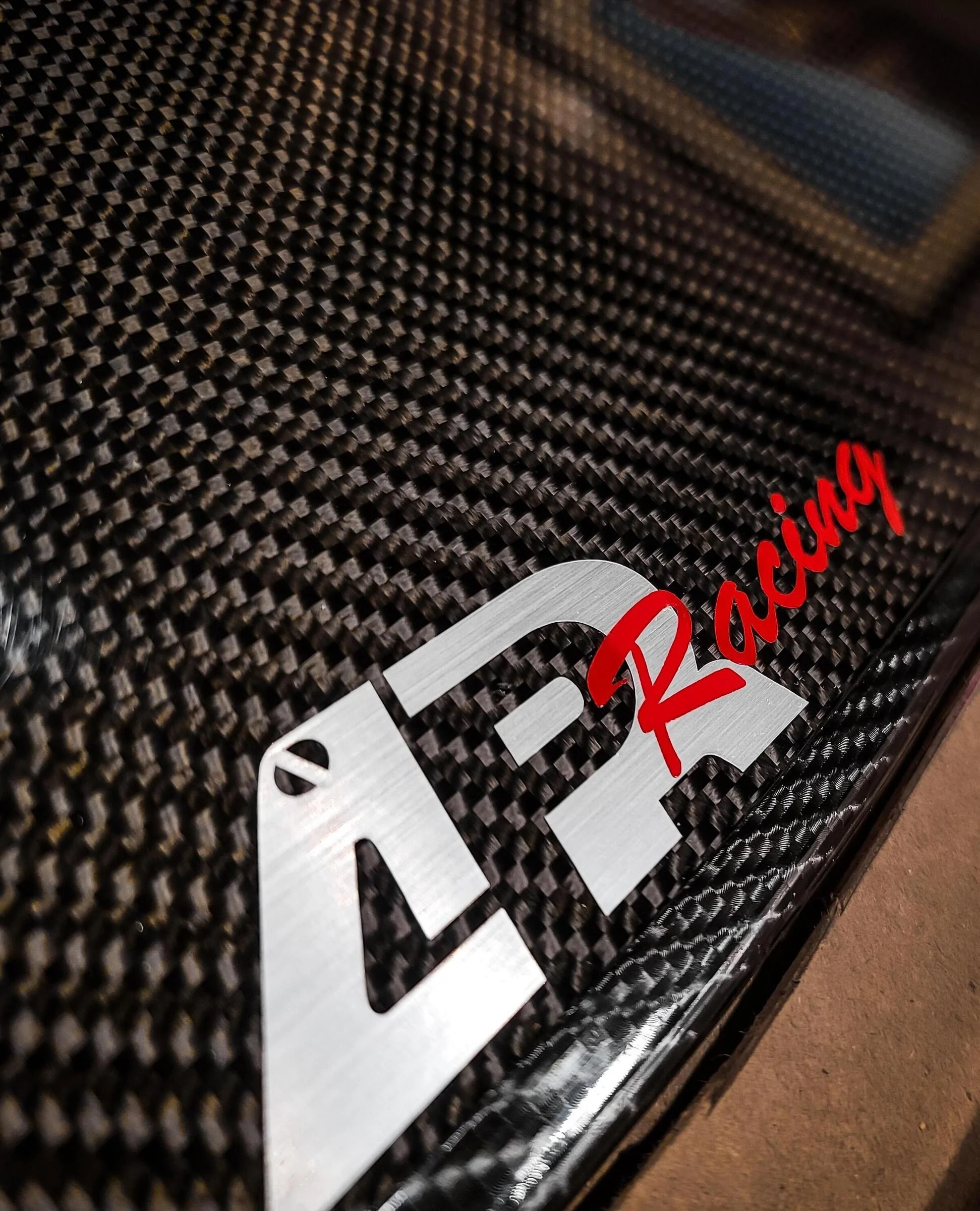

APR Carbon Fiber Splitter:

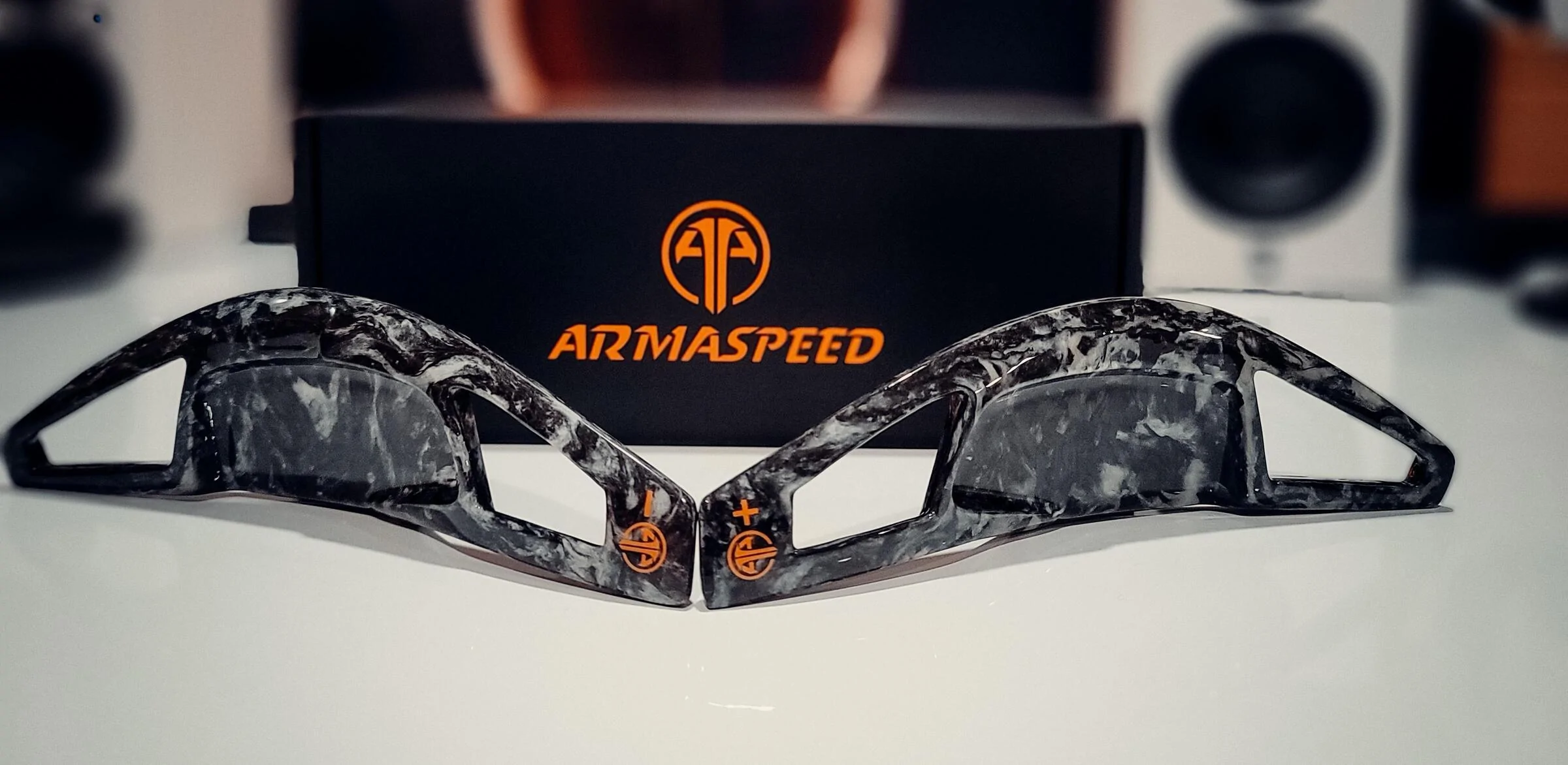

Armaspeed Forged Carbon Fiber Paddle Shifters: @ARMASPEED
