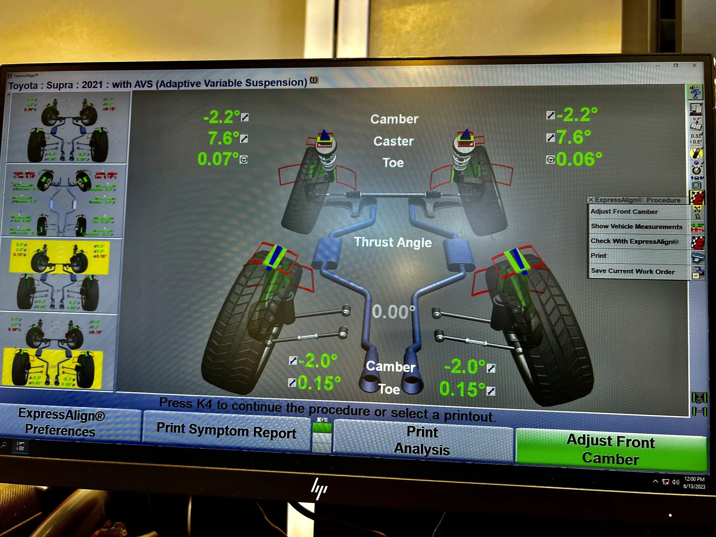

For my 2023 MT. Had the H&R Springs installed (have stock wheels and suspension parts) by a performance shop. If I center the steering wheel, it drives straight, and then let go, it will always start to drift right. Even after swapping the front wheels left to right. Here is the latest alignment sheet after a few weeks of the springs installed. They also checked the front right spring to make sure it was seated properly. Maybe I need to ask them to check front roll center ? If that needs adjusted, will that require aftermarket parts?
my alignment shop was only able to get everything to -1.5 all the way around.

This is what I’m saying. If the camber is that inconsistent from the factory to the point it’s enough to cause a pull, that is a car-specific issue and not “lowering issue”. Also, when I was deciding my suspension choices I inquired with others here and determined we do not have significant camber gain when moderately lowering our Supras. My factory spec in front was 1.8 and 1.9. If that had gone to maybe 2.3 to 2.5 after lowering I would maybe considered not adding camber plates. However, the consensus was minimal camber gain. Like 2.0 to 2.1 is the most anyone reported if I remember correctly. So I added camber plates as well and now run 3.0 in front and 2.5 rear. It’s a conservative set up with slightly less than an inch drop but I (and most others) have zero issues. My dealer has no problem aligning the car and it doesn’t need all the aftermarket parts you talked about to do so, the car tracks straight as an arrow, I really can’t tell a difference in ride quality, and most importantly the car is an absolute beast for autocross which was my goal (I consistently pax top 3 with my local club and top 5 to 10 when I go to the occasional bigger regional type events).
I’ve decided I can’t live with the pull. Are you saying that camber plates alone should be able to fix my problem?
No. I seriously doubt plates would make any difference since your camber is already consistent on both sides. Camber plates only benefit those of us wanting/needing 2.5 or more camber for autocross and track purposes. Your alignment specs seemed good to me. The castor is higher than I’ve typically seen but that’s also consistent side to side so I don’t see how that would cause a pull either. Sorry but my alignment knowledge is limited to aggressive autocross/track settings but I’m not knowledgeable enough to diagnose why a car would pull.
I think someone else mentioned trying to find a race shop. I think if I were having your issue even after confirming good alignment specs I’d look for help there. Good luck!
