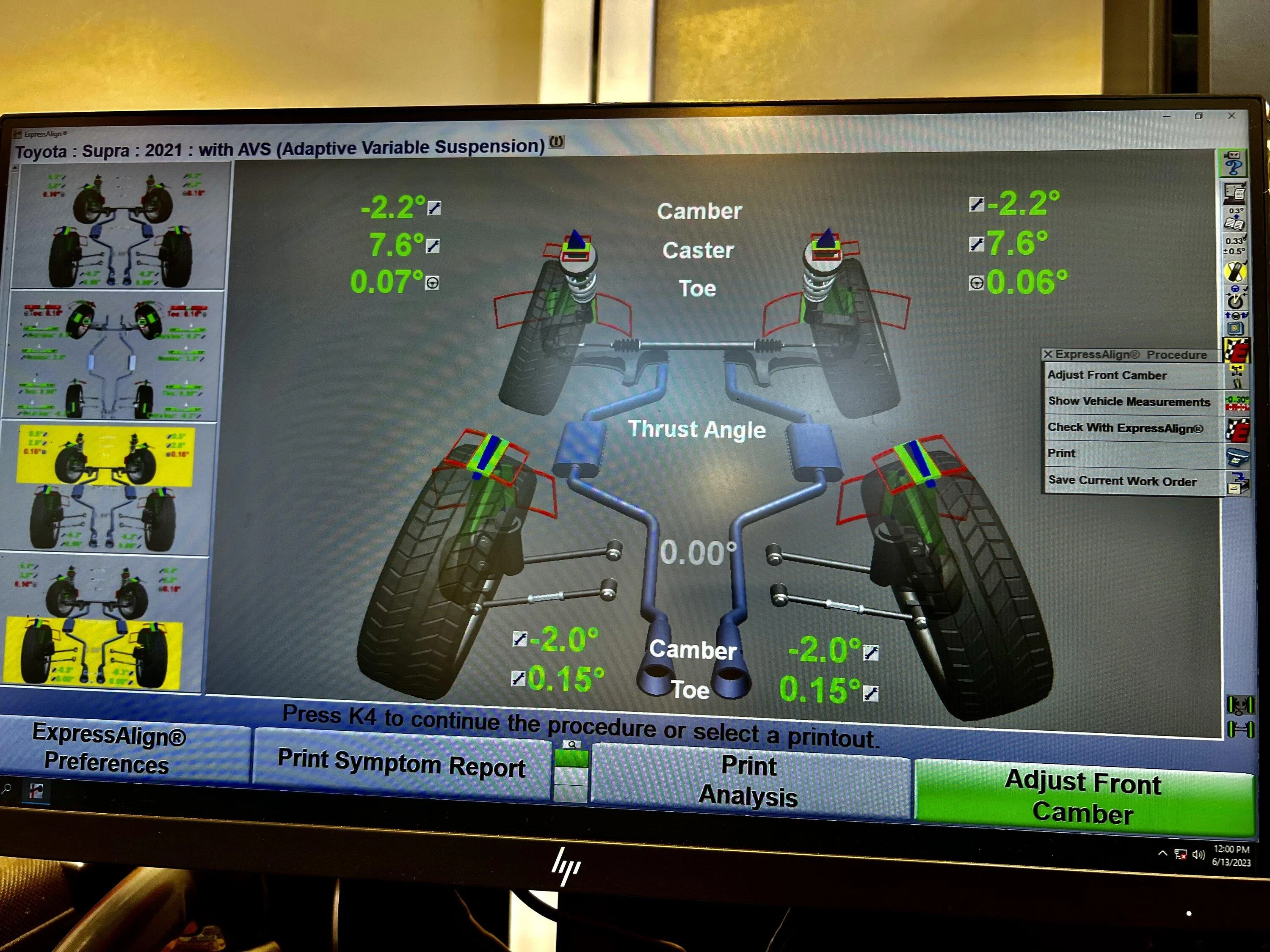

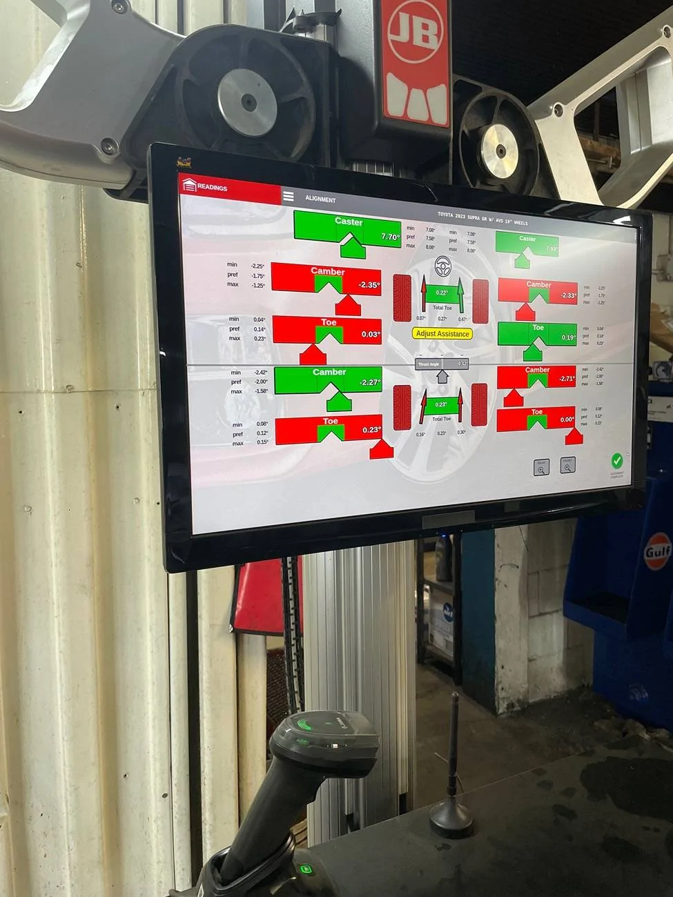

the city I live in has the worst roads in North America, only drunk people drive straight. After driving over a few large dips at speed and hitting some bumps (that are an entire lane wide) When I examined the issue the alignment had changed to this:
8,823
17,306
.15-.20 toe in on both rears will have that car going straight on WOT.
