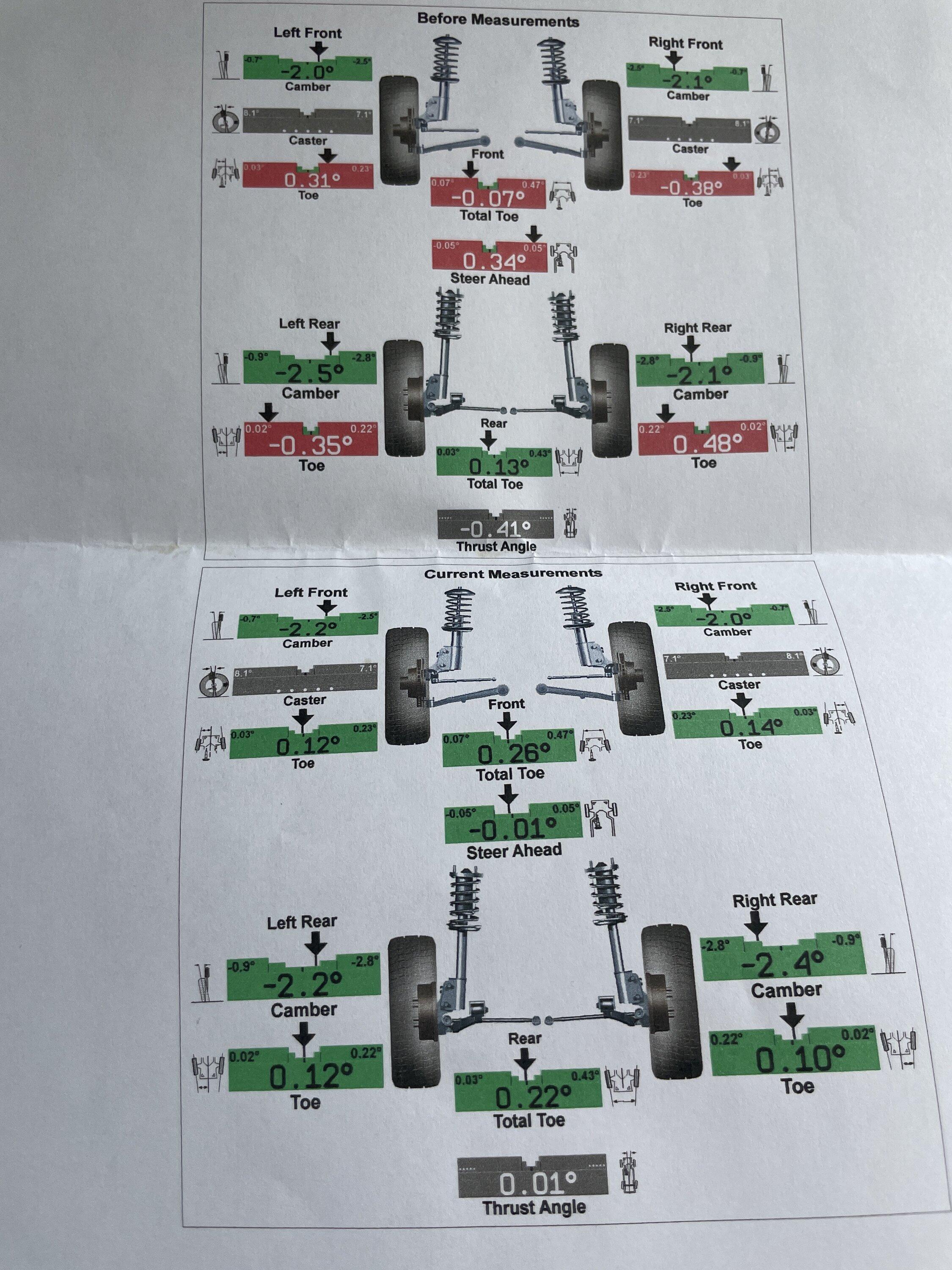

The top is factory alignment. Bottom is alignment with springs and spacers
Maybe reduce the rear camber to -2.0 to -1.9 and maybe 0 out front toe. On my car with springs camber plates and sway bars I have my Front -2.2 and rear -2.0
