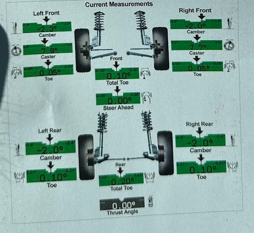

When your springs were installed, did they torque everything down with the suspension loaded, or unloaded?
If it was unloaded, there's probably preload on your sway bars and knuckle bushings which can cause some less than desirable handling characteristics. Make sure that things were torqued down with the suspension loaded, and torqued down to the right spec.
Further, the great speed shop in your area should be able to get you a side-perfect alignment.
There's nothing you can do about front camber since it's non adjustable from the factory but those side to side differences in Toe specifically, are bigger than the numbers suggest.
Any shop worth their salt should be able to line those up side to side, especially on a car this new that doesn't have worn out components.
Your rear camber settings specifically, and both your front/rear Toe settings just aren't really great for this platform.
Having almost 1 degree more negative camber in the rear than the front is just wrong on this platform as well.
My alignment for example, on a '23 with Eibach Springs
the camber in the rear is like that because of the 11 1/2 inch wheel with the 305 tire, plan to get camber plates for the front, but don’t really need it. I’m gonna drop the tire down to 295 (rubbing purposes), although it doesn’t rub that much. but to be honest, the car kind of moved around a lot prior to any of this compared to my other vehicle Performance wise they’re not even close to being in the same class, although I believe the super should be superior to my other car, I only posted the alignment sheet in case any professionals who know what they’re talking about could see if there was anything wrong but as far as I can see all of the Toe is in spec.

Lowering springs + 20” wheels is the fast track to ruin how your car handles. Guarantee your geometry up front is out of spec from the drop + offset change. Likely preload incorrect as mentioned too. Your new alignment is whack but a lot of that’s a stock hardware limitation. Want minimal even toe in. Even camber side to side / reverse the front and rear etc
