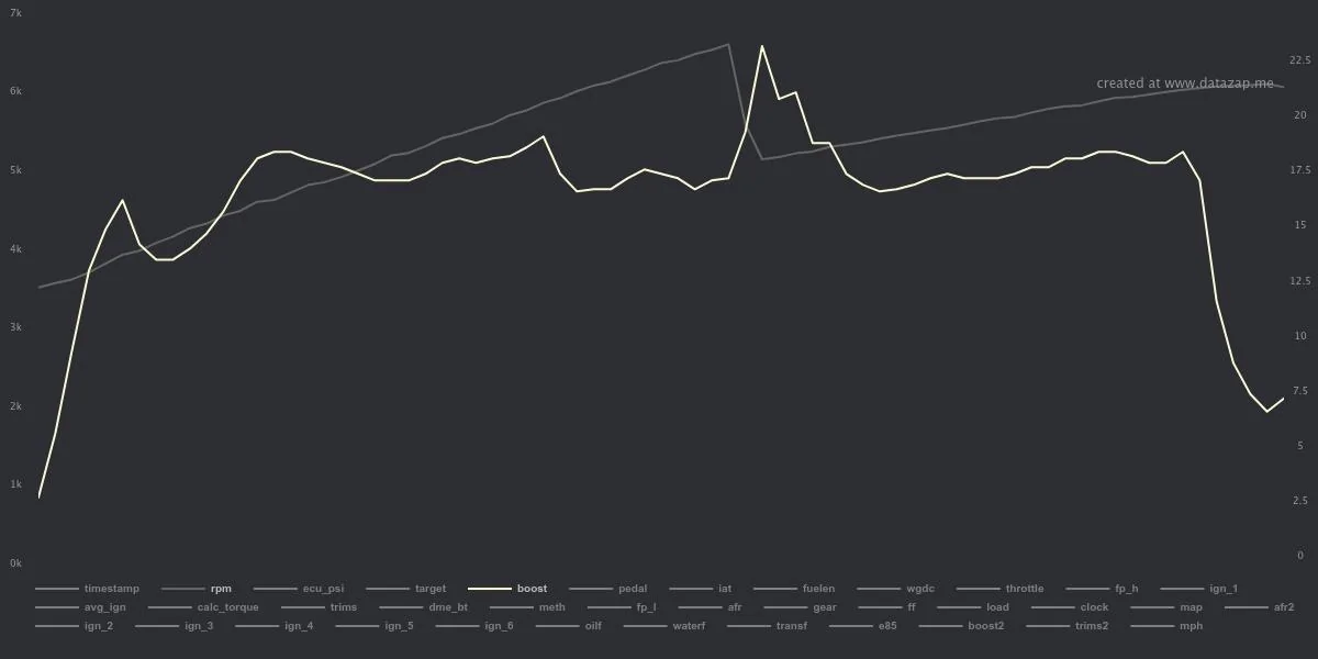

I’ve been trying to run map 1 but car seems to break up top . So I did a couple Map 0 logs and see a boost is higher than normal ..
I’ve bought this car at auction and was wondering is it possible this g20 m340 was tuned ?? Down pipe looks stock etc ..
please let me know thanks in advance see
Logs !
boost looks a little all over the place, but I need the actual datazap link and the log to be public

Here are two attached logs on MAP zero
I figured Id post here since the m340i runs higher boost like the Supra AT
EWG connector comes in tomorrow any settings like FF, map I should run ?
usine 94 octane ( sunoco stock DP , bms intake)
I appreciate the help !

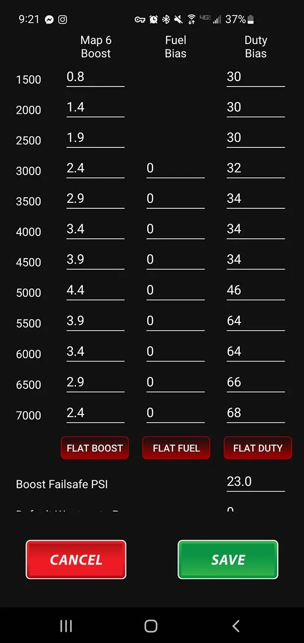

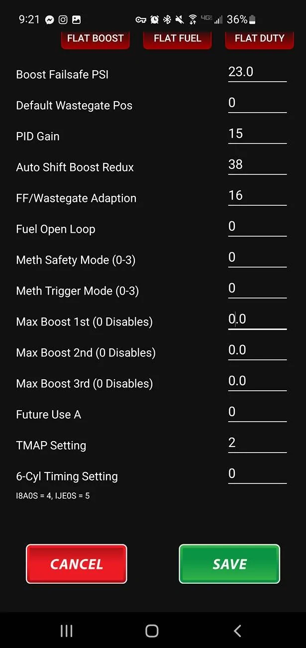

now that looks like a catless MT log lol.
Try these on V24 firmware only
