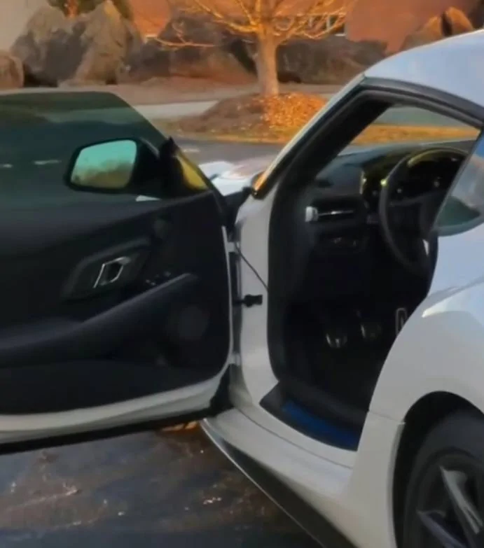

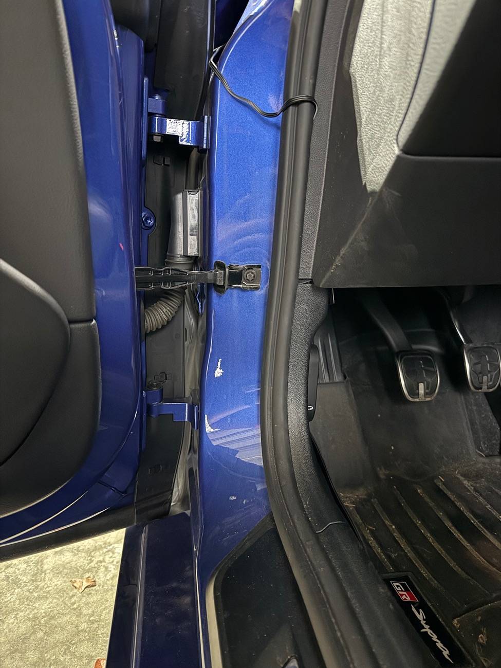

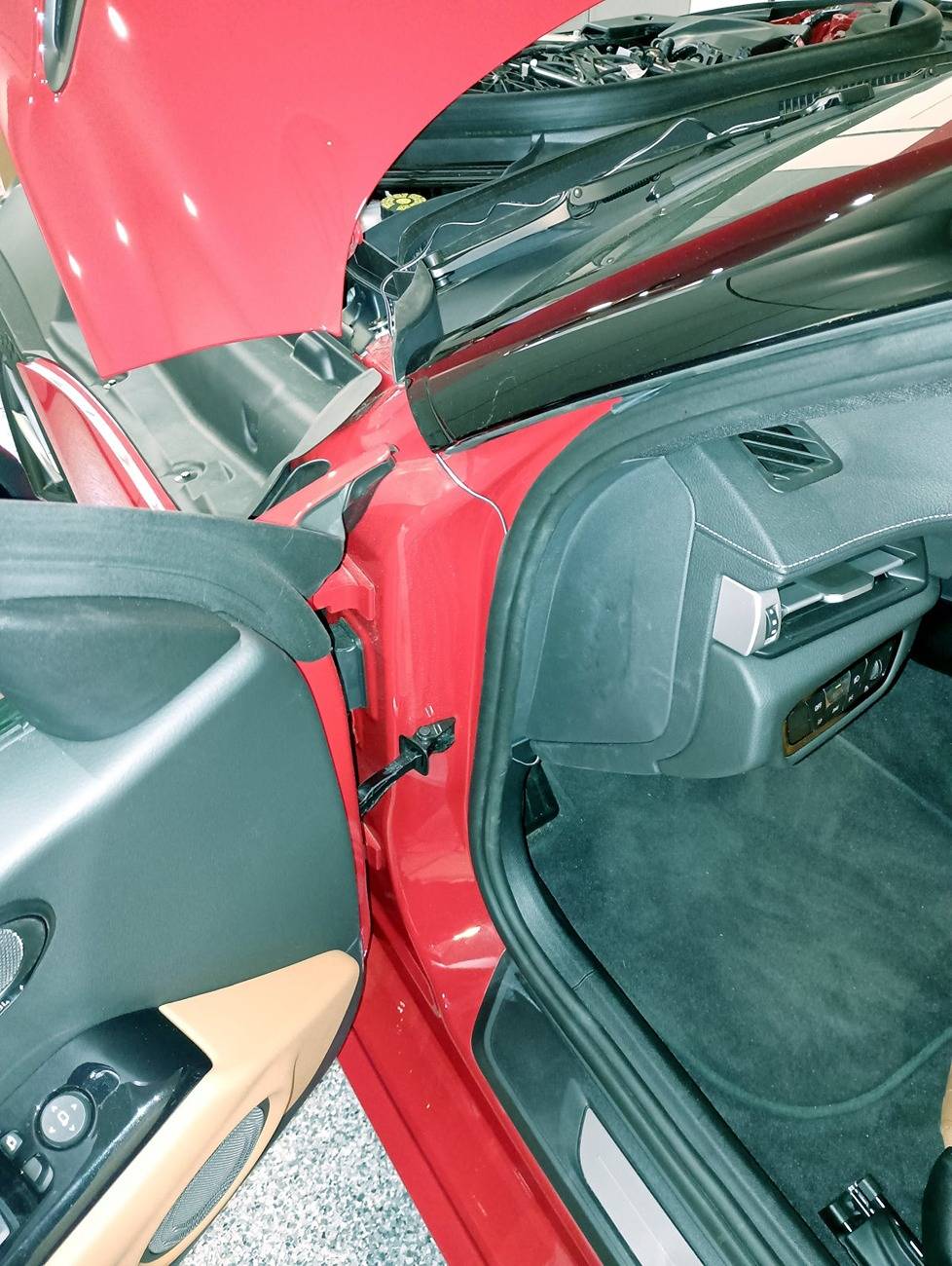

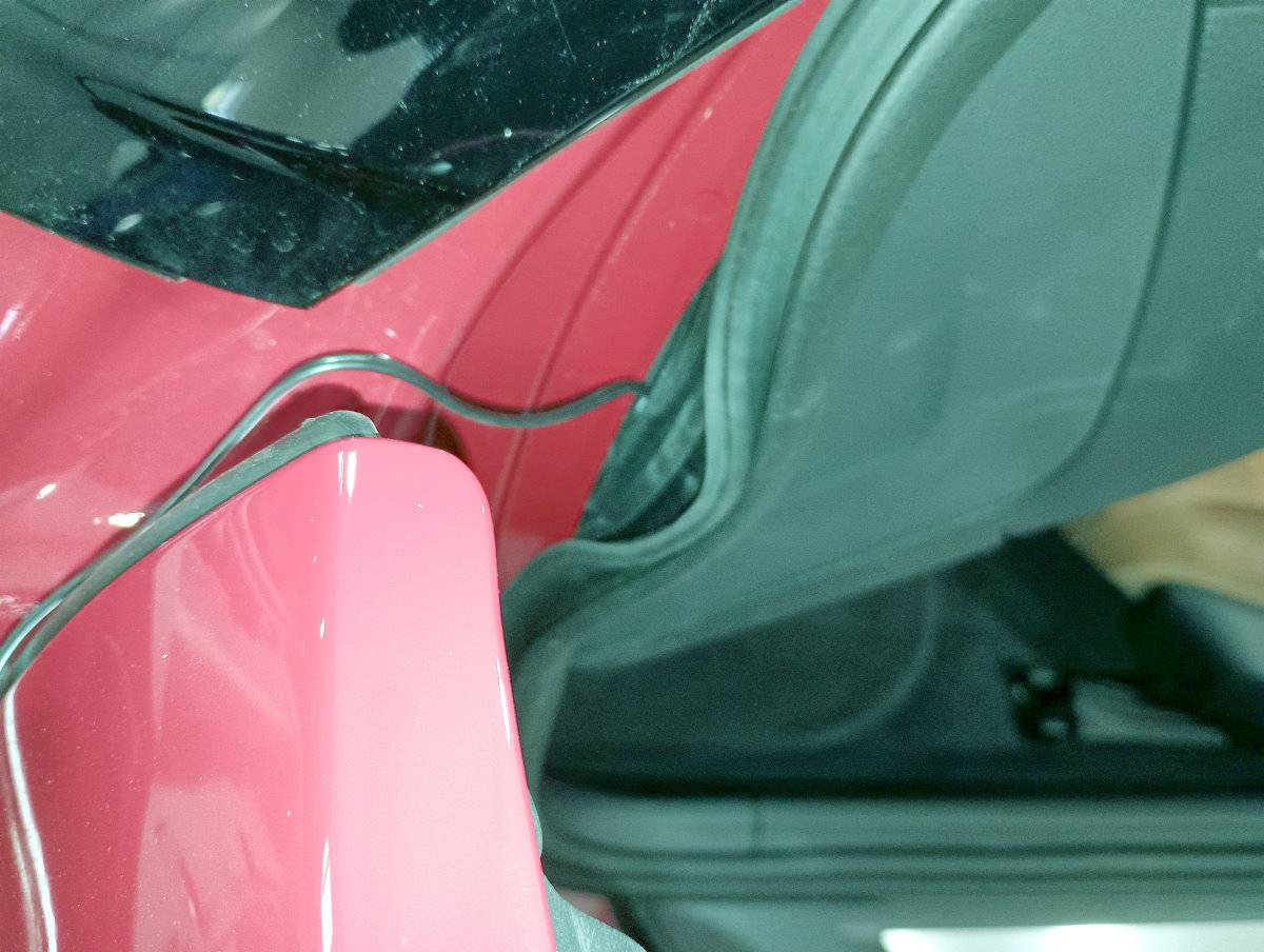

How do you route the cable for the OBD2 port with a manual? There's a hose for the clutch slave where you would normally run it through.
I just did it behind the door lol. There's enough room not to pinch
I did this too. I know you can wiggle your way through the firewall with the line there but I realized if I wanted to remove it would be a pain too.

So I reached to Burger Motorsports and Terry recommended the door route as well. He sent me some pics. I personally don't like the looks of it but I guess that's the simplest option.
Yep, unless it really bothers you. It is the best way on MTs.
Could you please send me those pics or post them here? I've got a jb4 waiting to be installed
