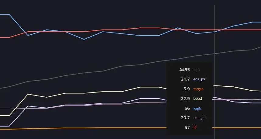

In case you've ever heard of JB4 blown turbo "Map 3" stories. Here's one I caught before it's blown:
https://datazap.me/u/coloneladama/log-1732311747?log=0&data=1-2-3-4-8-15-20
Catless + Jb4 without wastegate tuning is already a big NO.
Going to the most aggressive map that's not intended for 6 port cars with way too high JB4 WGDC? 28 psi and a turbo that won't be happy too much longer.
I don't run higher than ~24psi on stock turbo, and that is usually with meth injection.

I think this might be a special case where the igntion timing was absolute shit and skyrocketed the EGTs. Granted, this was due to more boost than the fuel could handle in the first place... but fixing duty biases would have only minorly helped.
Agree with you, the ignition timing in that log is absolutely ass. The EGT's must be insane.
Also, 28 psi with 14.4 AFR is crazy town. Cylinder temp with that timing and AFR has to be bonkers.

right, my guess is that "map 3" isn't what kills stock turbos. it's people that run it without looking at a single log, creating crazy knock that pulls timing, which then burns up the turbine. the boost level itself is likely fine for the turbo, as long as everything else is fine.
