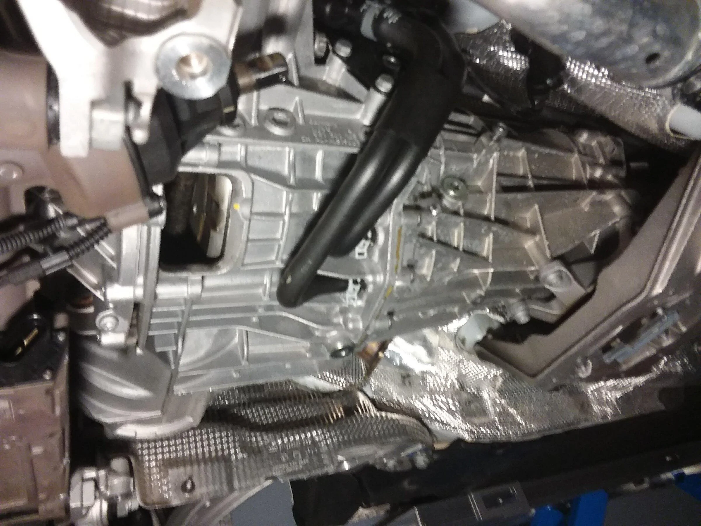

I’ll leave this here

not going to lie, I'm disappointed they kept the shitty squished metal bracing tube.
