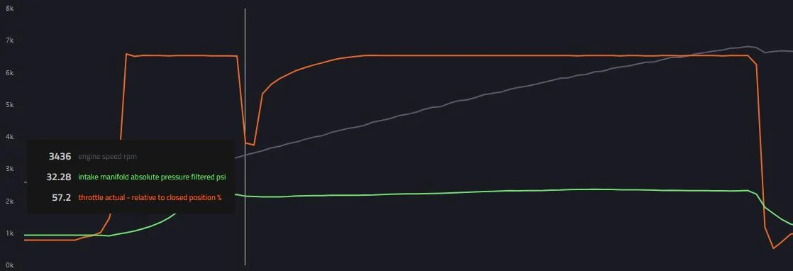

I don't feel the drop in throttle which is weird too.
8,828
17,320
@afree

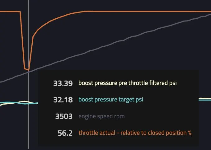

Throttle is closing to regulate boost as you are going over target boost. This isn't bad but custom tune could help now that you are changing hardware. FYI, OEM tune does this A LOT more, throttle is used to help regulate boost.

IAT doesn't close throttle. It reduces timing + load target.
Main thing that triggers throttle closure is going over target boost and load.
Ah i see. Though it was a combination of the of the 2. Assumed it had to do with temps since he noticed it after the intake install.

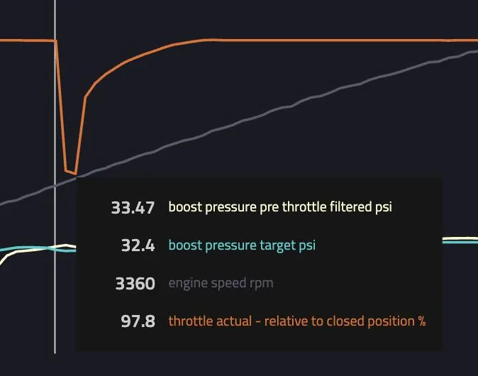

This makes a lot of sense. I did notice it was going over target (which I thought was a good thing with the new intake over stock) but didn't think it triggered anything to regulate it or when it would kick in depending on how over target it is. Thanks!

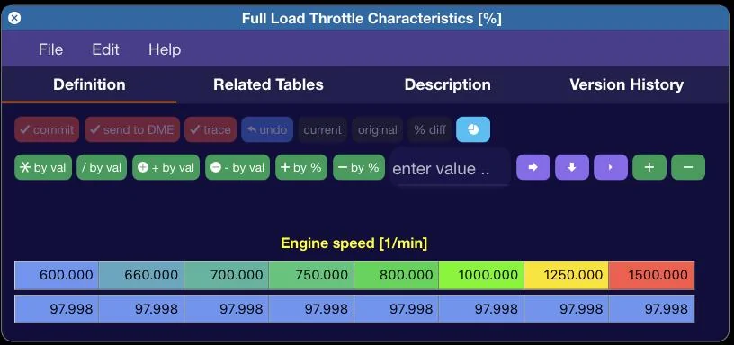

Is the 98% throttle throughout the rest of the range also regulating boost (should be 100% for full throttle I would think)?
8,828
17,320
98 is full open throttle as commanded by the DME. It will be this max unless your tuner changes this table. I have seen no difference between 98-100.
