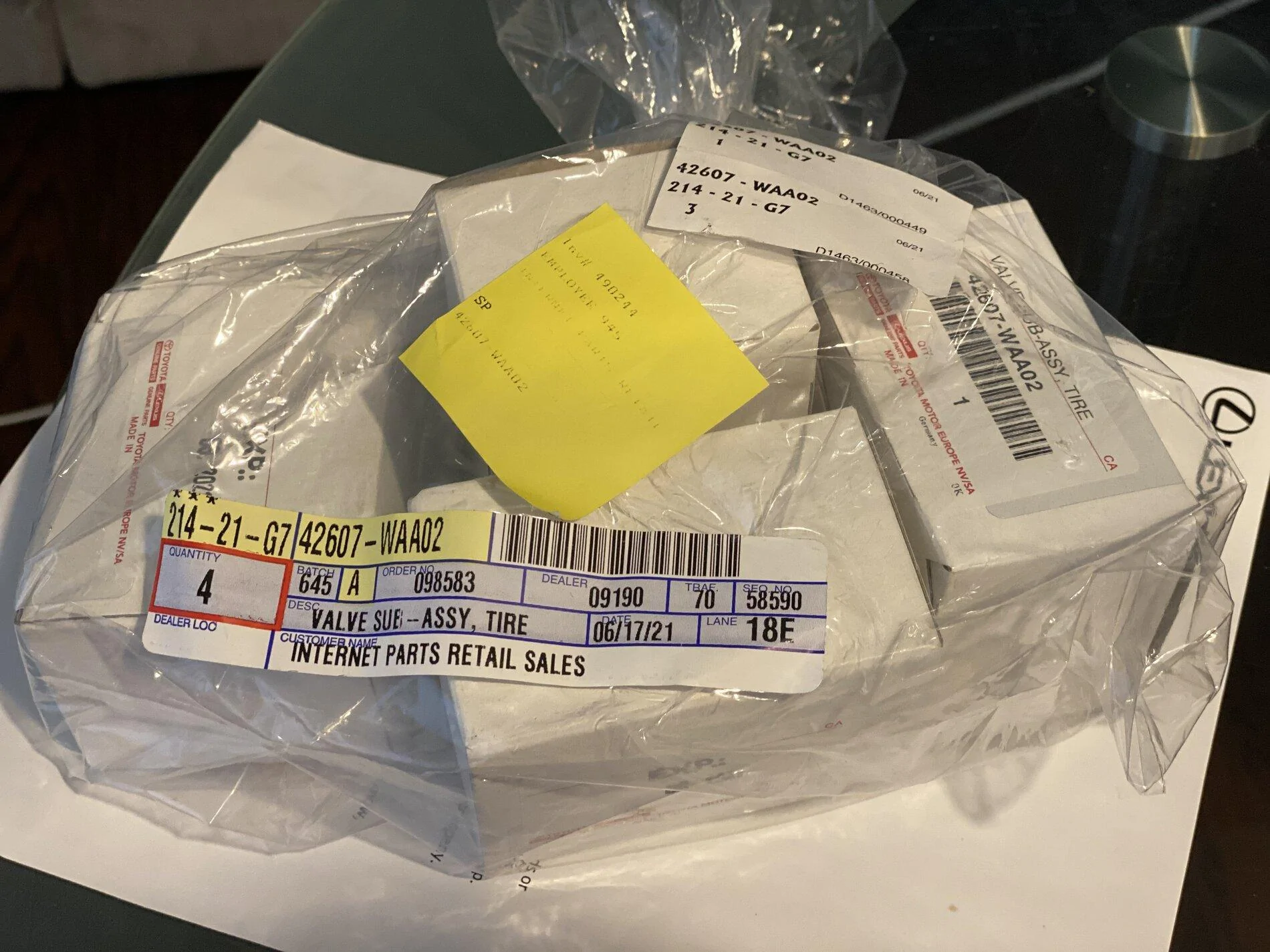

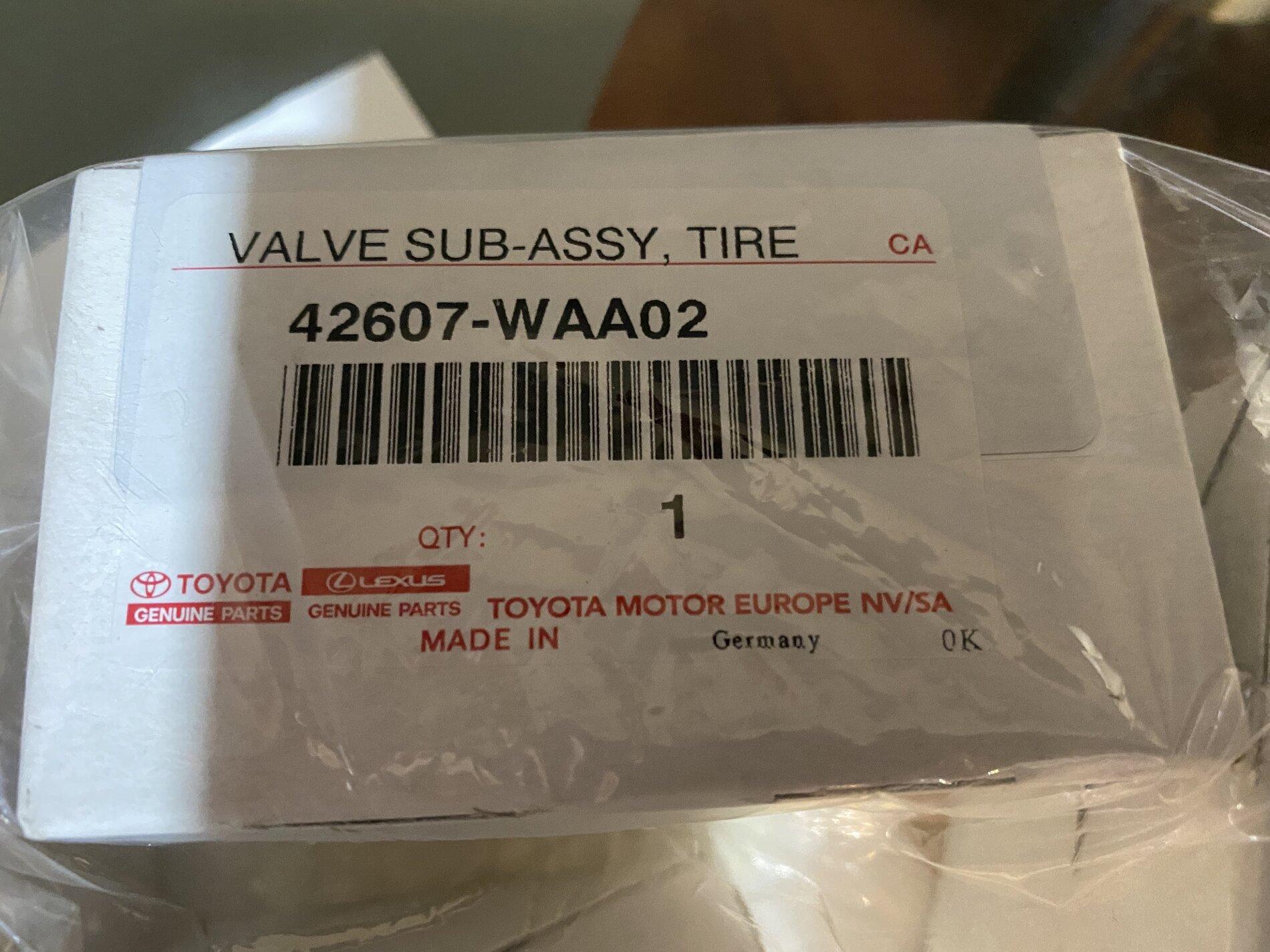

wa01 or wa02 they both work same.
My dealership says otherwise. lol
They only show wa02 working for my 2020. I donā€™t want to go to the trouble finding out affer the tires are mounted
02 is 433 mhz, I think but am not sure and could be wrong that the 01 is possibly 315 mhz? Not sure if car can read both.
