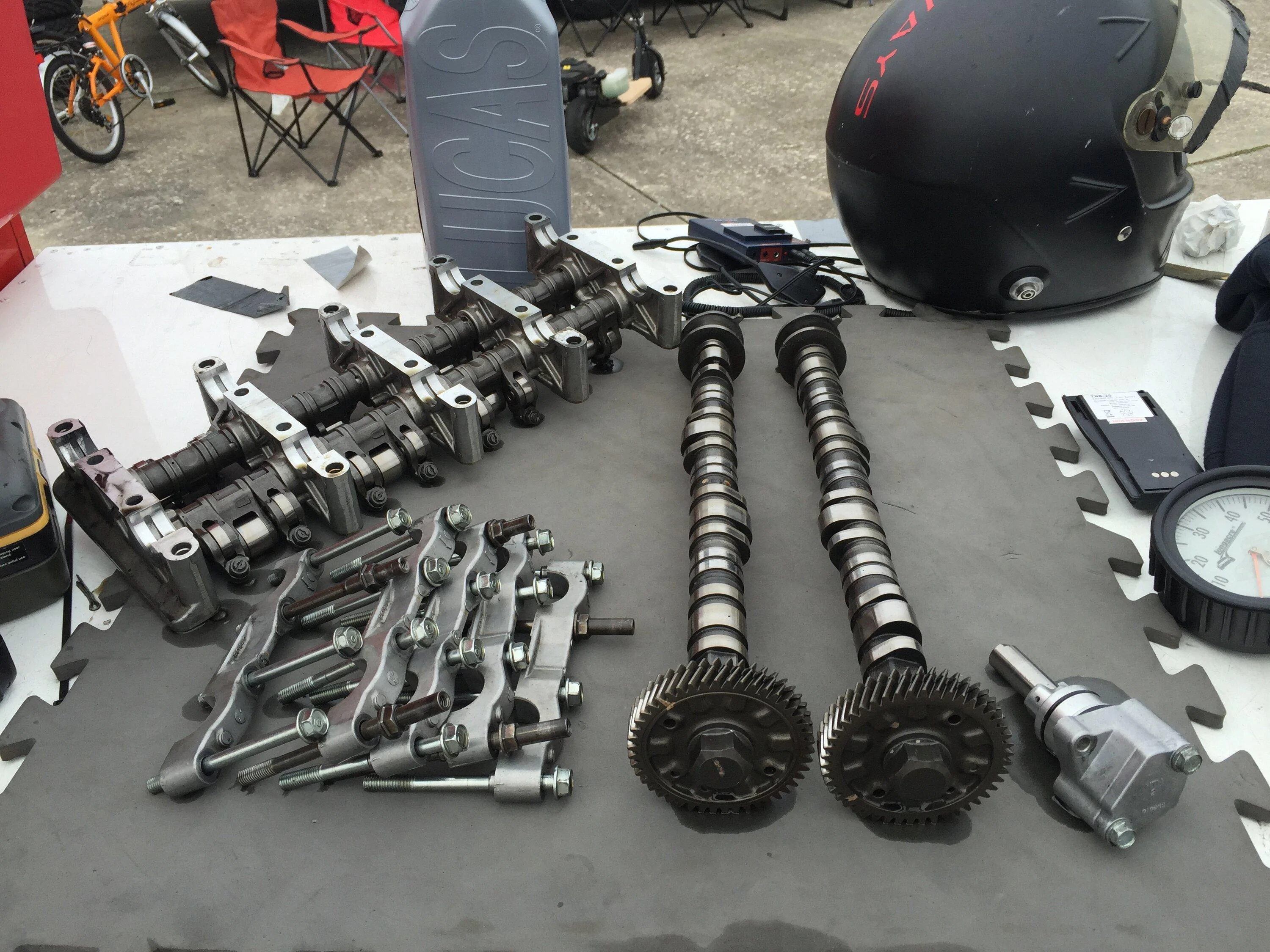

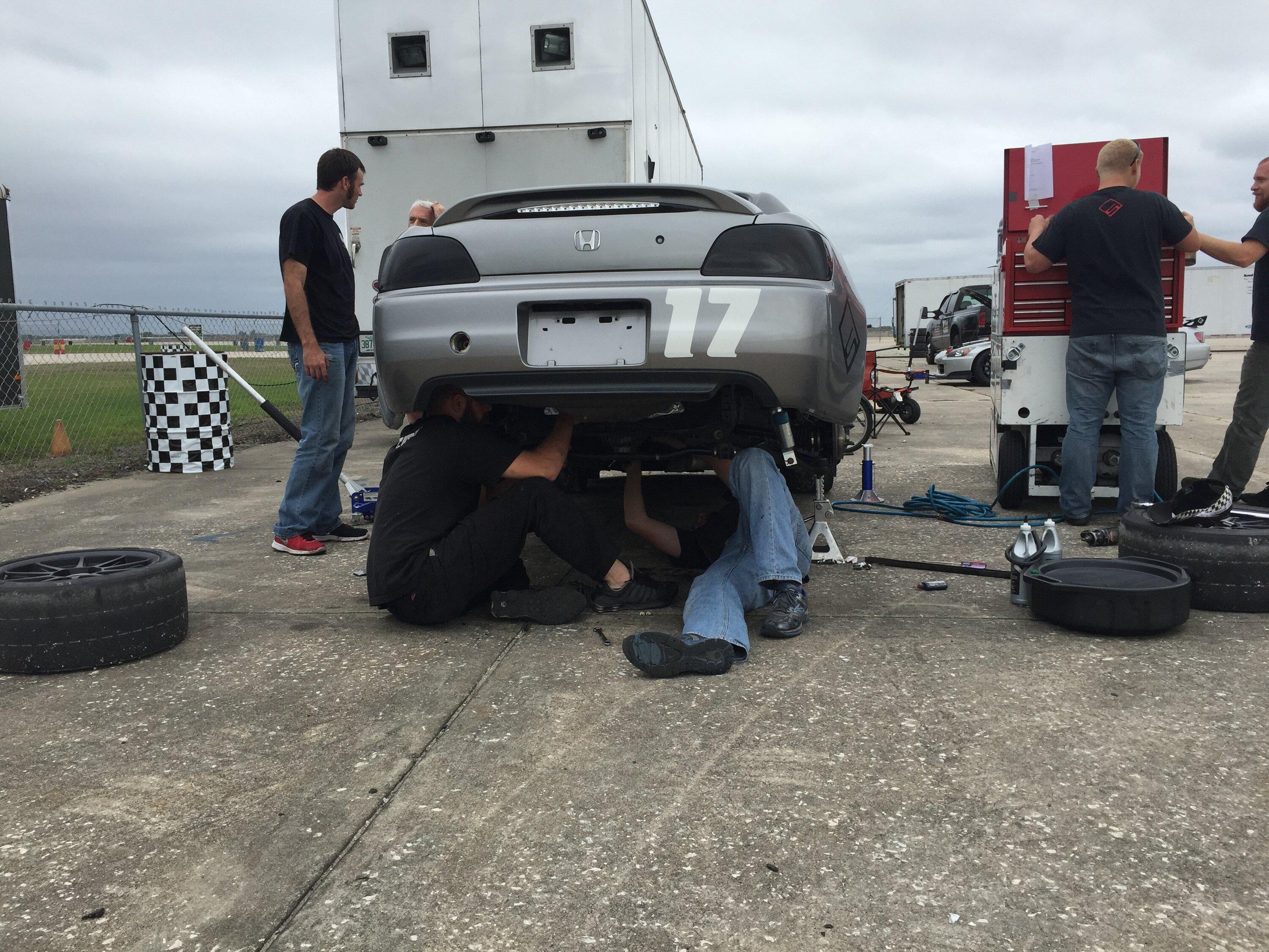

We’d drive the shit out of our cars and I never thought twice about the details. These guys were racing anyways (Sick Sideways) and I’d piggyback off their hard work, success and knowledge. Does your shop do something similar or race at Sebring? It was nice to continually ā€œdial inā€ the car. If I couldn’t describe something that was ā€œoffā€ well enough, one of the pro drivers could just hop in real quick and tell the team which part and exact location of the thing that needed replacing or attention.
Hence where I’m at now. I’ve taken time off from the sport when the team dissolved. Getting back into it now, realize how much knowledge and detail goes into continually pounding the pavement. Sounds like MCS & JRZ are a good coilover for my lack of mechanical knowledge and computer sensor stuff. And buying from Jackie PHD would have some racing input/help.
