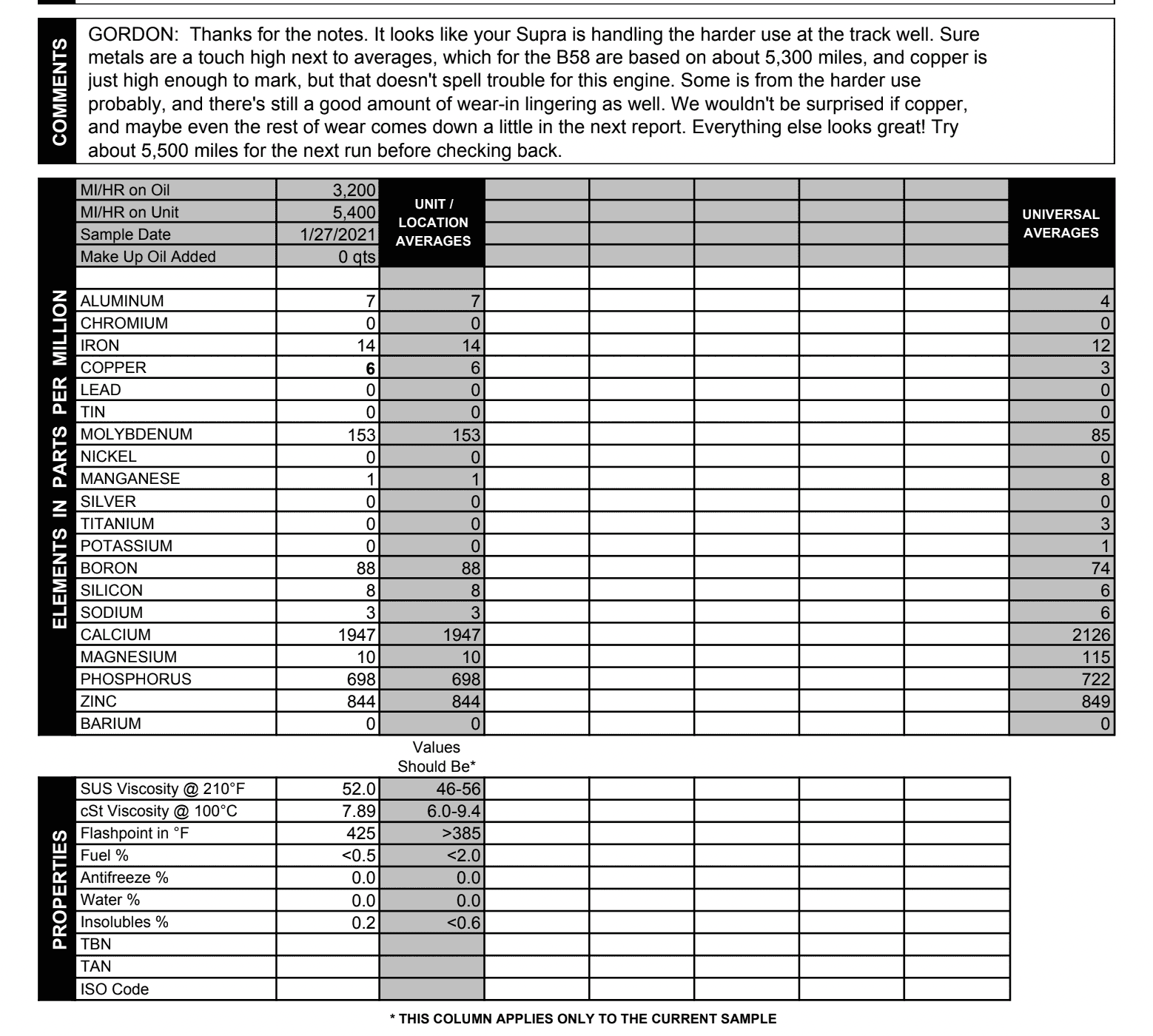

Here's my latest Blackstone Oil Analysis report.
On this oil I have gone to 4 HPDE events (1 event over 100F, others were pretty cool 60-70F). I don't daily the car; the miles are to/from events and backroads.
This is the GR 0w20 oil - this sample was collected on my 2nd ToyotaCare service.
My car did not burn any oil as indicated by the infotainment during this interval.
Transmission and diff...probably would do it annually. I did my diff once already with Motul gear oil (OEM viscosity).
Brake fluid is Castrol SRF - held up fine for 3 events so far - haven't found a need to bleed.
The tracks my car has seen are Sonoma (PB 1:53) and Laguna (PB 1:41) if it helps for perspective on use.
Overall car's been darn good on track. Even at 100F day oil temps peaked ~254F, which is totally fine. The viscosity of the oil tested gives me good confidence in the oil and the car's cooling system for my needs.
