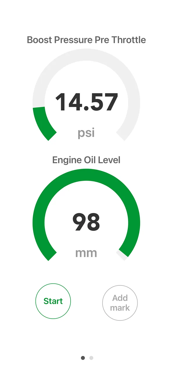

Most do 5K miles or a year interval. Just make sure to check the oil with an OBD app around 3K miles as these engines lose some oil. Don’t go by the iDrive digital dipstick.

Is this the Bimmerlink app?
I feel new to this, cause I just go off of the cars oil check setting. Just hate that you have to drive atleast 30min or so to check the oil.

BimmerLink, OBDLink, Ecutek and most bluetooth apps that connect to the OBD port.
