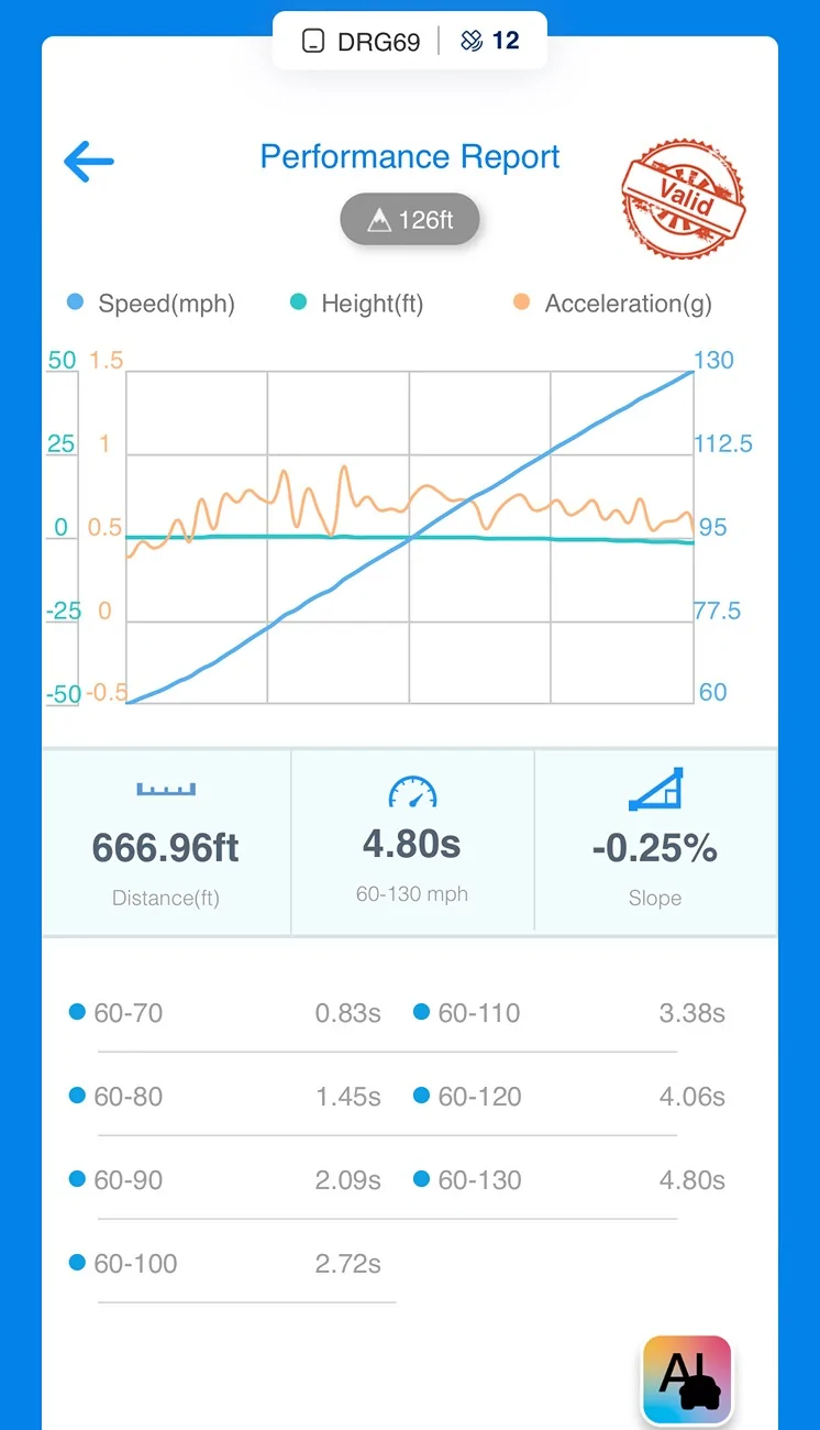

Hi,
i have a 2020 supra, ets 7275, pure stage 2.
currently pushing 45psi of boost.
rears are 305/45r17 mickeys ss on 20psi warm. Spins 4th with or without rolling antilag.
will et street r make a difference on the street? Any other tips?
stock springs, stock height
4.8 60-130 spinning 4th

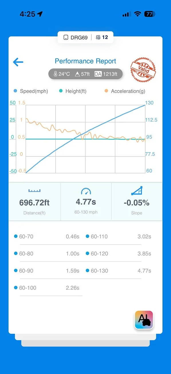

Hello from Doha, I think we raced during the roll races event in QRC.
I have a 2023 Supra, Doc Race 6870, Spool Stage 2, Dual Pumps w/ return line, ID1050. I am lowered on springs, dif mount and ET-R tires on 20psi.
