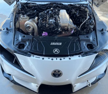

have been running docrace top mount on our care since 2019. no issues. have made as little as 500whp to as much as 900whp on our mustang dyno. will be pushing to 1000whp shortly. just haven't had a chance to put back on dyno. weren't anywhere from 4psi to 45psi
Which turbo did you go with on the DR setup?

Borg Warner EFR9280

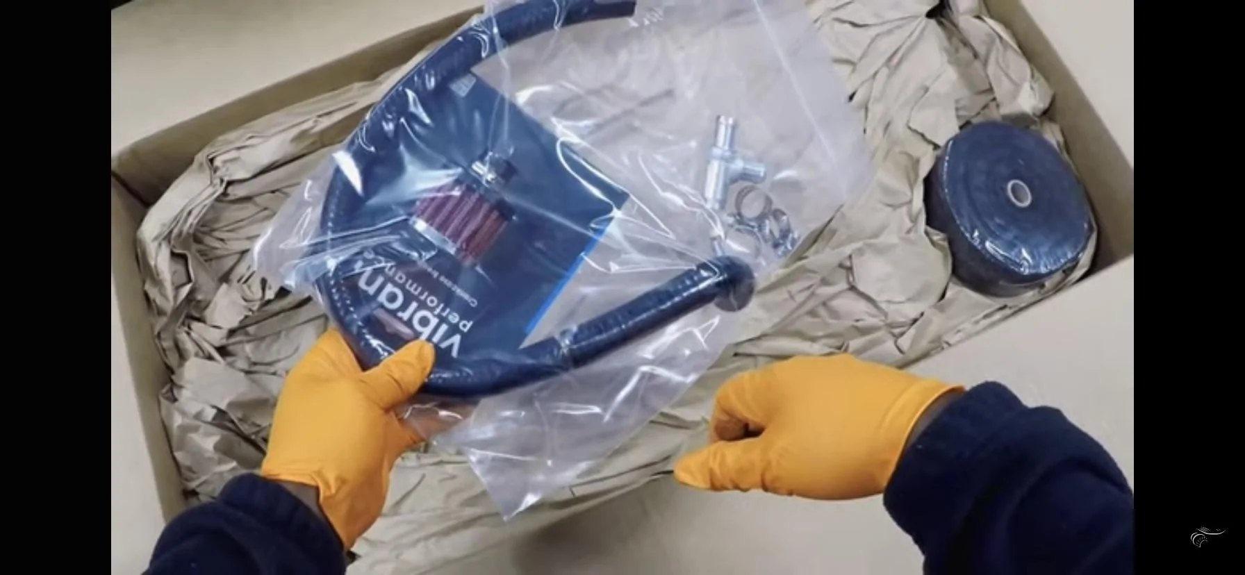

So I have the same kit and am missing a few pieces. I reached out to Doc race but no reply. I found this someone else posted of there kit. Where can I buy these fittings ?
which fittings? did you email or DM?
