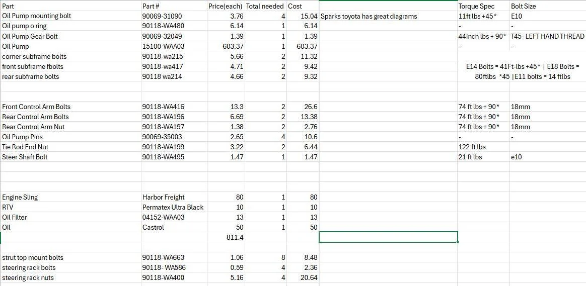

Watched this a few days ago
Im actually subbed to you and watched this the other day. Actually doesnt look like a bad job at all. I have a 2020 and it does fail at 18% but after i let it chill for like 30min and run the test again it always completes . So idk what to think. I may change it out if im bored enough.
I do have a quick favor tho. Could you list all the 1 time use stuff with part #s so in the future ill know what to order?
Not sure if it is the video but I went ahead and made a list since I plan to attack this myself in the fall when it cools off. I went through parts diagrams on this. If you remove any suspension bolts they are 1x use too. I am planning on dropping the subframe and leaving the suspension in the car as much as possible. This is probably more work and time but I plan on tackling this in my garage on quick jacks and I want to limit the amount of weight on the subframe.
